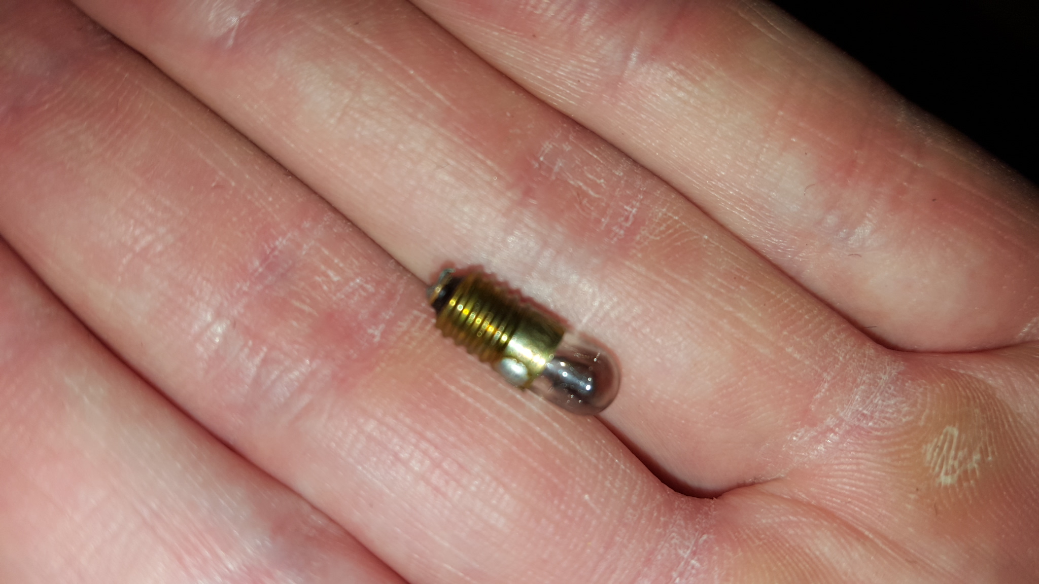

Can anyone tell me where to get these tiny bulbs that light up the Fuel Switch / Heated Window and Map / Interior buttons? I've attempted to order twice now and the bulbs hat I thought were right are too big.

Old Apr 19, 2017 | 06:07 PM
  #38
Jose's Avatar
Posts: 9,137
Likes: 2,659
try a NAPA store, or SNG Barrat USA
Old Apr 19, 2017 | 06:45 PM
  #39
Chipster55's Avatar
Joined: Apr 2017
Posts: 60
From: Fairfax VA
I'll take a look this weekend but no luck online so far.
Old Apr 20, 2017 | 09:09 AM
  #40
Chipster55's Avatar
Joined: Apr 2017
Posts: 60
From: Fairfax VA
I think I found them. Llb280 bulbs.
