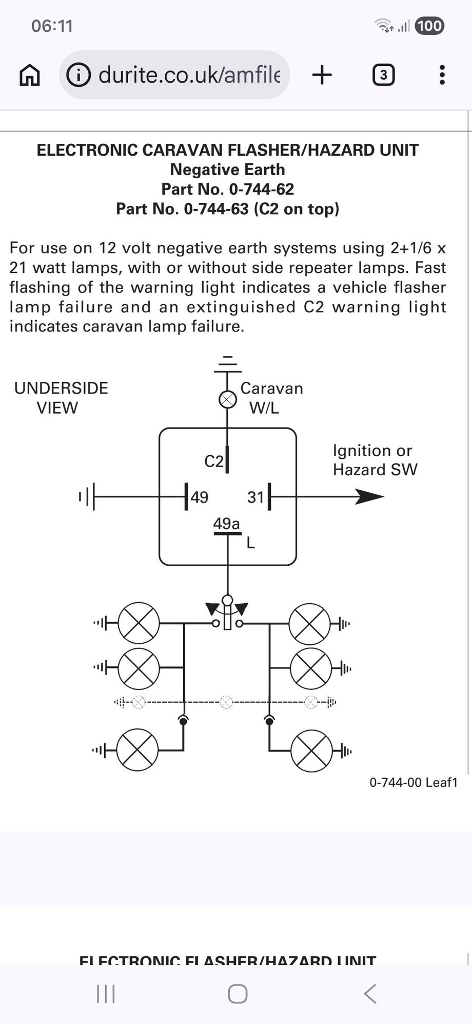

I came across this diagram on website durite.co.uk from a company making multiple different flasher units:
The text states that the caravam warning lamp on C2 will extinguish if a caravan lamp fails. So if a flasher unit of this type is being used in one of our cars without a caravan or trailer added, the warning lamps will not function. The flasher unit must somehow detect the total resistance of the set of lamps in use.
I am wondering if it is, after all, a flasher unit problem in these problem cases.

Old Apr 6, 2026 | 06:41 PM
  #32
Andy T.'s Avatar
Joined: Jun 2019
Posts: 283
Likes: 265
From: Khon Kaen, Thailand
If you tow a trailer or caravan, you need to add more lamps. In that diagram from the website, below the dotted line they show left and right lamps for the caravan or trailer.
ok, thanks for.the info and the illustration. I'm going to source a new flasher relay to see if it is the problem.
