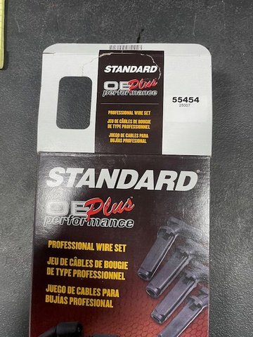

For wires I used Standard Motor Products #55454. These seem like decent wires, fit well, and were labeled with cylinder numbers. Less than $40 delivered from Rock Auto.
I know some will argue the wisdom of using lower cost plug wires. The faulty wires were a lower cost set purchased off Ebay for about $50 as I recall.
Many tout Magnacore wires as the way to go. I cannot deny that they are very high grade. But also very expensive, about $180 last time I checked. Personally I'm not sure if the cost-versus-longevity is worth it but that's s decision each of us makes on our own.
