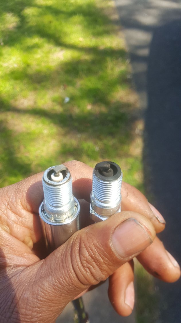

Ok! I hear you, Grant... Will do. I'll get the FI cleaner on my run for the plug,,, it's the hard driving that might be a problem. Very few open roads like that around here even up here in Connecticut on 95. Maybe I'll drop it into 2 and get the engine spinning. Not my usual. I'm a Sunday driver.
Here is the offending plug. Note,,, I cleaned this thing up x2 in as many days. Then, cleaned it just before I took this short drive and took this picture... Over fueling on this one cylinder??? The FI are new-ish reconns that I only installed last year!?!?!
shooot!!!!

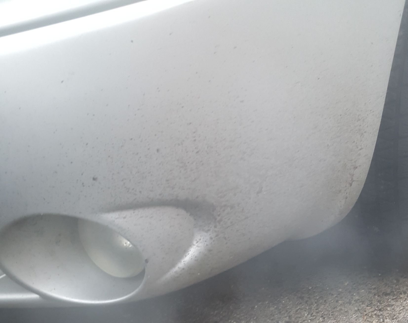

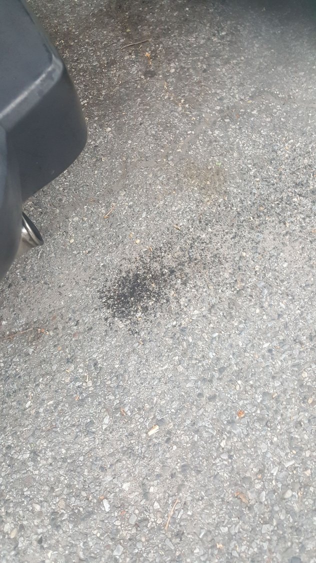

Today it's like this!
But,,, new plugs ordered (I remember we talked about this, Grant. Thank ya!

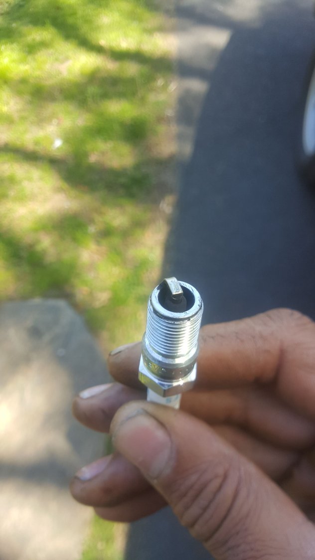

So, I pulled the new plug just ta SEE,
This is it compared to the other in spot 2 in the B bank.
Then, a shot of the new plug barely rubbed with my finger. The soot easily wiped right off. Wondering if it could just be covered with the residual soot that is still pushed up into the cavity of the cylinder head...? I haven't driven more than a couple of miles with the new plug...
I've spied a "new" recon fuel injector on Rock Auto,,, with a short hose included. Just hope (if I do need it) the hose would come the same length as the other 10, or 5 on that side. The 6th being the long hose that wouldn't matter.
New plug... Soot wipes off super easy to clean metal. None of these plugs are more than 2 months old.

I expect that the coils and distributor can and will do good things for the over all.
This is what I'm seeing out of the tail pipe on the LH side with sputtering and a a miss... Poor neighbor...
After 30 seconds of running at start up this AM.
The car behind me... Lol,,, I cleaned it up - I swear.
