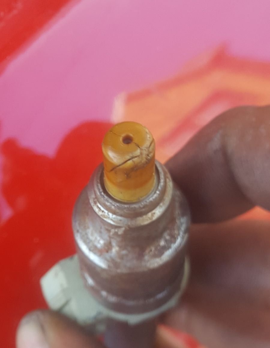

20min later...
Does THAT matter?
I guess it will.
I tested it on the car. It wasn't dripping.
But put the new one in and the exhaust note is clean.
No girggling and sputtering.
Seems like I tested y'all's patience on this one.
I apologise.

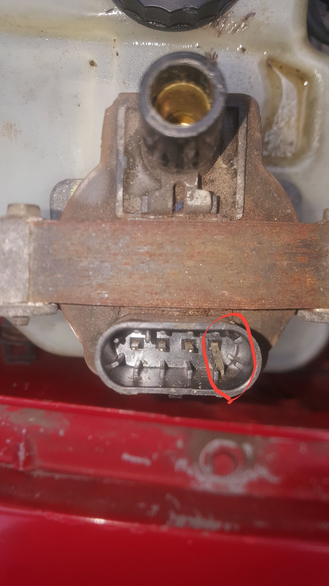

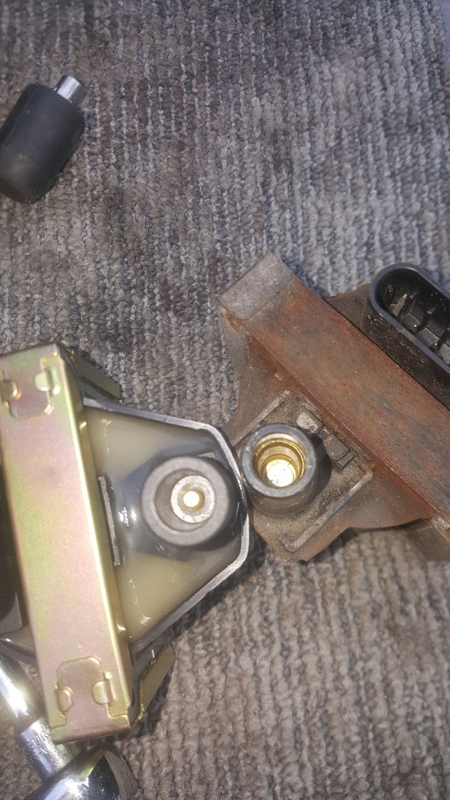

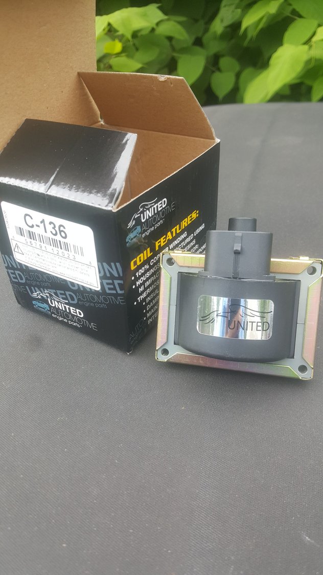

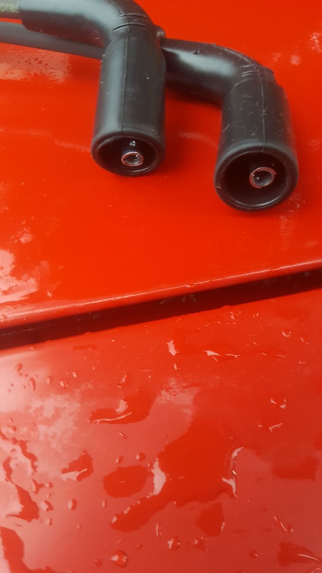

Default Coils, Diz and COIL WIRE
Houston - We Have a Problem...
Different style connectors and
Will this cause a problem?
Different style plugs from old to new. Anyone have a name for this plug style and,,, can they be gotten with the more traditional plug style on one end and the pin style in the other?

Old Jun 2, 2020 | 06:25 PM
  #36
orangeblossom's Avatar
Joined: Feb 2013
Posts: 17,809
Likes: 3,945
Hi Jay
If it doesn't fit your Car I'd send it back and get one that does from British Parts
But is the Coil your Problem, as it could be the Loom as Greg was saying, as She seemed to be running ok until you stated moving the wires around the Air Con

Haha, OB... I guess that's what I get for multiple post go'n on at the same time. I guess it's the life I'm living...
This is a thread for a different problem I encountered and solved-ish (actually I did) on my FIRST 100mile plus drive. It turned out to be a shot fuel injector in 6A. So, just because none of this had been done, I ordered the fuel injector (Greg convinced me of the problem) and the rotor, dizzy and coils, too. Just swapping them in.
The coils fit, it's just a different style HT plug (I think I like better) on the coil end of the short HT coil to dizzy lead.
The stalling problem, (I couldn't get a good picture of it) that I had on my 2nd EVER 100 + mile trip I think I solved too. We'll see. I found a partly melted CPS or Fly wheel position sensor wire under the car. Touching the exhaust just after the downpipe on the LH side. I just couldn't get in or under there far enough to take a good picture or see it clearly. We'll see.

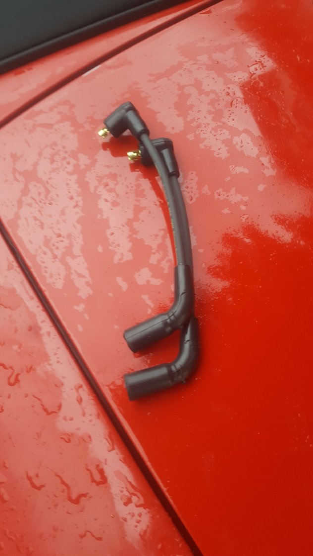

So I reached out to United Automotive Products and I can't believe... We talked a bit and the gentleman went to the RockAuto site and realized that they had been selling these coils marked as the part for Merelli replacements,,, not realizing that the pin/post style connection is not what the OE Merelli parts used. The more traditional barrel/cuff style with the contact on the outer circumference.
Anyways, the guy is making me up a new set of coil wires, custom, post style connection on the coil side and traditional style connection on the distributor side. Making them and shipping them, for FREE. I'll be doggone
One of my favorite parts (no pun intended) about working in these cars is all of the amazing interaction (this site included) I get to have with amazing and thoughtful people.

Just to add to my last post, the guy (Rick) that I talked to and straightened me out is the OWNER of the company... Amazing dude.
He went out and made the bits himself, packaged them, and sent them for free - overnight - with an apology note! Whaaaa? Unheard of. Got them from my shipping pick up spot today, installed them and DAMN! With the new plugs, cap and coils I have never heard or felt her run like this.
Still have to figure out that strange stall I experienced a few days back (I think it might be as simple as repairing the wire that looks melted on the bell CPS) and I'll be oft to the races again. I was just cruising around,,,, anyways.
A good day. I do wish the coil plugs were 8mm, tho. But hey.
What a great experience with these folks at United Motor Products...
Pin/Post style connectors

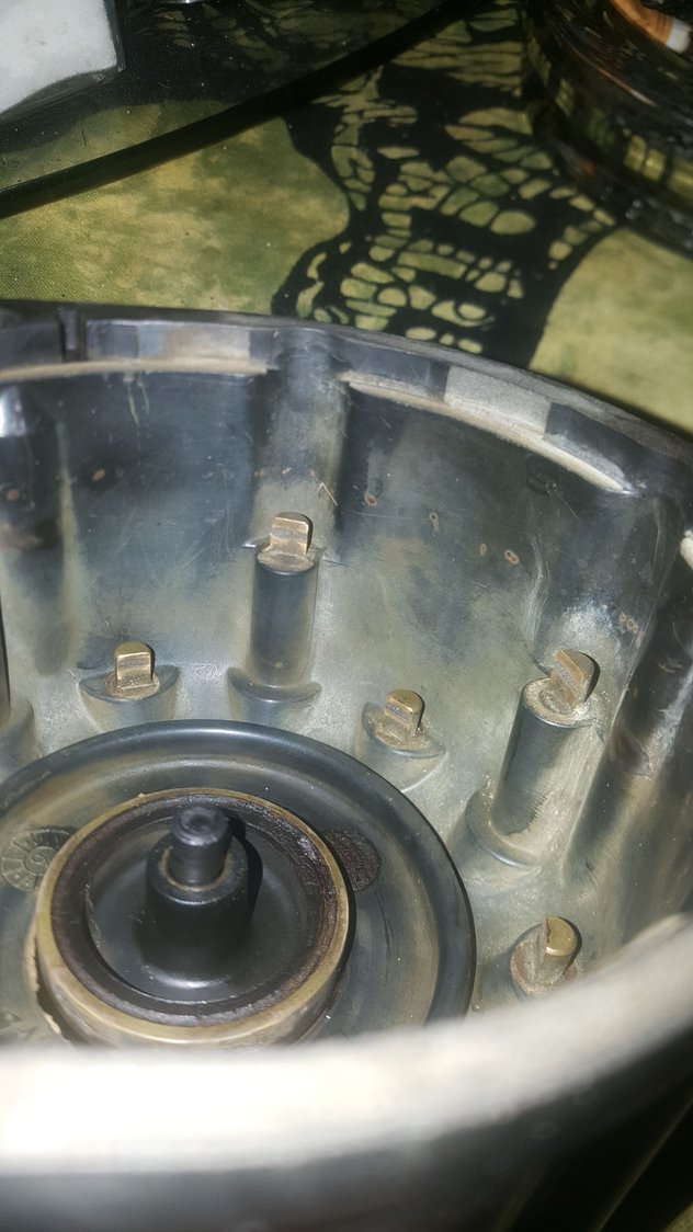

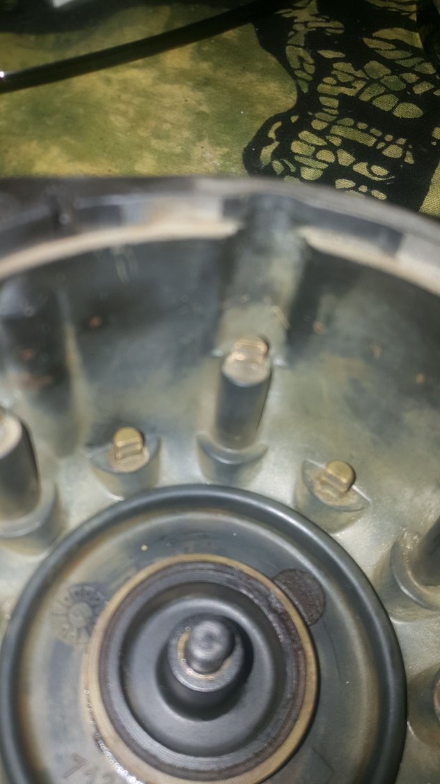

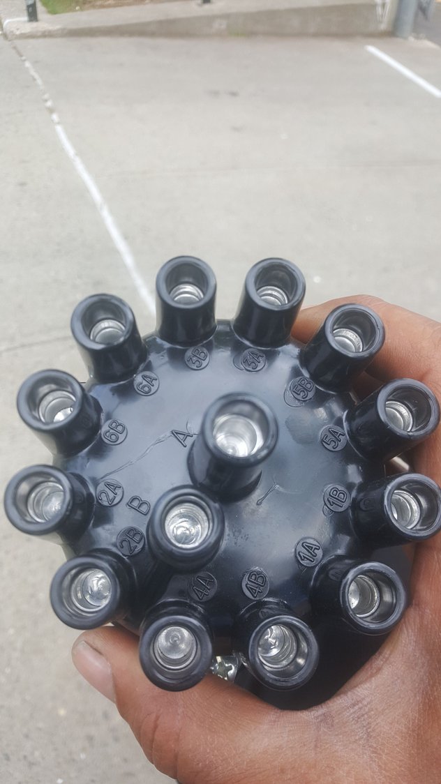

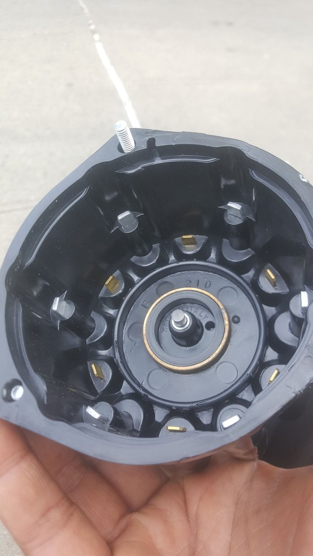

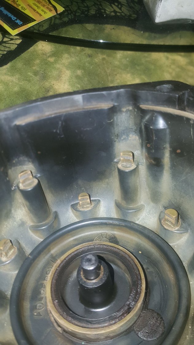

Some snaps of the old OE real deal Merelli distributor... I think about 40 to 50k miles. I have no real accurate way to know my milage. I'd have to go back to my posts from 2yrs ago to see if I reported milage on the original odometer, which wasn't functioning at the time.
Anyways, it don't look right. Looks like arcing points all over the place to my untrained eye... Is that what all of those little dots are all over the place? Have a big old scuff on the outside too,,,
Don't even know how she was running with the bent over coil plug. JJJ,,, the crack pot mechanic...lol...
I'm getting better. I think...
