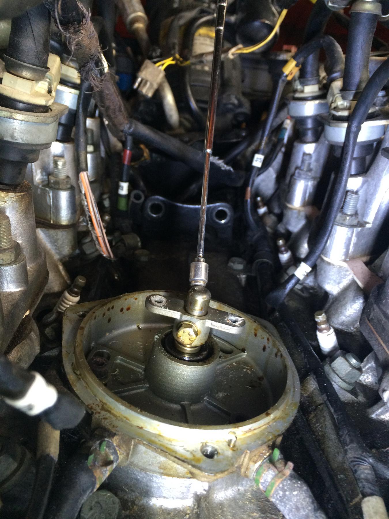

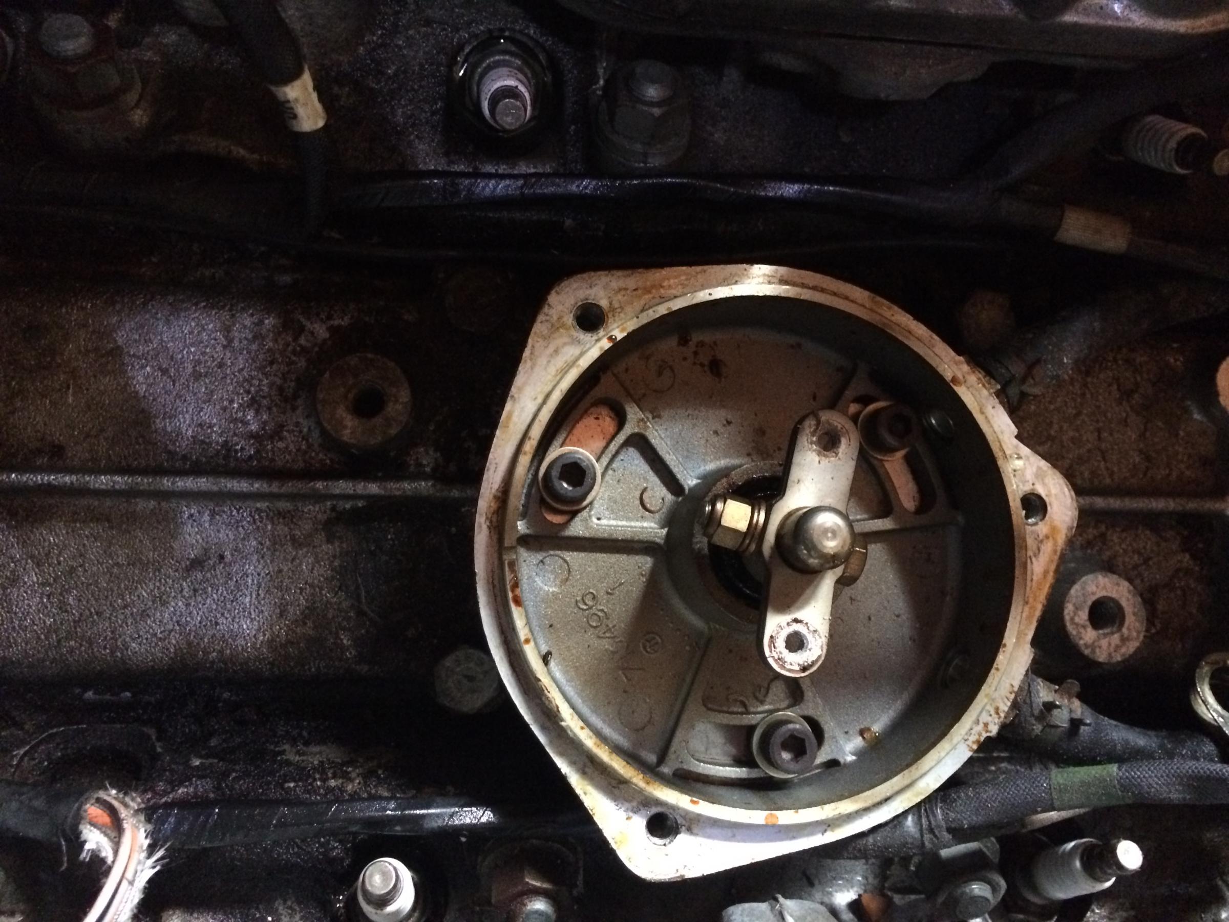

I have been reading about this and fear it so while I have a bunch of stuff apart I want to try to do it.
I took some pictures-
first one is distibutor cap with HT wires off.
second one is distributor cap off.
third one is with rotor off.
fourth one is with a magnet on what I believe to be the distributor shaft.

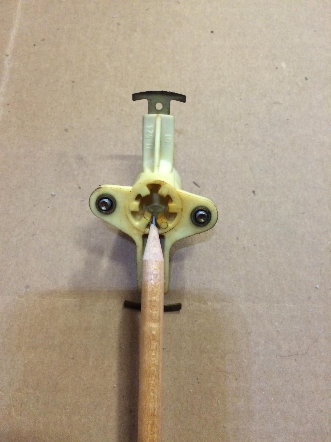

fifth one is the underside of the rotor
sixth one is a pencil pointing to what I believe is supposed to be filled with silicone.
So- basically you grind down the distributor shaft in picture 4 to level with the base that holds the allen screws that hold the distributor rotor on?
And then you fill the underside of the rotor in picture six with silicone?
and that's it right?

Old Nov 27, 2014 | 02:12 PM
Brake buster's Avatar
Posts: 821
Likes: 502
From: Gloucester UK
yep
u got it
don't forget a new gasket under the dizzy cap ,
BB

Great Info! with very useful pics and 'how to' instructions, please could you put some more pics up as you go through the process, for instance to show the method that you used for grinding down the Shaft.
As I for one did not think that grinding down the Shaft would be essential, although probably more desirable if you can do it.
Did you have any problems getting a New Gasket and Rotor, or come across any problems on the way?

It looks like you can cut the shaft to shorten it, but that gets me a little nervous. LOL... Grinding it may make a heck of a mess and I would not want any metal particles to get down into the distributor...
