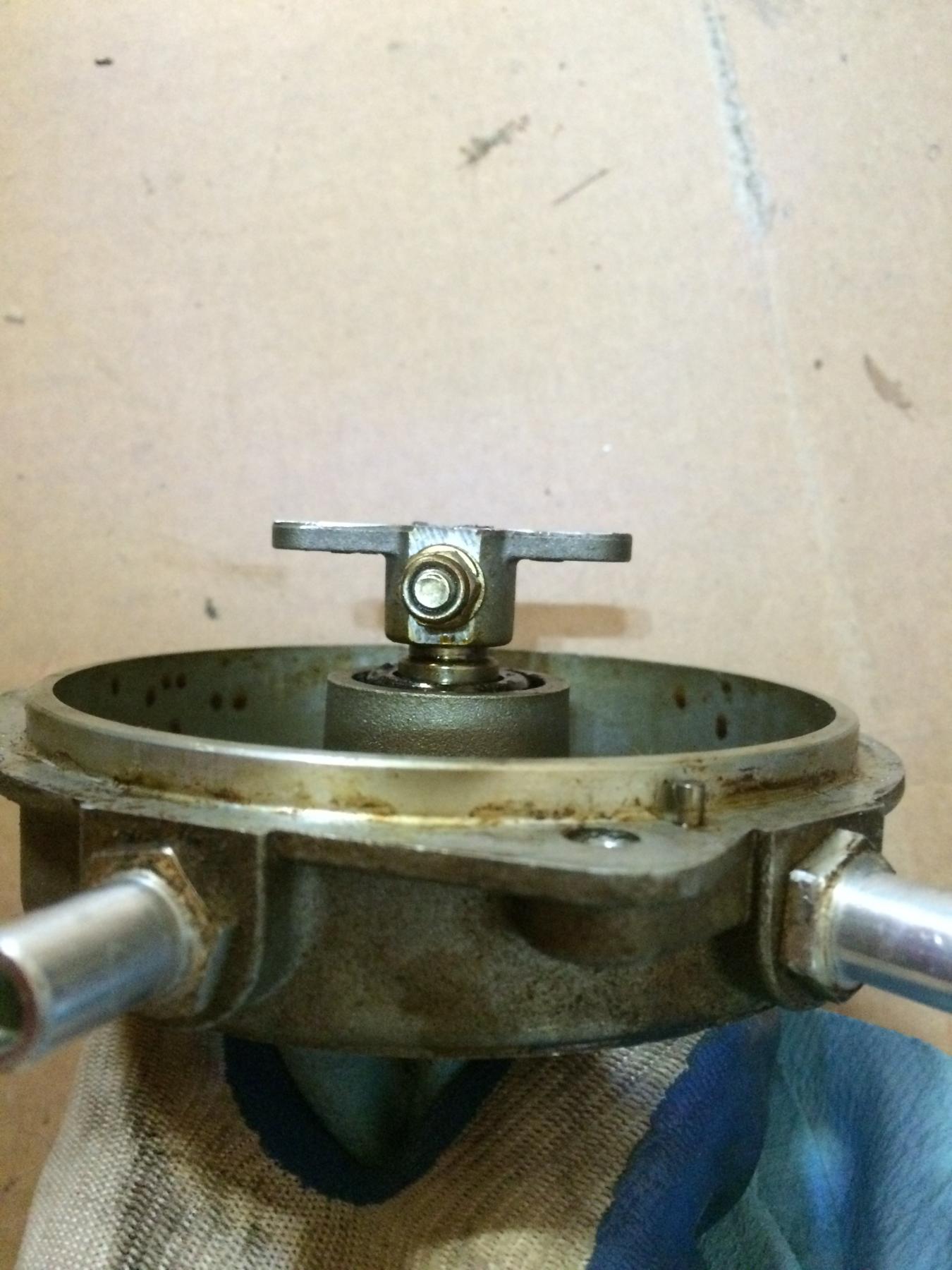

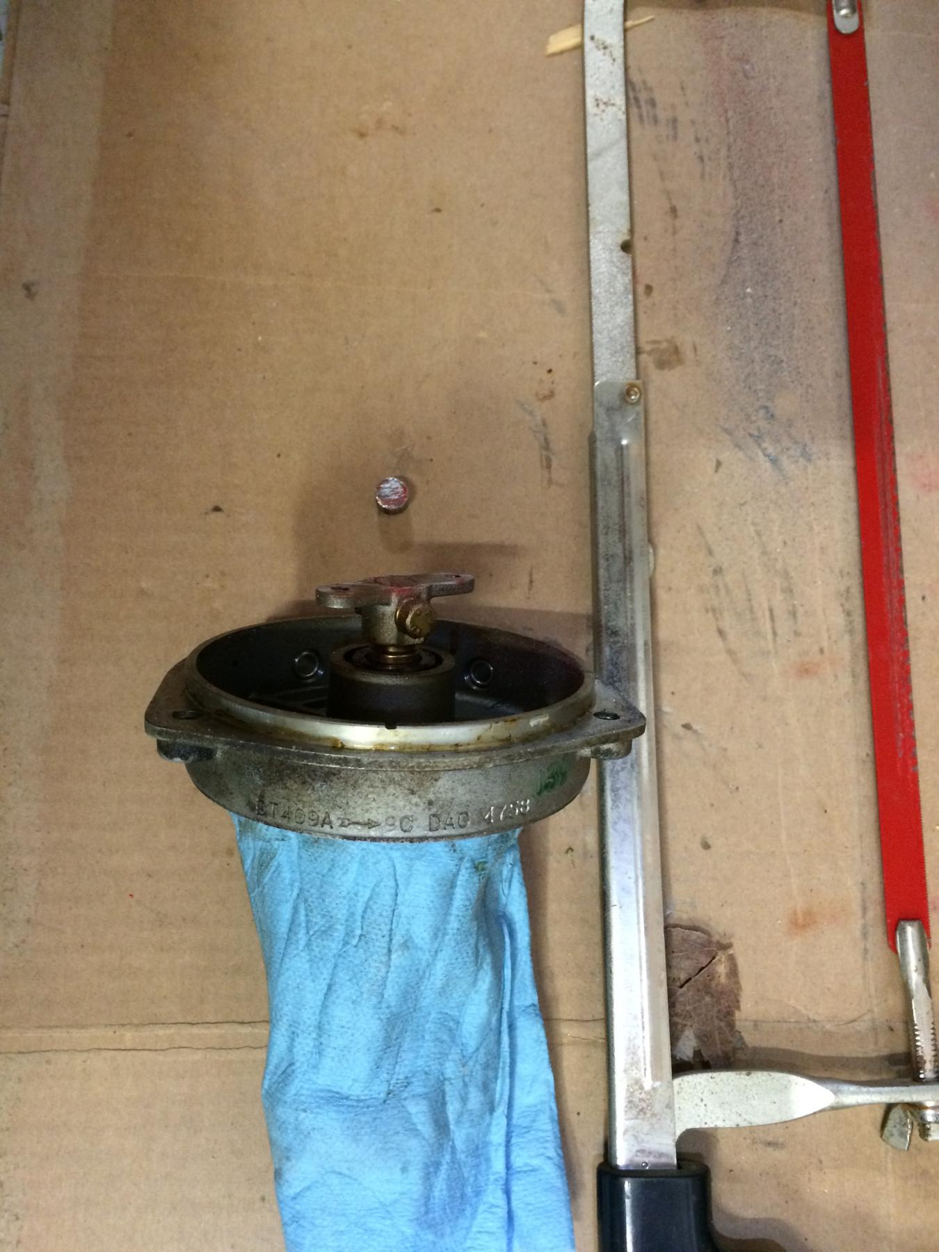

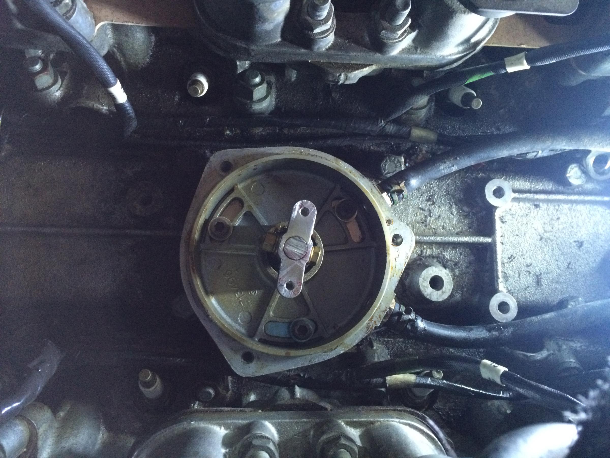

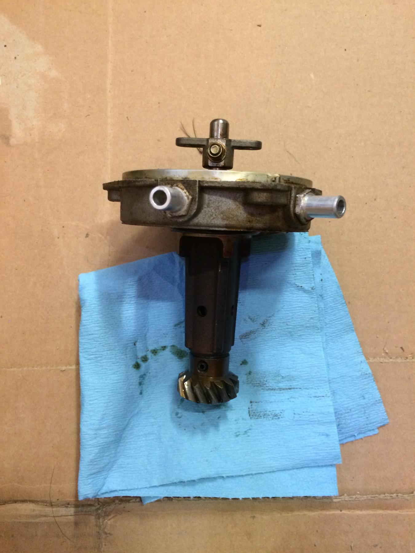

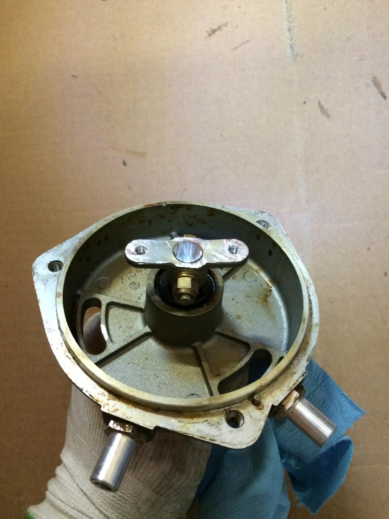

so- for better or worse I decided to go for it and hopefully I did it right.
I used a hack saw with a fine metal blade. I fear power tools and thought I would have a lot better control with a hand tool.
Whatever metal that nub was is pretty soft because it only took me a few minutes to cut it off.
Pictures included- and someone please tell me if this is all wrong so I can price a whole new part!
erik
Attached Thumbnails Marelli Distributor Fix To Prevent A Fire! XJS V12-img_0377.jpg   Marelli Distributor Fix To Prevent A Fire! XJS V12-img_0396.jpg   Marelli Distributor Fix To Prevent A Fire! XJS V12-img_0397.jpg   Marelli Distributor Fix To Prevent A Fire! XJS V12-img_0398.jpg   Marelli Distributor Fix To Prevent A Fire! XJS V12-img_0399.jpg

Is the shaft Aluminum?

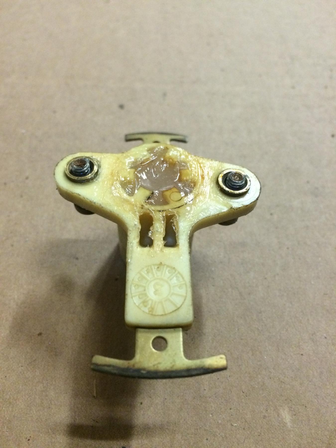

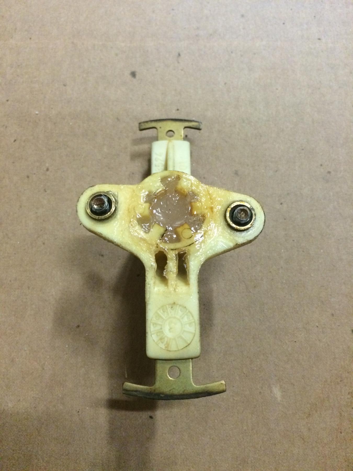

last part with pictures- this is the rotor with the silicone filling the asterisk area on the underside.
I ordered the gasket (and nice labeled HT lines too) from a vendor recommended on this site-
New and Used Jaguar Parts for XJ6, XJS, XJ8, XK8, S-TYPE and X-TYPE
ordered on the Nov 28, received it on Dec 1.
And again- please let me know if this is incorrect/ a train wreck waiting to happen/ a guaranteed fireball obituary coming and I will try to delete all of my posts.

I'm envious. Looks like you have doen a fine job!!

I was very Tempted to cut the Spindle off but I wouldn't trust that Rotor being held in place afterwards by just a couple of Screws, what good is that Silicone Sealant now, as it no longer has a shaft inside it.
Anyone else think the same?

I know it isn't the same car, but the only time my current TR6 let me down, was when it burned through the rotor, and started grounding to the center shaft. Cheap rotor button. I think the silicone is just added insurance, that the fire NEVER comes through the rotor button.
