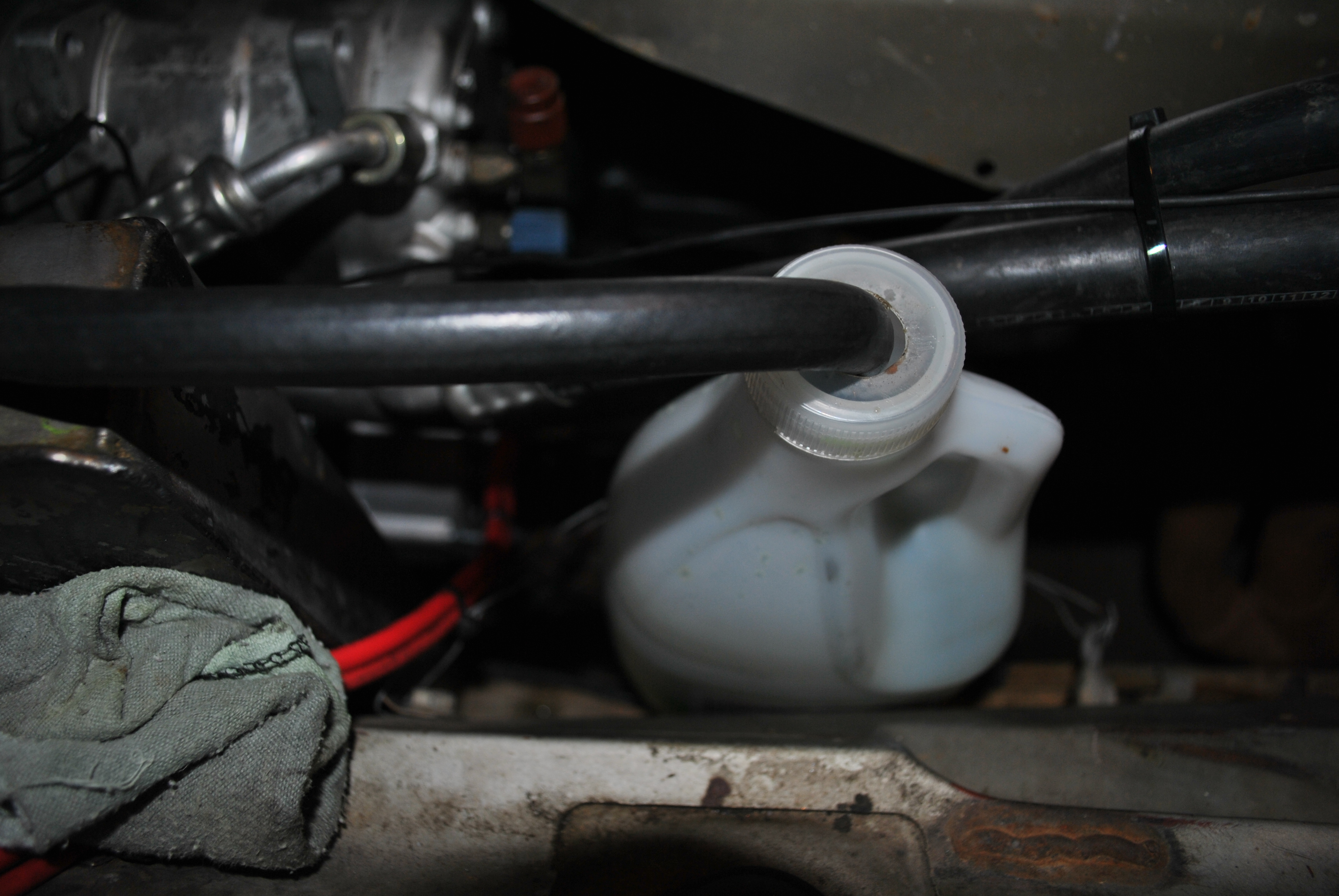

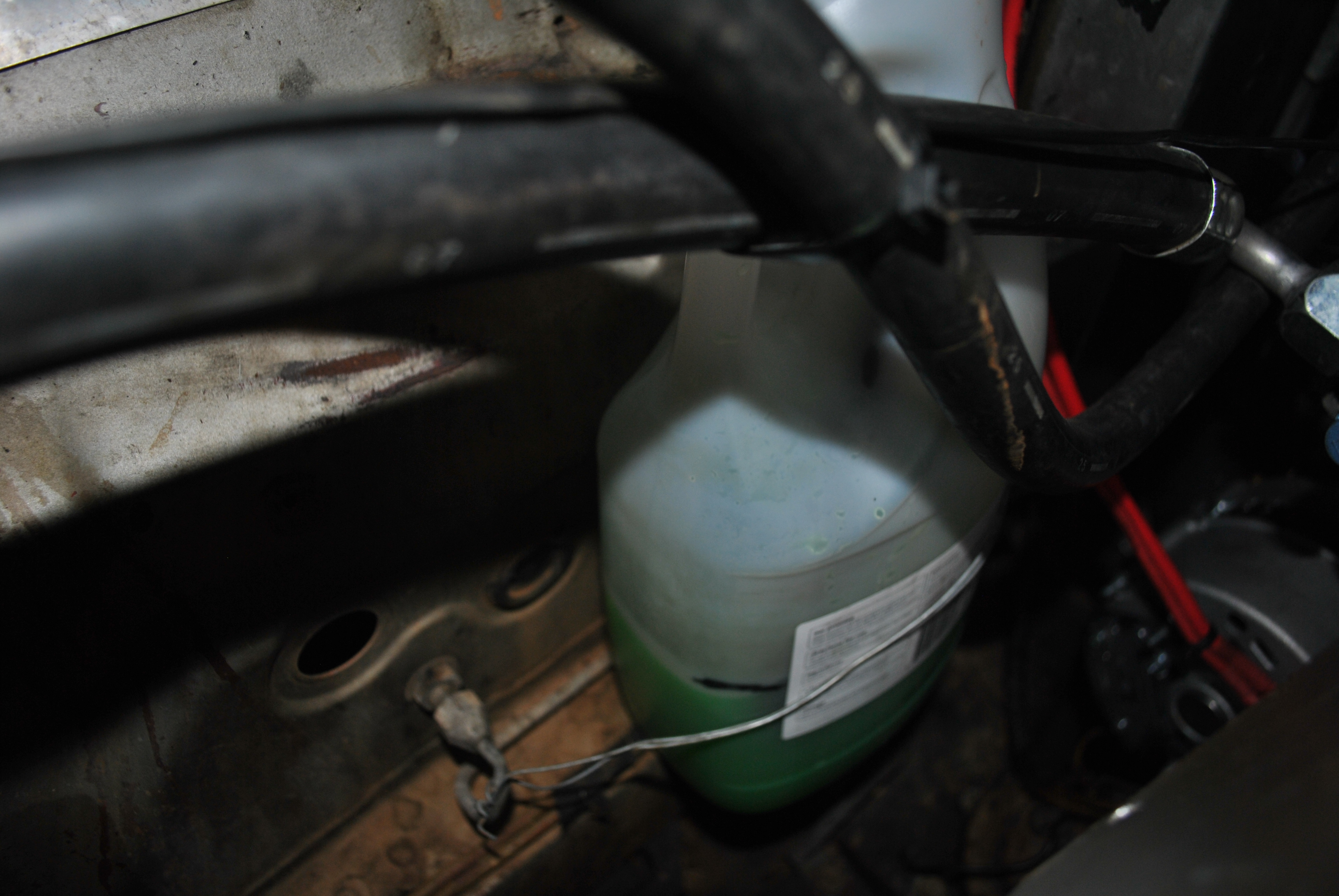

My XJ6 has been using(or losing) 200-500 mls of coolant a week. Not enough to cause problems, but enough for me to check it every few days. I have even driven it to Sydney(1000 km) without a concern.
Last weekend an old mechanic mate of mine I've known since we were 6, and not seen for the last seven years came over for a few coldies and ended staying the weekend and playing Jags & bikes in my garage. (none of the last paragraph is relevant of course)
Anyway over the course of two days I think he had a spanner on every nut and bolt on the car and found a lot of small things I have overlooked. We got to the cooling system and his first question was "how much coolant is she evaporating ?". My response was it uses a bit.
He said you have no cap on your overflow bottle from the expansion tank, in this climate you will losing a couple of hundred mls of coolant a week just from engine heat under the bonnet. So he made a cap with a hole big enough for the overflow hose and said see how that goes.
This past weekend I covered 1100km in 3 days and lost about a thimble of coolant. You can see from the pics I put a black mark on the overflow bottle on Saturday and checked today after the car had completely cooled and it had only dropped a gnats dick. And the filler tank level and the expansion tank level were normal.
Just another idea.
