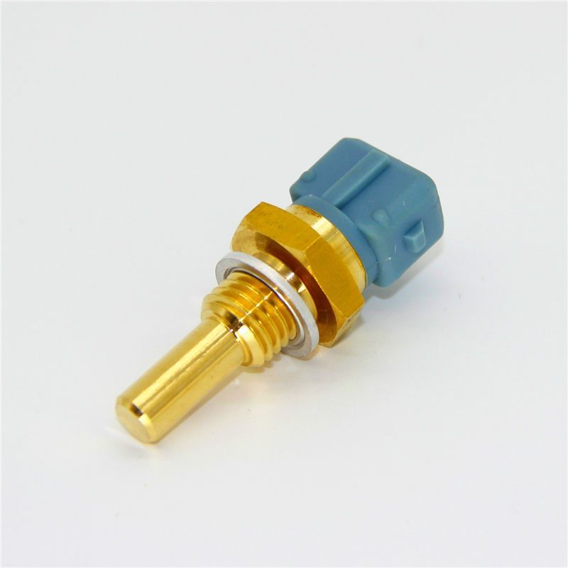

Hello,
please is this the right coolant temp sensor as attach

I wouldn't go near the timing chain at this point. How that would have slipped or moved out of position is hard for me to fathom. Why do you keep mentioning that? Was someone in there?
As for the CTS, l cant tell by looks. Order by part number and measure the Resistance with a DVM if you want to go that deep.
http://www.type17.ch/downloads/Injec...leshooting.pdf - Page 75 has the CTS restance values.
