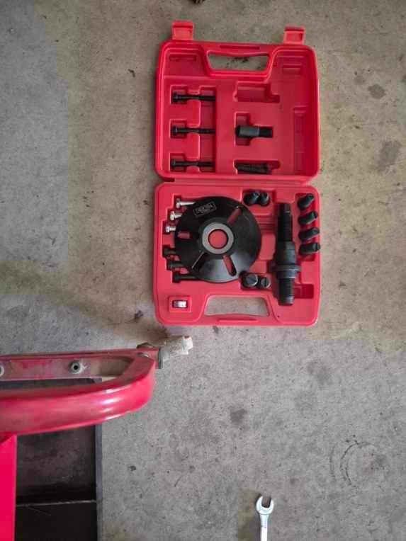

Whilst I was at it, I got myself a decent damper puller/installer. Just for our member's advice I rate this Toledo tool (I like Toledo stuff), the damper came off with small pop, job done. I had a practice on an old Series 2 V12 engine I have in the workshop before tackling the XJ-S, having an engine available on a stand has helped me out several times with 'seeing' what I couldn't whilst the engine was in the engine bay.

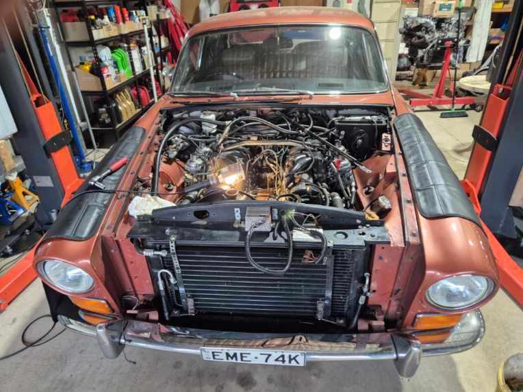

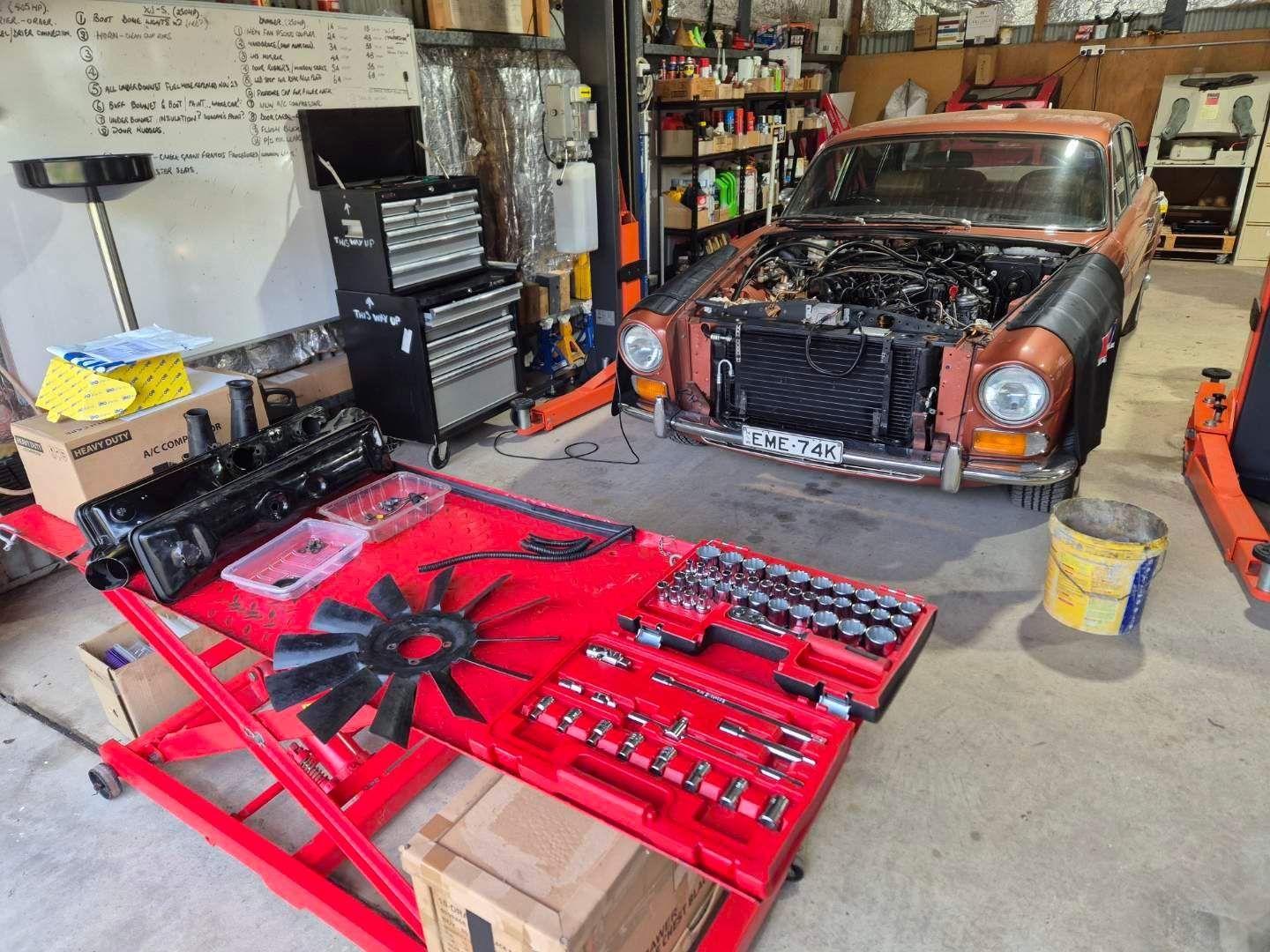

Good afternoon, Team, well after some strange over heating issues/coolant all over the garage floor, I have decided to strip the cooling system down; flush; replace hoses; new viscous coupler; and ensure I have a sealed system. I was posting on another forum but wasn't getting much encouragement. Anyway, inspection of my system has revealed that the Bars Leaks has left greasy sludge in my radiator, overflow tank, and PCV system, and the viscous coupler wasn't viscous enough. I am still trying to source the hoses for the Series 1 V12, SNG have them, Rock Auto unfortunately don't, although they have the hose kit for the Series 3 E-Type which is an identical engine to the 1973 Daimler VDP Double Six, any thoughts? Anyway, just getting the front of the engine apart now to start replacing/dismantling the cooling system. As an aside I also noticed that the ignition wiring in the valley looked a bit crook, so I will do some engine rewiring whilst I have the car apart. I replaced some in my XJ-S and it fixed a multitude of problems.

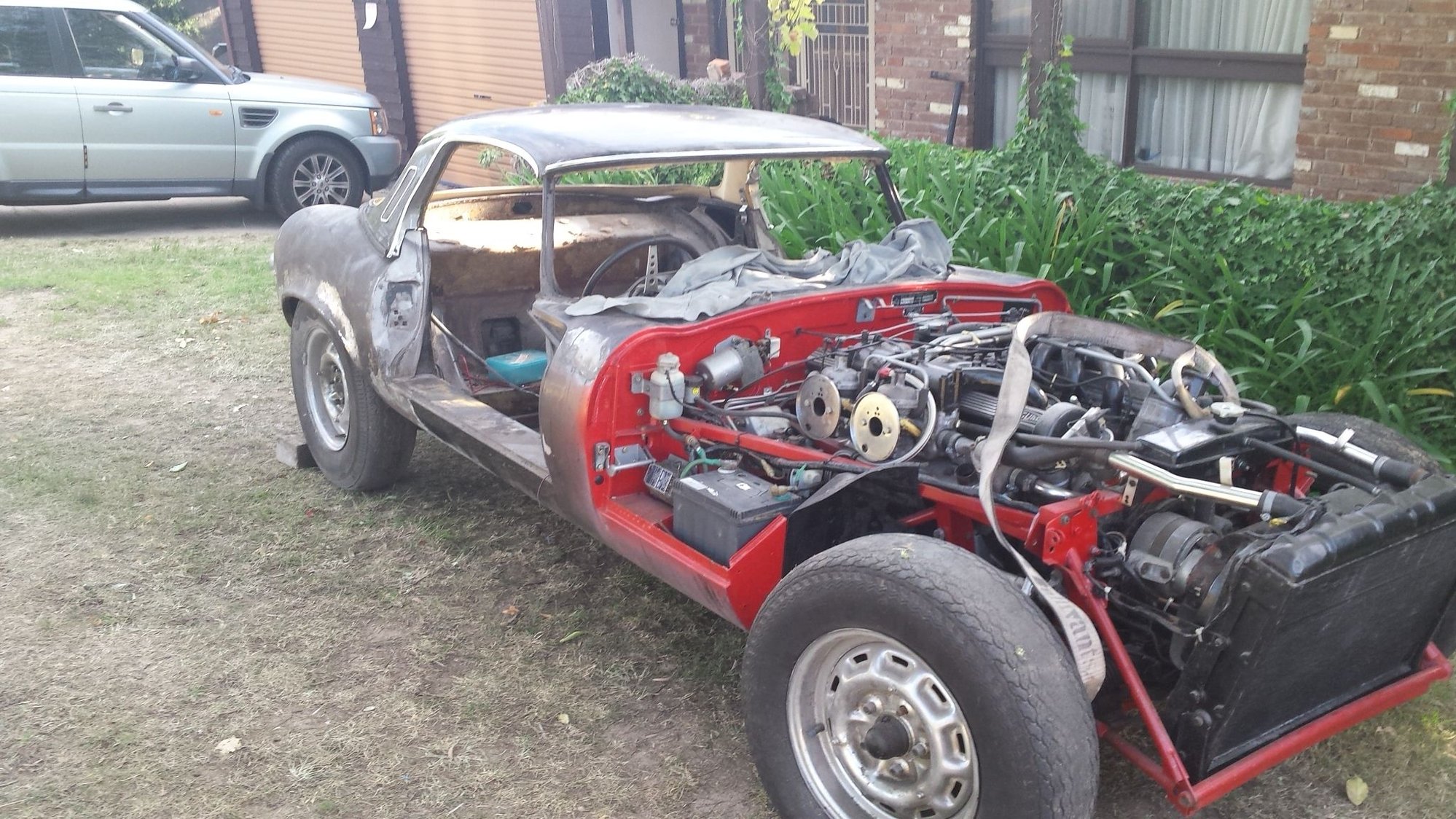

Hi - I have both an Etype V12 and an XJ12 - I cannot directly answer your question whether a Etype hose kit will fit an XJ12. I suspect some of the pipes on the engine itself will be common however the radiator arrangement is different with different plumbing eg - the XJ12 has the overflow at the side of the engine, where the etype has it in the centre. Likewise the radiator is about 12" more forward on the Etype to the XJ12.
By all means get the Etype kit but I think you will need to throw away some of the hoses but use others. I am surprised you cannot find anyone in Australia. Aside from the independants in Melbourne, REPCO might be an option, while they will not have stock in store, they may be able to order for you - same applies with major radiator chains like NATRAD. Oh I have always had a lot of luck just rummaging the radiator hose bin in various Super Cheap stores so take a sample and check - you might find what you want.
Here is a pic of the Etype with the bonnet removed - you can see the differences with respect to the radiator etc.
Garry
PS - bars leak and its equivalent also applies to the E-type - not used it if there are no leaks but have used it where there was. Never had an issue if the coolant is changed when it should and the system flushed - but people get lazy. It is also a lubricant for the water pump.

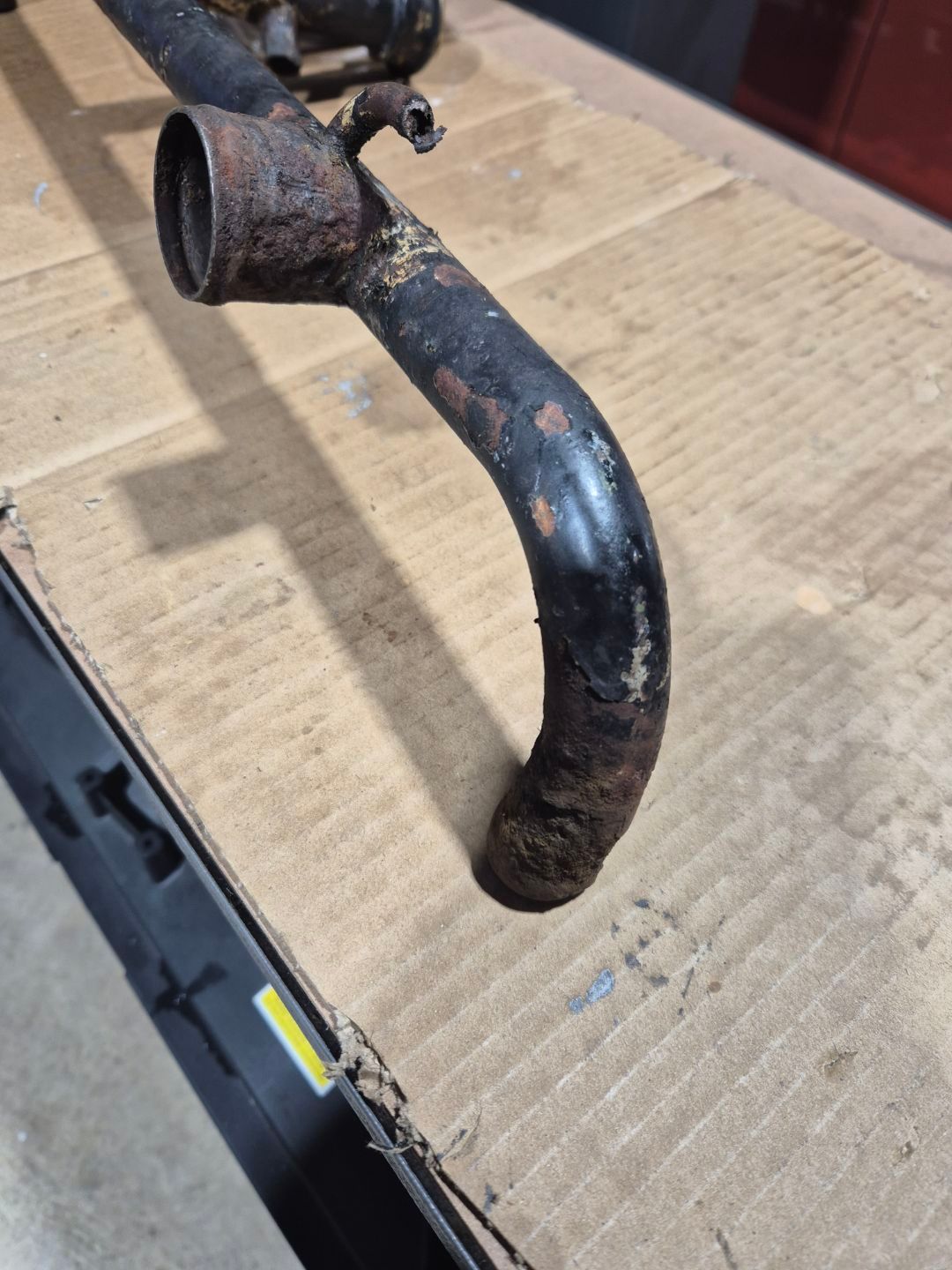

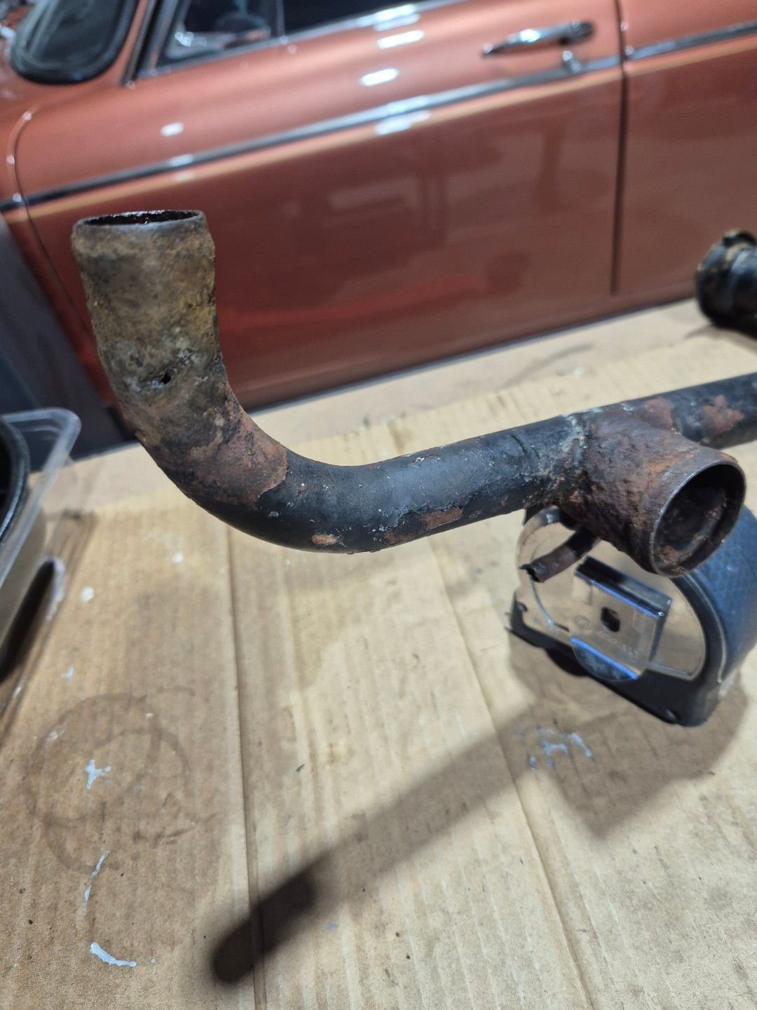

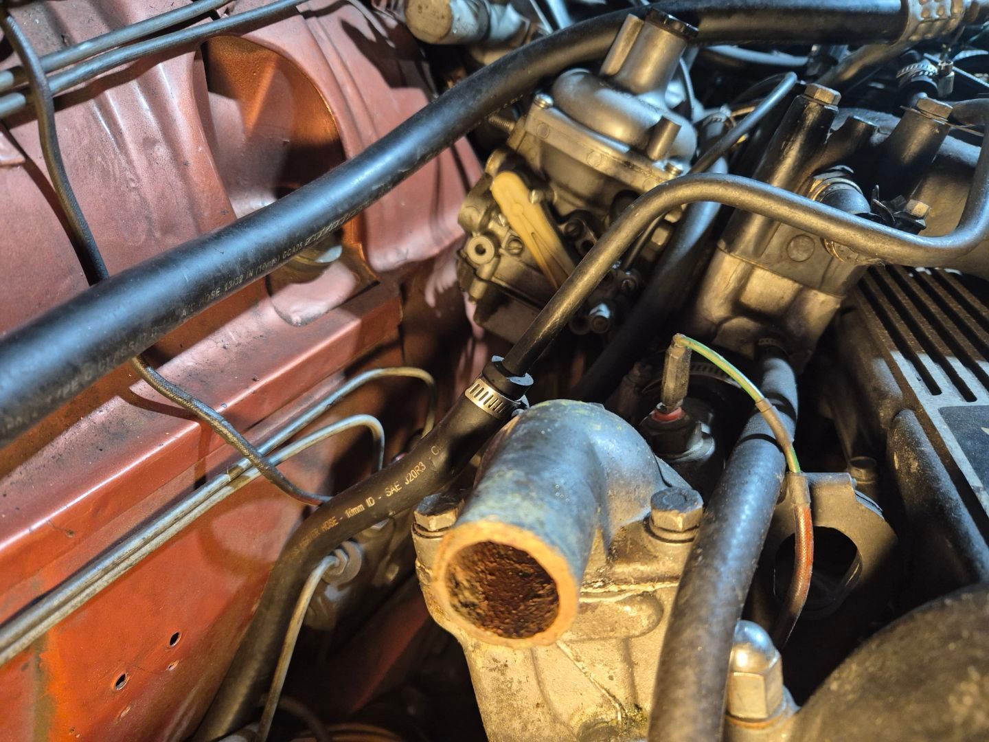

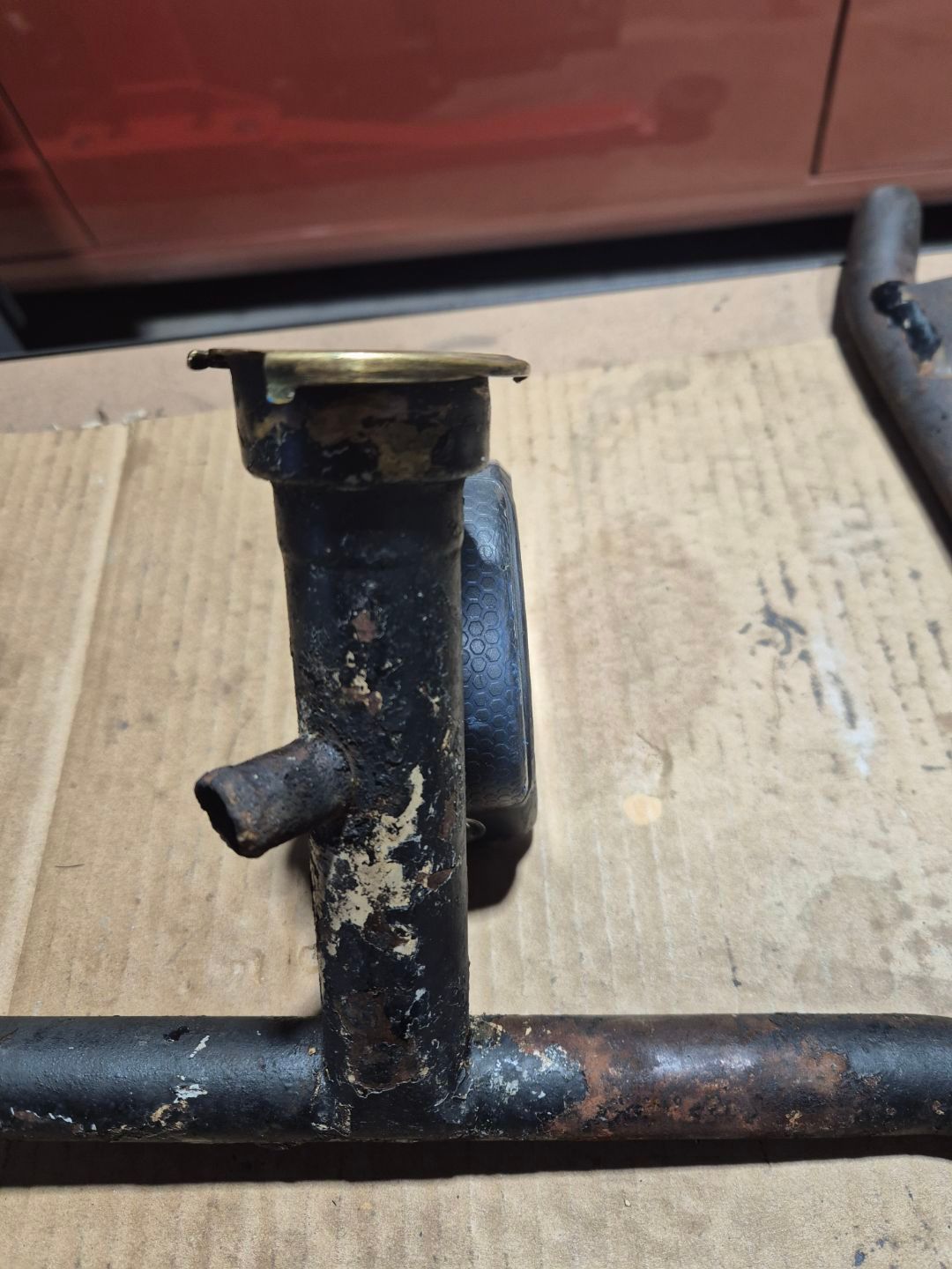

Updates on the Daimler cooling system refurbishment:
a. Radiator was quite badly damaged, and without the Barr's Leaks would have been leaking quite badly;
b. Filler neck assembly was also very corroded, particularly around the hose clip to engine interface; and
c. Transmission oil cooler pipes on the radiator tank were also badly corroded.
So, Barr's Leaks saved the day, or did it? A small leak wouldn't have trashed the engine but would have necessitated an inspection which would have revealed corrosion, and subsequent repair.
Anyone knowing of a source for the filler neck gratefully received. I have already got:
a. EverydayXJ.com from Greg in France; and
b. From DMJ Jack Weston 'Simply Performance' @ GBP 220.00 which seems a tad expensive?
The filler neck from my spare Series 2 V12 is different.

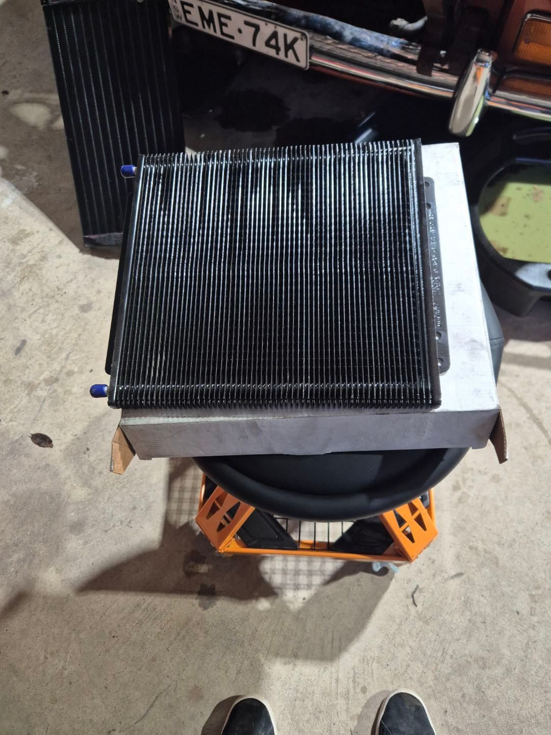

I also bought a standalone Transmission Oil cooler which goes in front of the condenser, as recommended by Grant. The radiator is set to 82-87 C and doesn't really cool the transmission oil significantly, whereas a standalone unit subject to my new viscous coupler fan is going to get the full benefit of ambient air movement: at worst 32-35C.
