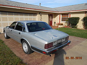

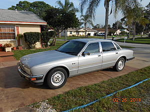

I picked this up today for the wheels and outboard brake system for my
Series 3. I drove the car home about 80 miles and everything work good even cold AC.
I will be posting on the XJ40 forum to see if any one needs parts.
The engine and tranny are solid. The seats are in excellent condition. The only damage is the center console cover and the clearcoat on the body.
No rust,no dents or dings. HA HA I washed it.
Cost of car????? Less than the cost of a set of wheels plus shipping and I get 5 wheels. I am going to get the wheels chromed.

man don't scrap the car!!

Geeeee......I'd be half-tempted (maybe more!) to keep it intact and find a different donor car !

@Doug: Having slept on it, I am tempted to keep it intact but time will tell.
Right now I have the chrome Series 2 wheels on the black (lumped)Series 3 and the original Kent wheels on the grey (stock)Series 3. If Jose can link me with the set of XJ-S wheels, then my thinking may change and I will just replace the wheels and leave the inboard brake as it is.

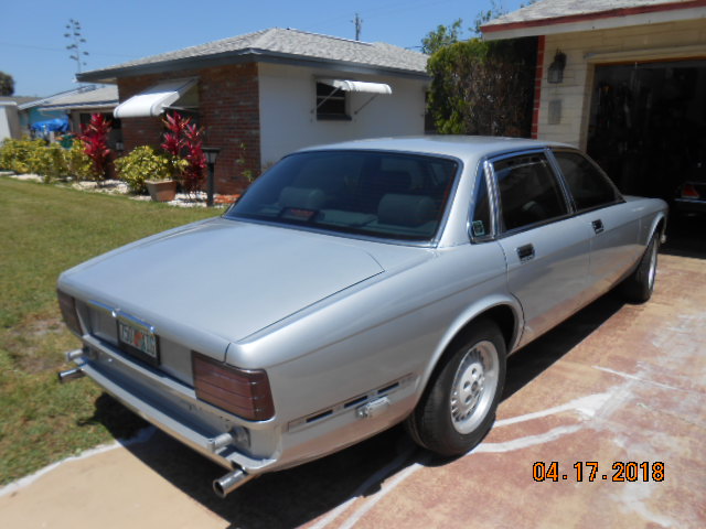

Just an update: I have posted this in the XJ40 forum.
Heeding the advice given in the posts above re:my recently acquired XJ40, I decided not to dismantle the car and restore it to the best of my ability. I will look elsewhere for the wheels and outboard brake assemblies elsewhere.
Most of the few mechanical/maintenance issues completed.
Major work included replacing:
Rear Hub bearings.
Front Hub bearings
Oil leak (O-ring replacement)
Steering Rack replaced.
Car repainted. Now on to cut and buff to a beautiful shine.
Thank you all for encouraging me to save this car.

Old Apr 19, 2018 | 08:11 AM
JagCad's Avatar
Posts: 6,796
Likes: 2,403
Sanchez:
I am sure you will not regret saving this nice car.
Au contraire, you might have regretted scraping it!
Enjoy it.
