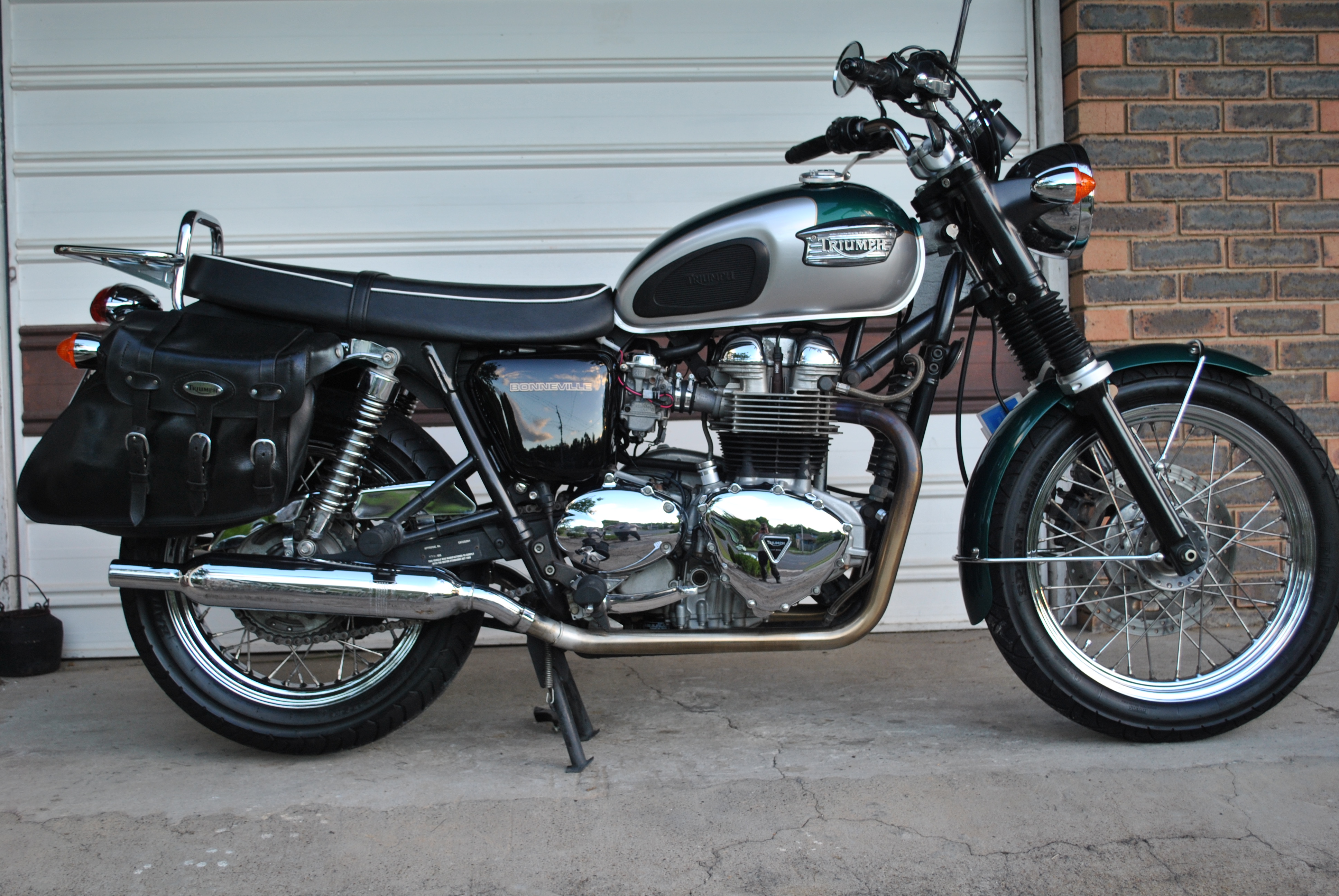

To me mileage is just a number, I always buy on what I see when I inspect and test drive and a huge amount of gut feeling. Only been burnt once in 30+ motorcycles and nearly as many cars.
I have sold motorcycles I have done over 100,000 km on that look and run like brand new. The buyers looked and bought usually at my price because they couldn't believe the vehicles had done the mileage............It is always just a number, I have seen vehicles with 20,000 km on them I wouldn't touch.
11 years old and 106'000 km on the clock when this pic was taken. First looker bought it for $200 under my price.

14 years old and 90,000 km on the clock, first looker didn't even start it before he offered the deposit. I made him ride it before I took his cash. No negotiation, he was just happy to pay my price.

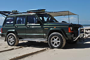

20 years old with 224,000 km on the clock, sold in one day with no receipts for servicing as I did it myself for most of it's life.
