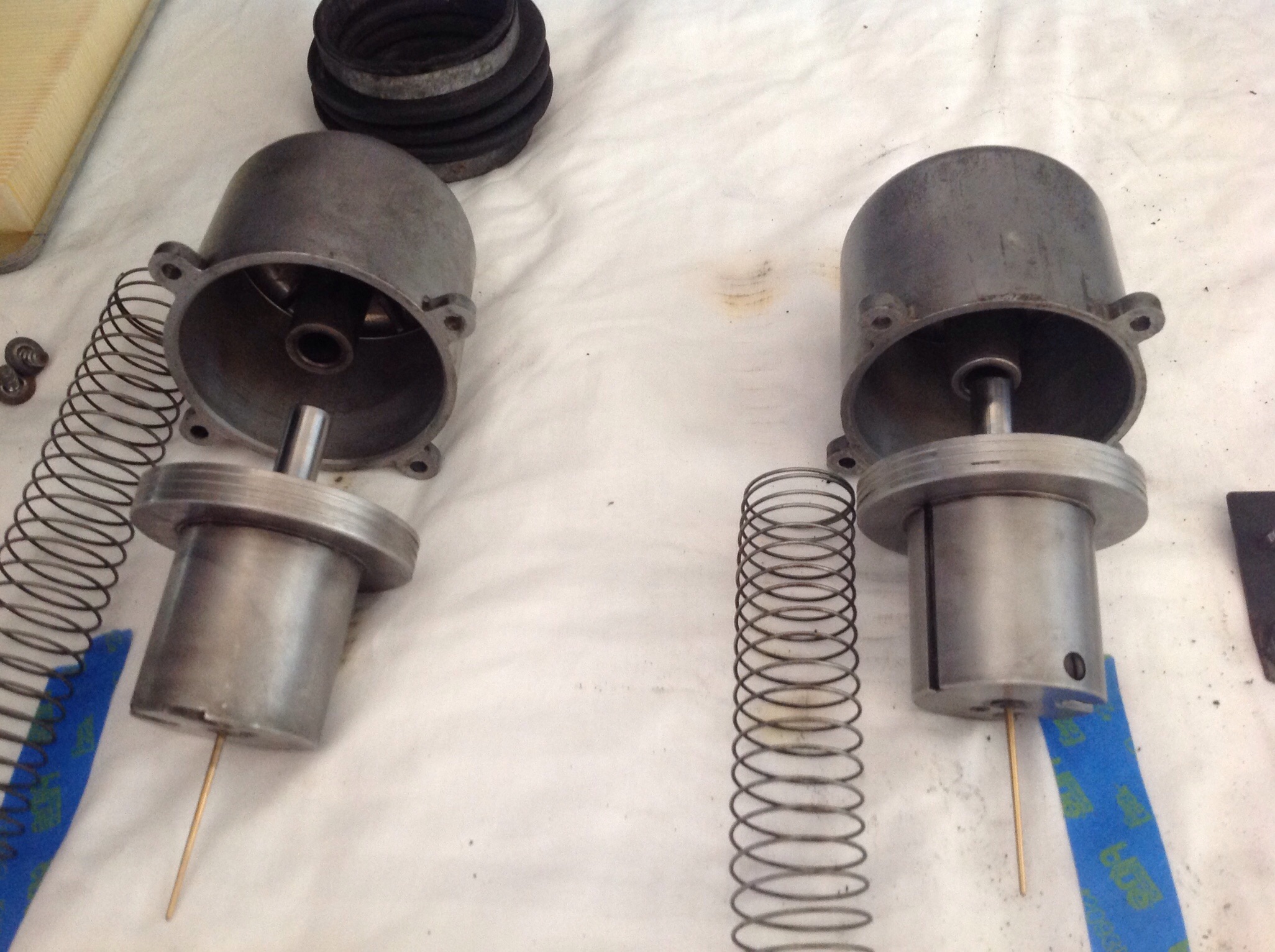

Old Mar 30, 2015 | 03:12 AM
Daf11e's Avatar
Active Streak: 120 Days
Posts: 46,028
Likes: 4,715
Where to start with slight engine miss-image.jpgWell I decided today was the day for cleaning the carbies and followed instructions. I had to improvise on a couple of things,one the aircon pipes on the engine had to be moved for clearance to remove left dome and also the choke cable went through the lower hole of the same dome so had to be disconnected. Apart from that all went according to plan and now running very well. As can be seen from the piccies God knows when they were last cleaned.....should have it spot on after a couple of tweeks.
Grant that write up allows tinkerers like me to achieve great results....thanks!
Old Mar 30, 2015 | 03:14 AM
Daf11e's Avatar
Posts: 46,028
Likes: 4,715
And this
