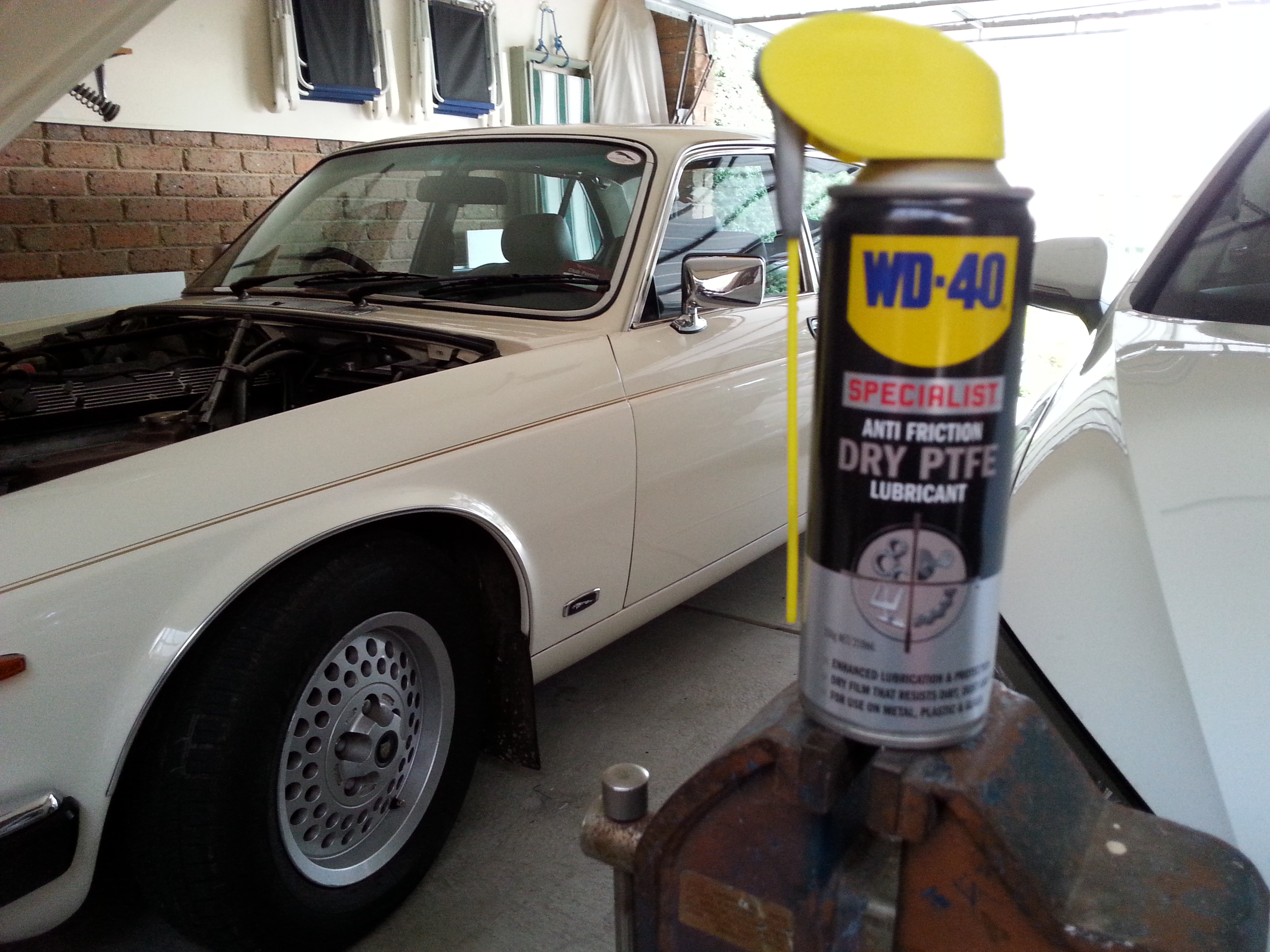

I understand that the properties of silicone are not exactly dust repellent, but I must say I've never had a problem with it on the window channels. After 12 months they're still clean as a whistle. Then again, my Jag is not a daily driver and always parked with windows up! On a daily driver in frequent dusty conditions silicone might be less desirable.
I avoid using graphite for the reasons Nigel mentions, even in locks. The alternative (compromise?) is this WD40 product - damned expensive and it works, but not as well as silicone IMO. However, it is a dry lube that specifically states it won't attract dust & dirt and is easy to apply being a spray with fine nozzle.
