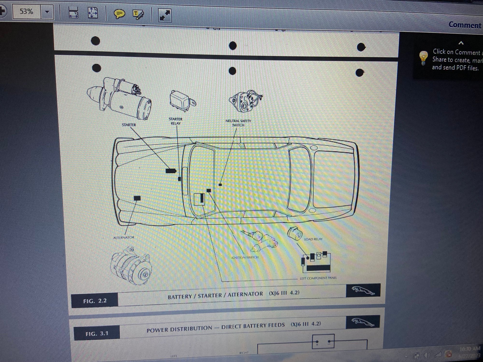

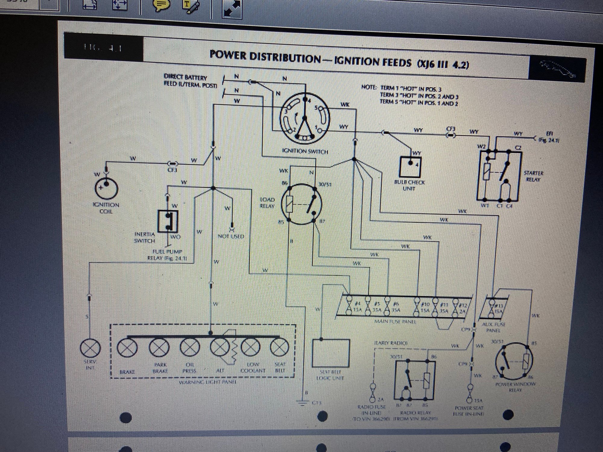

Caught caught in rain other day and wipers dead, worked last time I was out, but this tome
nothing, just had time to check it out, inhave no power to fuse 6, where do I look next, my printed s57 and laptop with it on are both already in storage!! Help!!

Is anything else inoperative?
Power to Fuse 6 comes from the load relay. The load relay also powers-up a few other circuits connected to Fuse 5.
If Fuse 5 is also powerless, the load relay might be a prime suspect!

Never mind, found a copy saved in my jag folder I. Email!! Load relay was bad! All sorted!! One thing I did figure out though, was that slow wipers are better than no wipers!!!!!

Doug, your response was not showing when I typed mine!! But you hit it on the head! Nothing on 5 or 6!!

For anyone that doesn’t have the s57, download it now( I believe Jose has it on his website) it’s invaluable!! Saved me hours of fumbling, figured out my issue in less than 10 minutes!
