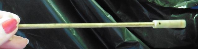

That large white nylon nut in the center of the steering wheel is the Horn Contact. It holds a long brass probe that grounds when the horn is pressed on the center crash pad.
It's only finger tight but you'll need a socket to get a grip on it. (DON'T OVERTIGHTEN!)
As you can see in the photo, the probe has a sleeve that fits over a contact deep inside the column for proper grounding and horn operation. You can just see it with a strong light aimed down the hole.
As you have horn issues that's the place I would suggest you start, by cleaning the contact areas at the end of this probe and looking for any possible shorted areas here.

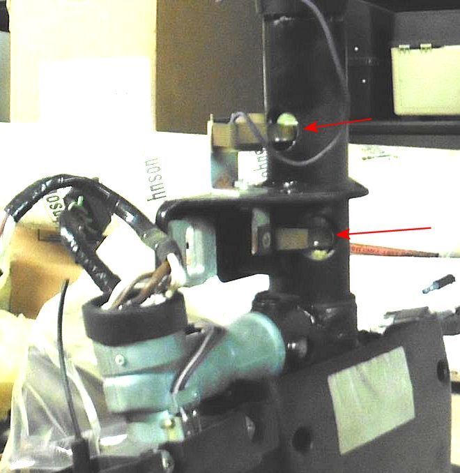

Also, there are 2 wipers on the column, exposed under the dash area. These are grounding wipers, curled metal straps in contact with the column.
Here's a photo of them, but this column is vertical. You'll get the idea.

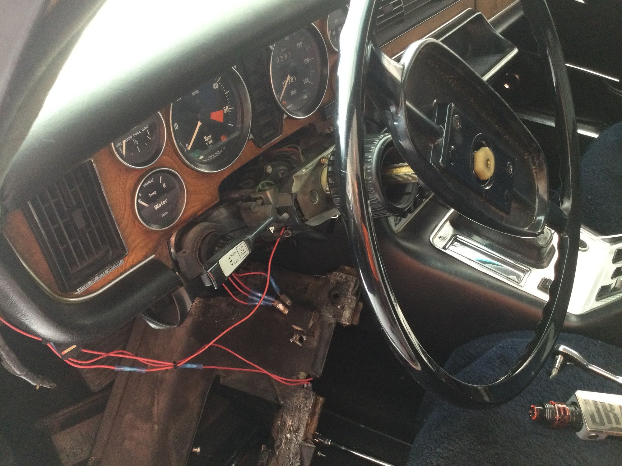

I’m going to remove the rod and see what happens. My major concern is the turn signals, as they stopped functioning right after the horn issue popped up. The sequence of events was as follows:
took the car for a blast around the neighborhood and returned home. Went inside to grab my phone. Fired the car up, made a u-turn in our cul-de-sac, turned the corner(left) and the horn blared. I thought I had accidentally pressed it as my hand was on the edge of the pad. Next left turn, did it again. I said “f—- it” and drove the 4 miles to the store, with the car making little toots every time I turned left. I could tell it was happening every time that I could hear the turn signal canceller (is that even a word?) click as I turned the wheel. I confirmed this when I reached the parking lot and turned the wheel right and left. I went in the store, got what I needed, and returned to the car. Backed out of the spot (toot) put her in drive, turned the wheel right (toot)….. great, now it does it turning left AND right. Drive back home, have to make a turn. Great, now I have no turn signals. On a whim, I try the hazard lights. Nope. I got home and backed it into the garage, bummed because I had planned to take it to a small local car show that night.
My thinking is that the turn signal switch is tied in with this somehow. I’ll be able to dig in to this some more tomorrow after work.

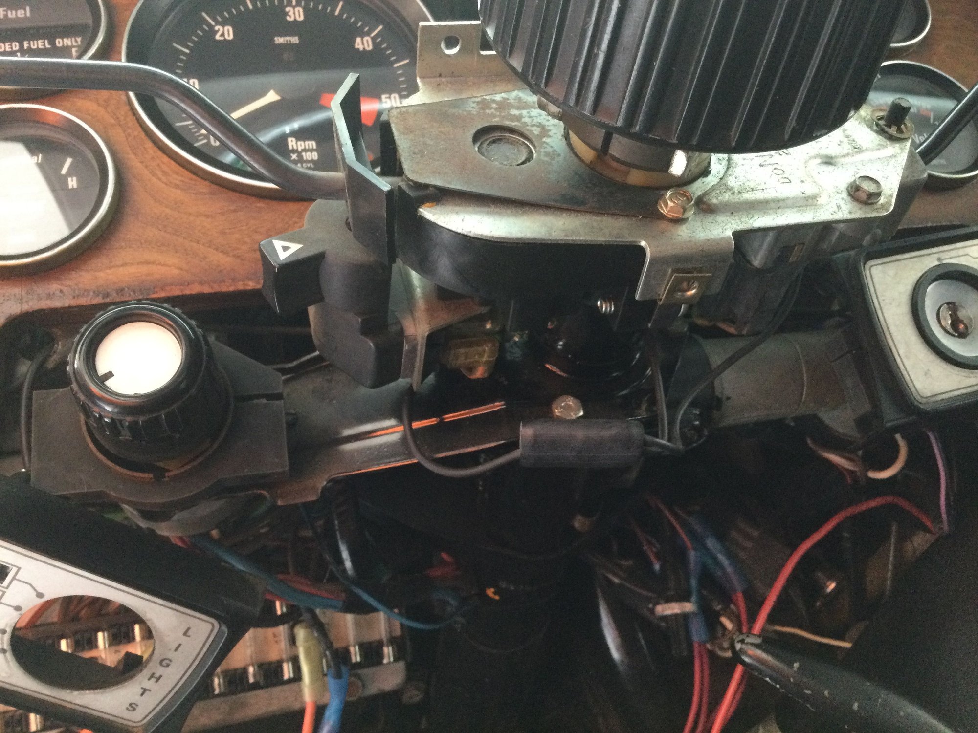

Ok, I’m back. I finally had a chance to I’ve deeper into this. I did find one ground wire from the speedometer that wasn’t connected. My indicators will work if the hazard switch is in the up position. The horn rod is removed. The car still honks every time I turn the wheel and click the signal cancel. Any other ideas?
Old May 28, 2023 | 03:03 PM
Wookie909's Avatar
Joined: Jun 2012
Posts: 13
Update. It’s the brass wipers on the steering column. I’ve taken them out of the equation for now. That will be a winter garage project, not a summer in southern Utah project.
