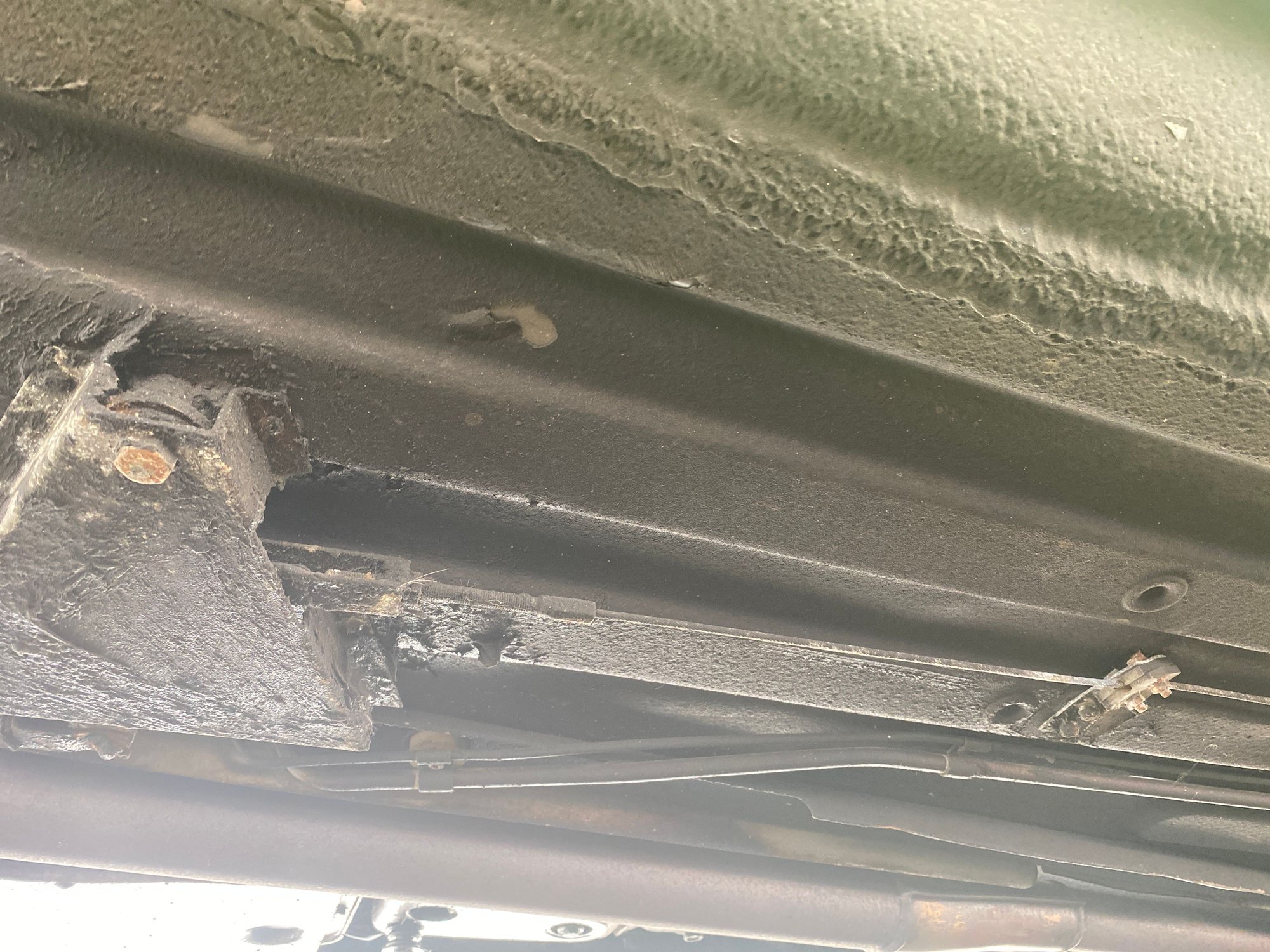

Hey guys, been stripping my xj of paint this past week and it wasn’t until today I noticed this wire rope in the underside of my car, the problem with it is that the bracket that holds it seems to be bent and not letting it move, I haven’t been having Any issues with my car at least not noticeable ones so I’m quite curious and concerned what this wire is for, can’t seem to find anything about it online, any answers are much appreciated.
The bent bracket

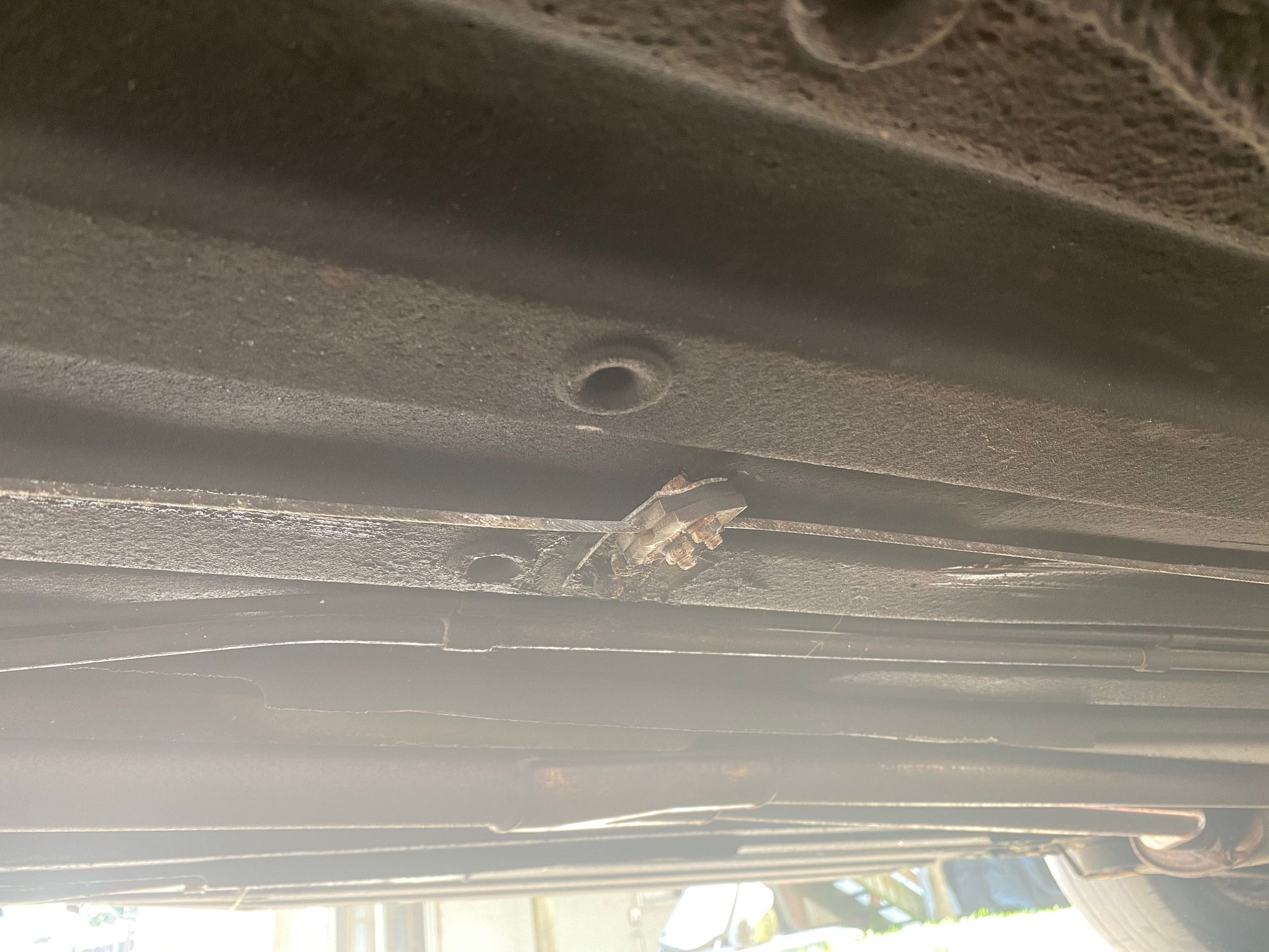

Where the wire attaches in front, doesn’t seem to connect to anything except this metal

Looks like the handbrake cable that you Americans apparently never use !
It is a legal requirement to have a second totally independent brake system here in the UK and many other countries too, and I suspect also in the US. Any car with an auto transmission has a Park facility that merely puts a pawl into the output shaft in the gearbox to prevent rotation so is a brake of sorts, and as far as I have read here on the forum, most Americans just put their cars in Park and never apply the handbrake, the Park setting stops the car moving. Modern jaguars have an electric "hand brake" that is applied when the car is in Park and the ignition key is removed, my MB SLK has the same. I can also apply this brake in an emergency like a total brake failure.
So your car looks as if somebody in the past has disabled the handbrake or it has been damaged by driving over a rock or something.

On of the peculiarities of this system is that it was designed to be a "parking brake" and not what we usually think of as an handbrake in the modern sense. It was made solely to hold a stationary car and prevent it moving from a static position (eg: on an incline) and if well-maintained and properly adjusted it does exactly that. What it doesn't do (at least not very effectively) is bring a moving vehicle to a stop - something it was never designed to be used to do - the original intent was just to stop (manual gearbox/stick shift) cars from wandering off when unattended...
