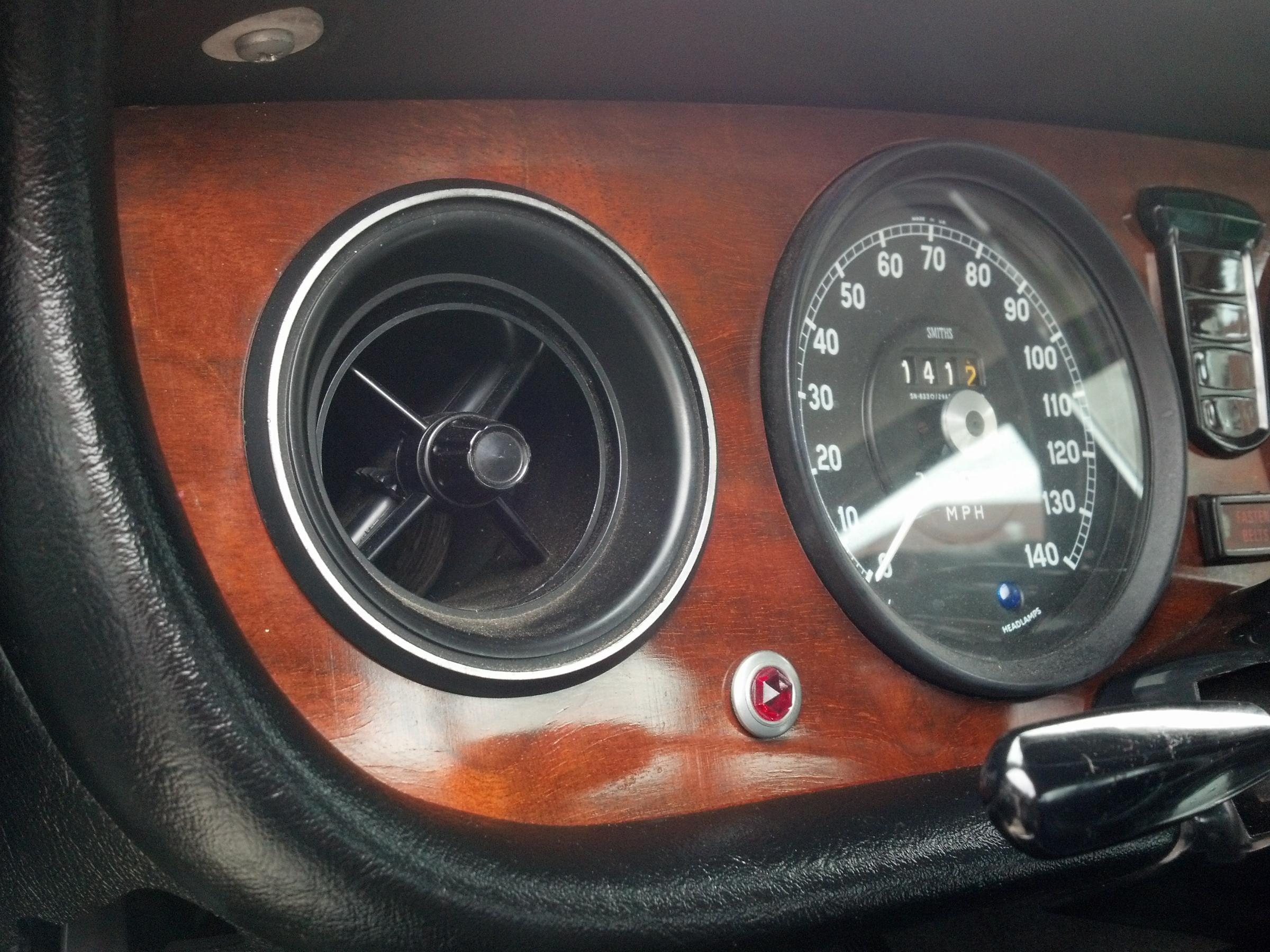

Default Having had the same problem - I replaced with new wood
My '71 XJ had the same problem, but some PO had attempted to "refinish" the dash in place doing a "good job".
I obtained new dash wood from CG Woodcraft and it looks great! Fit was perfect and the coating is more modern and sturdy.
The photo is an old one that shows only one center vent added - there is now one dual vent in the parcel tray.

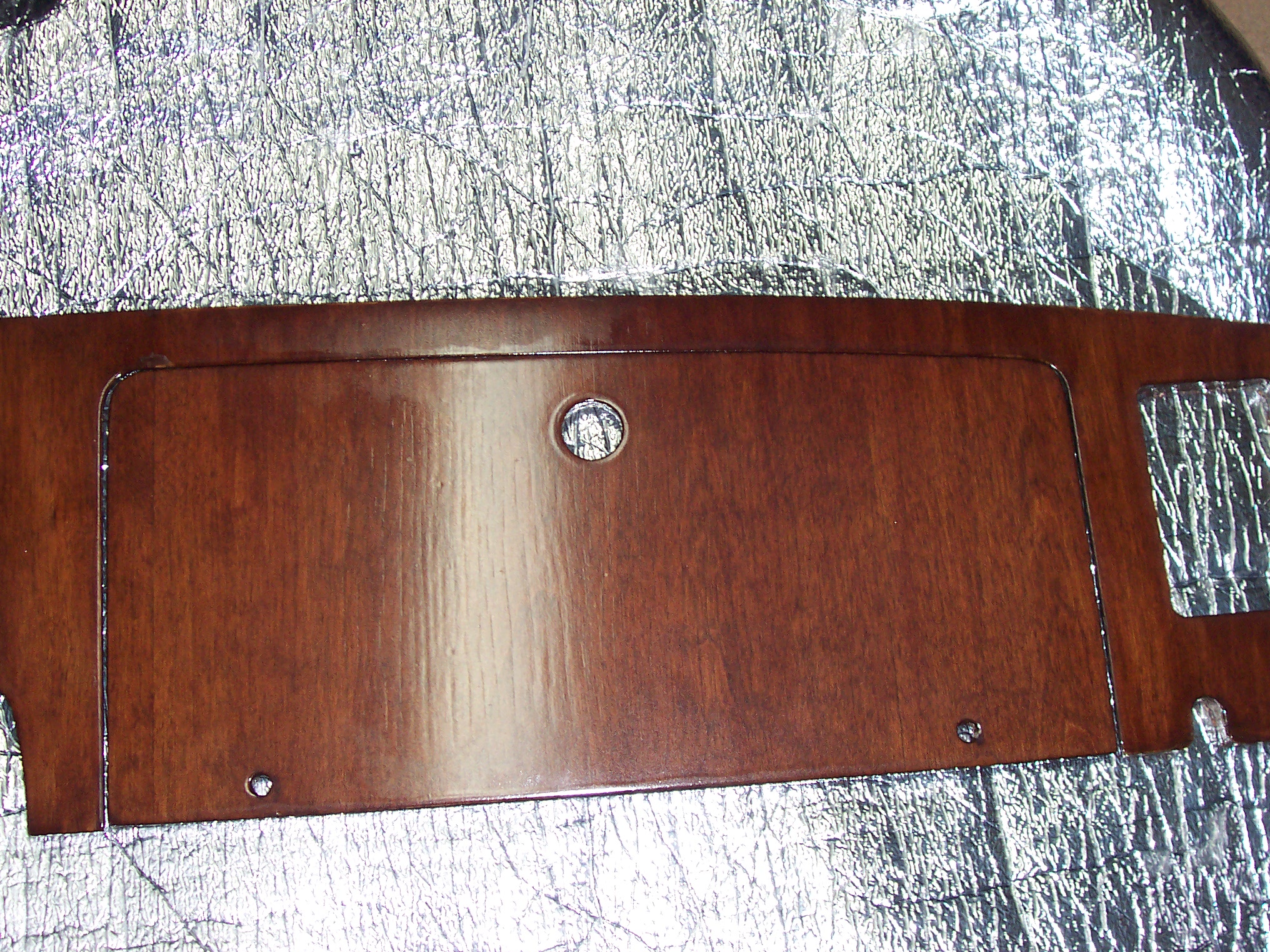

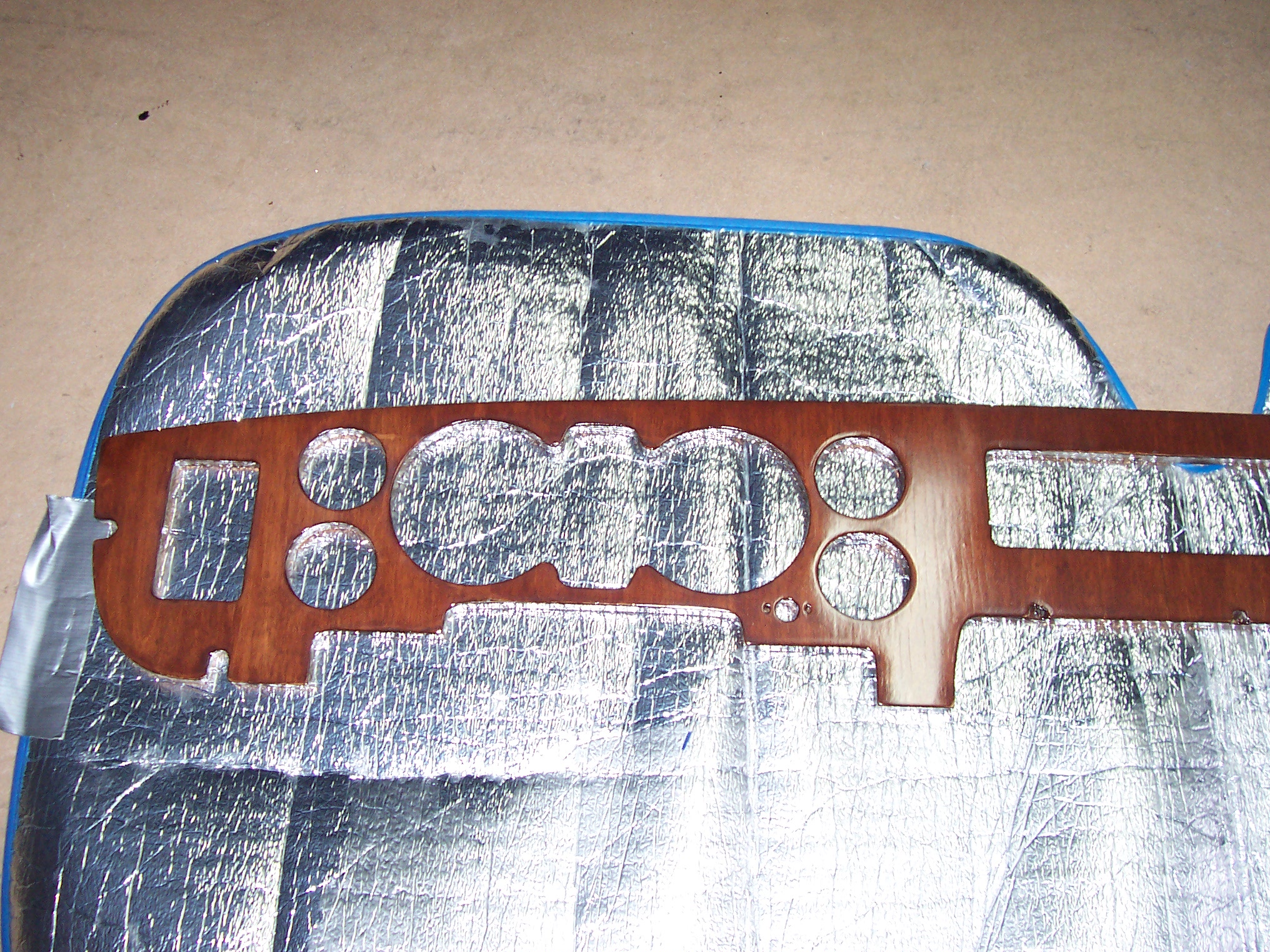

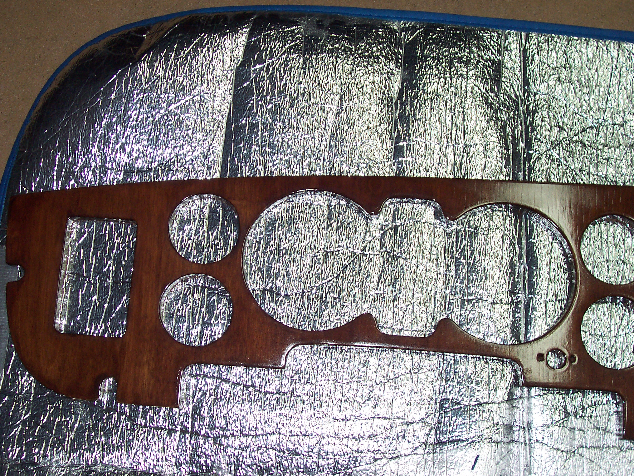

I have the same problem with my dash. Varnish cracking and wavy. see attached photos. I decided to remove the dash and recondition it. Pictures show the dash before it was removed and the dash after I sanded, stained and applied one coat of satin polyurethane. I will lightly sand this coat and apply a few more coats of the satin polyurethane, sanding between each coat. Finally I will apply two heavy coats of high gloss polyurethane. The reason i am using the satin then the high gloss is that I already had some of the satin which I had purchased to redo my kitchen cabinets. The high gloss I also have about 1/2 a quart. I am doing this with a spray gun. Sanding done using an orbital sander and 280 sanding discs
Stain color: English Chestnut 2 (Minwax)
Cost? I have all the stuff I need.
Labor? intensive
Attached Thumbnails Wood Dash Cleaning and Maintenance-100_1100.jpg   Wood Dash Cleaning and Maintenance-100_1102.jpg   Wood Dash Cleaning and Maintenance-100_1104.jpg   Wood Dash Cleaning and Maintenance-100_1095.jpg   Wood Dash Cleaning and Maintenance-100_1096.jpg
Wood Dash Cleaning and Maintenance-100_1098.jpg   Wood Dash Cleaning and Maintenance-100_1099.jpg

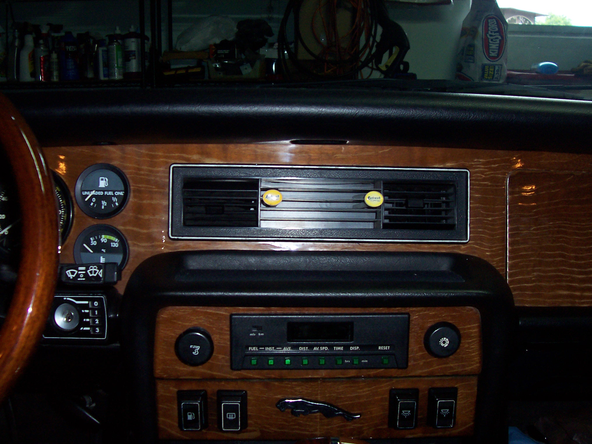

My wood dash was very cracked and aged so I resurfaced the dash with African Rosewood. It has a polyurethane satin finish and looks like a very exotic walnut color. I was very lucky to find a rusted hulk of a 1971 Series I Jaguar with a beautiful Nardi steering wheel. The Nardi wheel is the same vintage as my 1975 XJ6-Coupe. The car was a German export car, with German script on the body ID tag. An American soldier brought it back from Germany.
