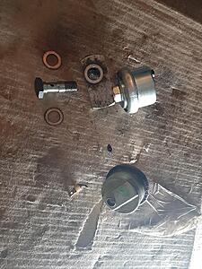

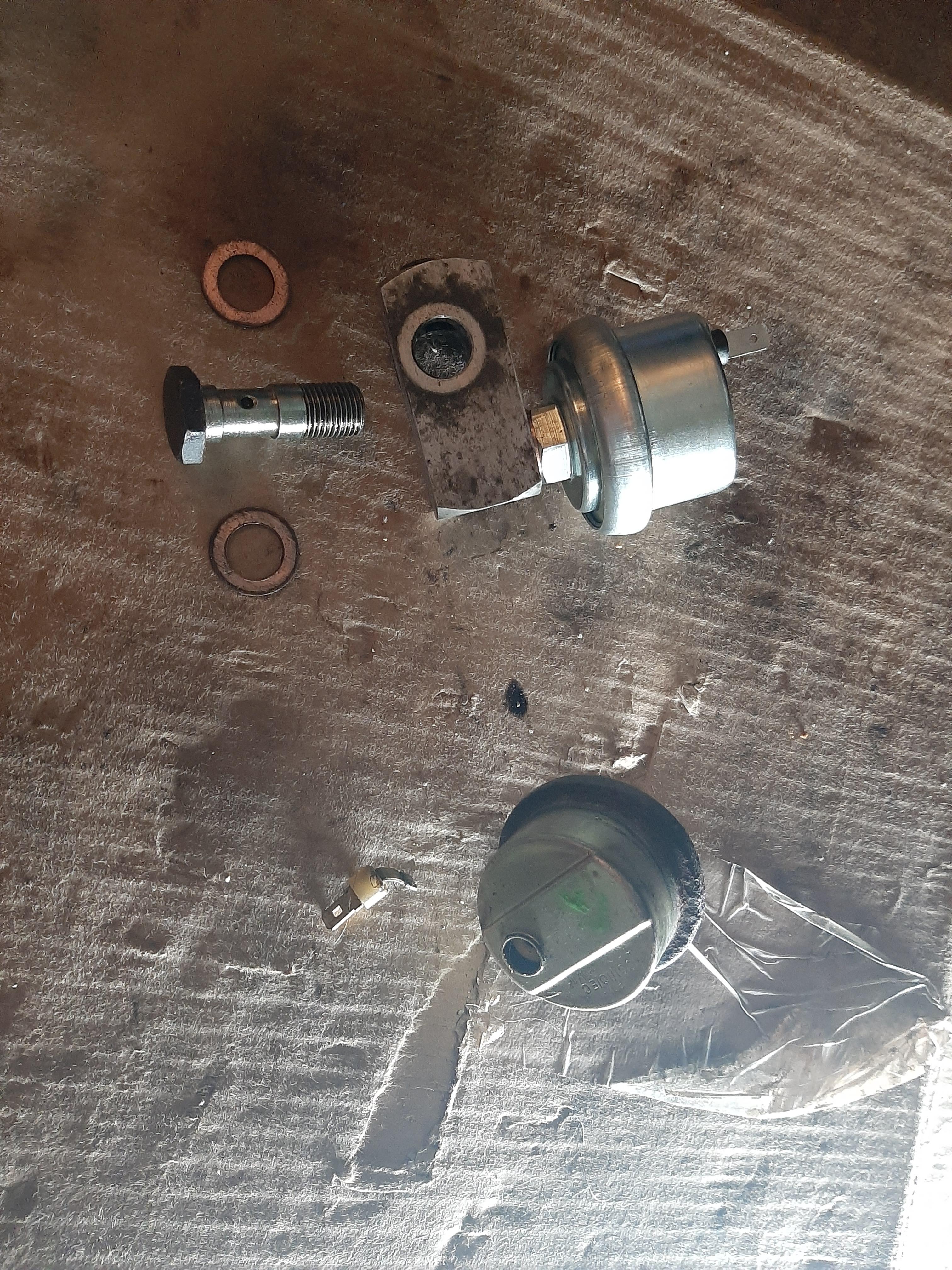

this one's for Doug since i did not heed his good advice from another post wherein he advised removing the oil pressure sensor to avoid doing what i did:[. wll i got a new oil sensor now
