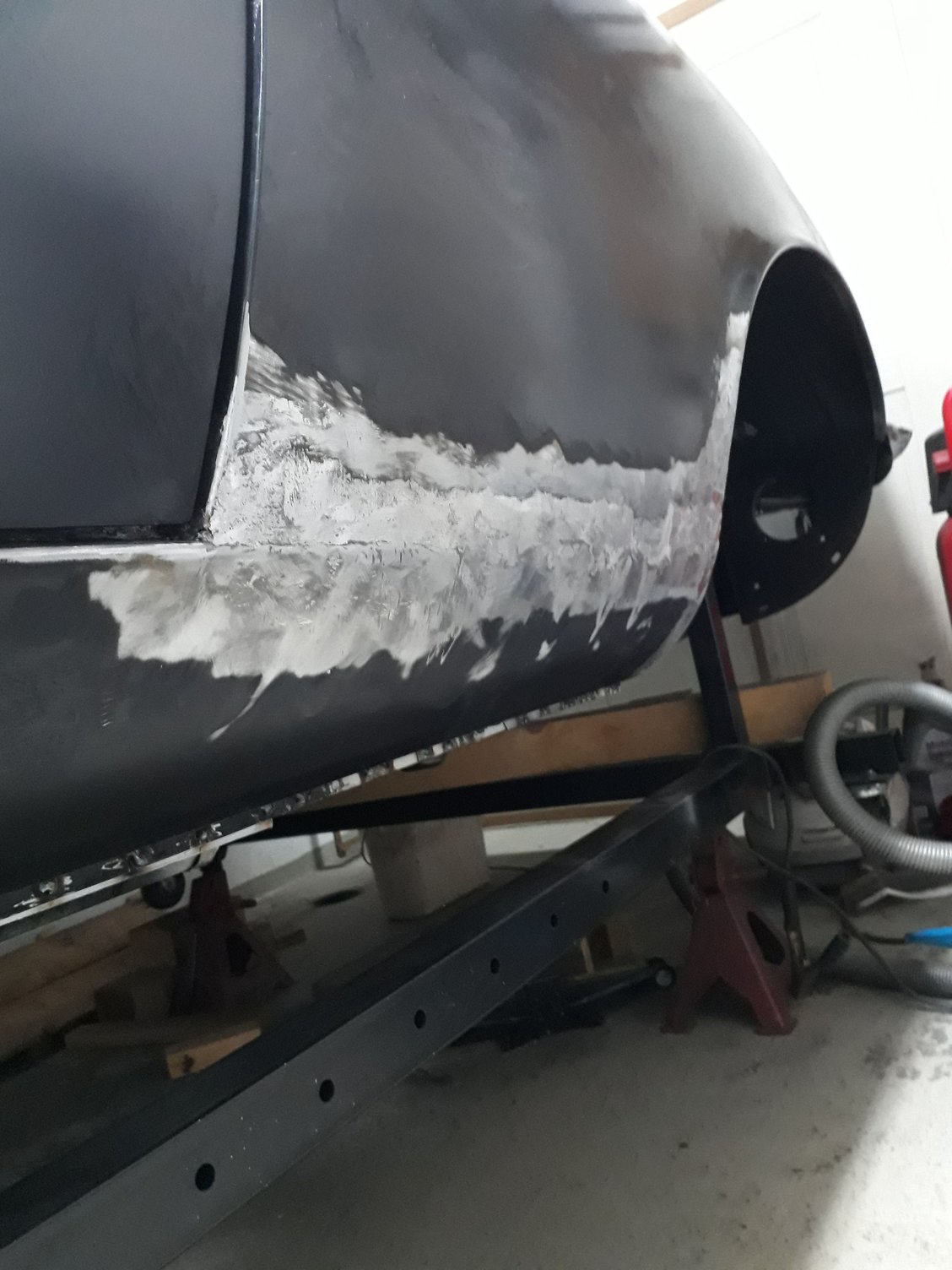

hi
I have replaced floor pan + outer and inner sill on my coupe. I am an amateur so nothing looks very good...
The seam between sill and quarter panel looked horrible so decided to lead fill it. Originally I think it is not?
will it look weird somehow with this seam filled?

I've done it. It will look fine. This area moves and is under stress so don't be shocked if the seam cracks at some point.

would plastic filler be more resistant to cracking under stress? (if assumed applied in the right way). I have zero experience with these things...

the plastic will crack real fast. If you don't want it to crack you will have to seam weld and metal finish it.

I filled in this seam on an XJS with body filler and it was intact after 5 years. Lead is even better.

Guess you could always create a depression along the seam, so that if it wanted to crack, the stress would be relived in the right place.
