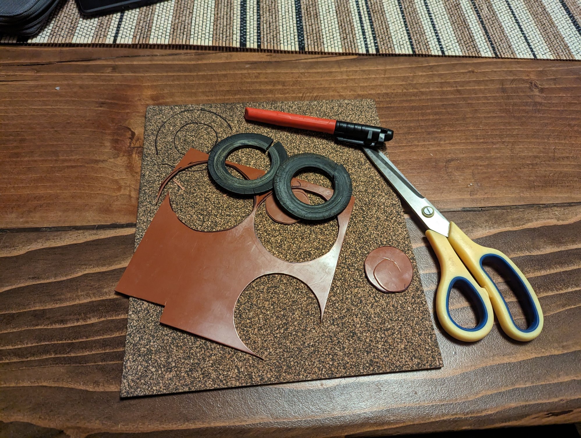

I found some sheet rubber I had, thinner than the original, and sat at the dining table to quickly cut out some new fuel cap "O" seals to replace the old ones. Popped them on and just got back from a refreshingly fume-less summer night drive, windows open, pleasant evening air whistling through the cabin.
We don't pay you guys and gals enough. Thanks.

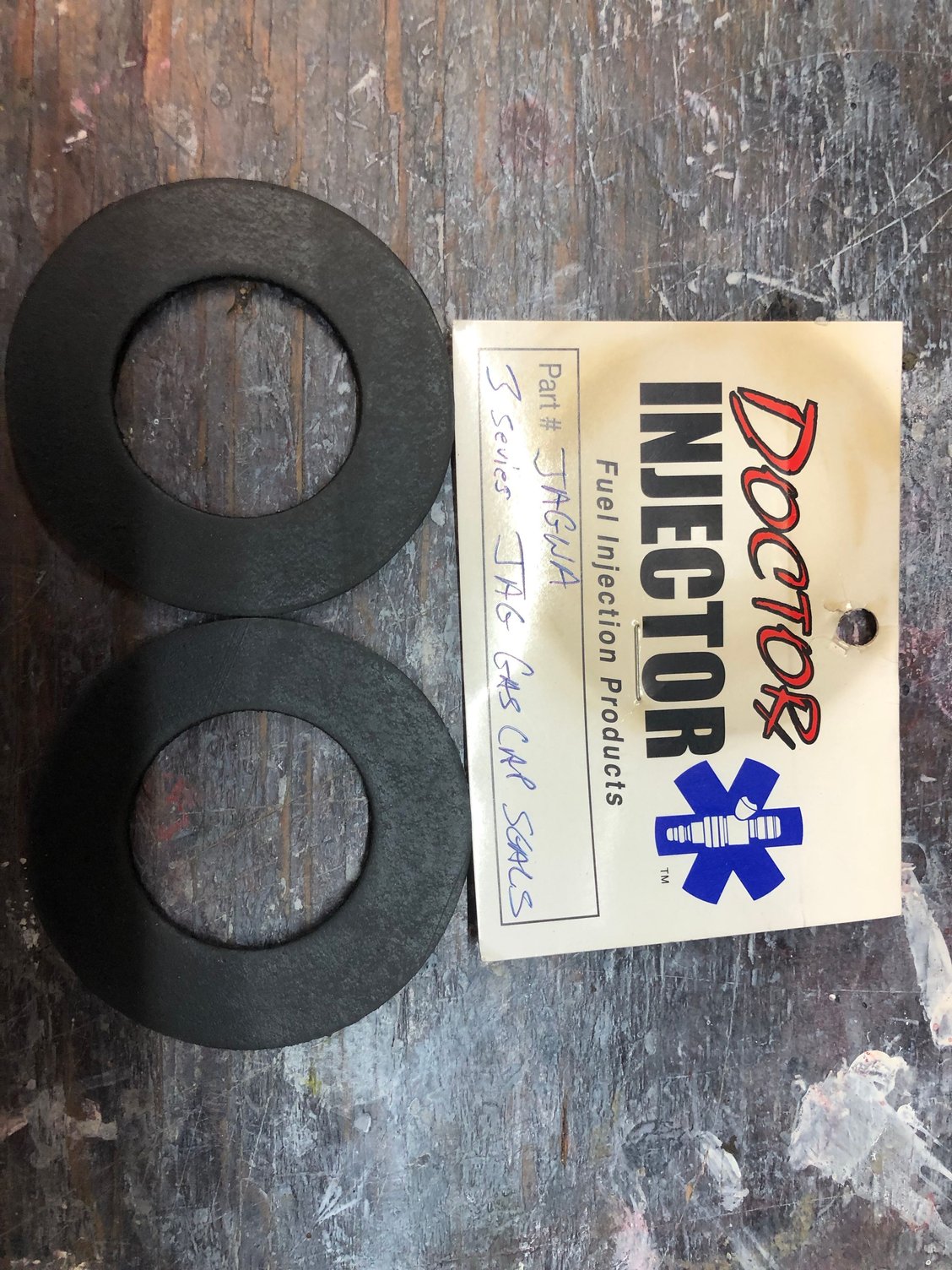

Maybe this guy is still in business?
Old Aug 27, 2023 | 01:23 PM
slofut's Avatar
Joined: Jun 2012
Posts: 846
Likes: 349
From: SW Ga. Home of grits and gnats!
Phone...
docinjector.com 888-438-1968
