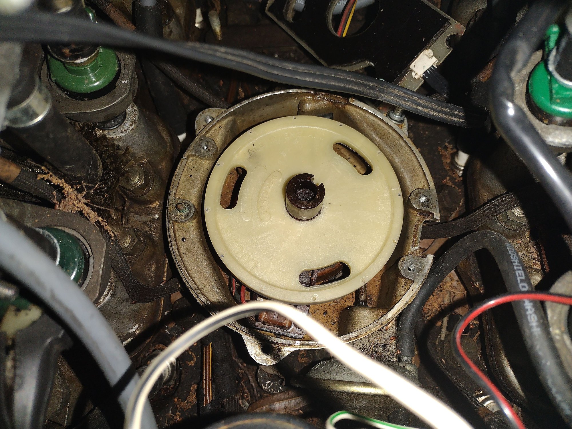

The ferrite strips in the plastic wheel fall out, gravity. So, a TSB was issued waaaaay back to remove that wheel, invert it, and apply a "drop" of glue to the opening for each rod, thus securing them. I heard Super Glue was the go to, but never did a hands on myself.
One of mine was a V11, and nothing made sense. Eventually found that had a dropped ferrite strip, duh.

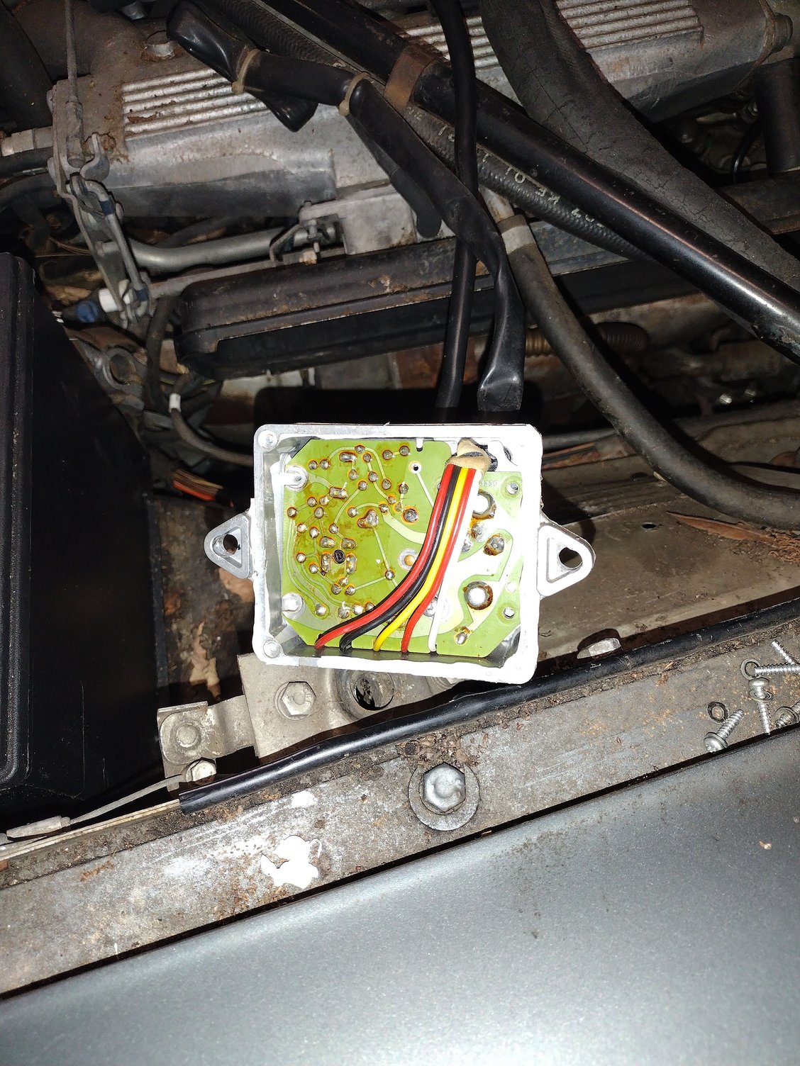

HEAT, the killer of the Opus Amp in the "V", and there once was a kit to relocate it out of the "V", but that was a very long tome ago.
All those things led me to the Crane at the time. Anything available today would be more reliable than the Opus.

Also found a timing rotor for under $100 so I went ahead and replaced it. Pickup magnet seemed good

Next job reflowing the old solder in here.
