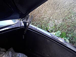

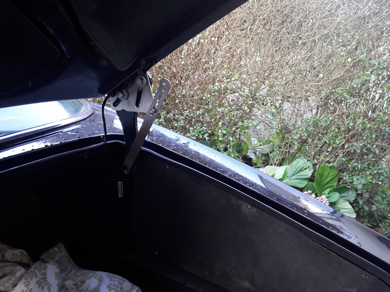

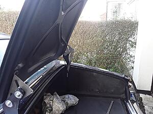

David's kit arrived in the UK last week and this weekend and with the help of a friend was was fitted. No problems were encountered with the fit and it has made a big difference to the ease of accessing the boot. Many thanks to David for designing and producing the kit.
Attached Thumbnails XJ6 New and Improved Boot-Lid Hinge (concept)-standard-hight.jpg   XJ6 New and Improved Boot-Lid Hinge (concept)-standard-hight2.jpg   XJ6 New and Improved Boot-Lid Hinge (concept)-extended-hight.jpg   XJ6 New and Improved Boot-Lid Hinge (concept)-extended-hight2.jpg
