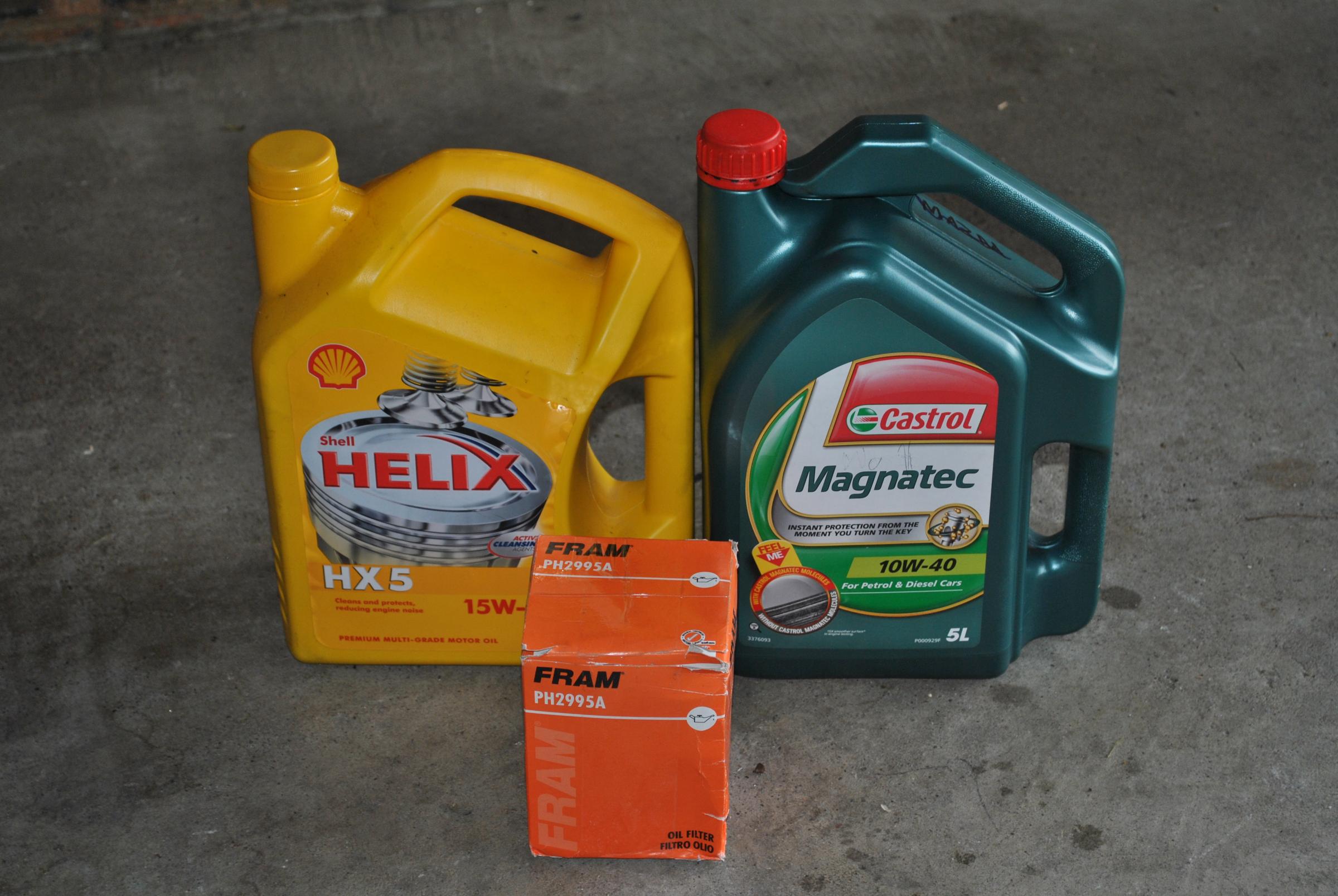

The correct oil for the engine.(and enough to do the job)

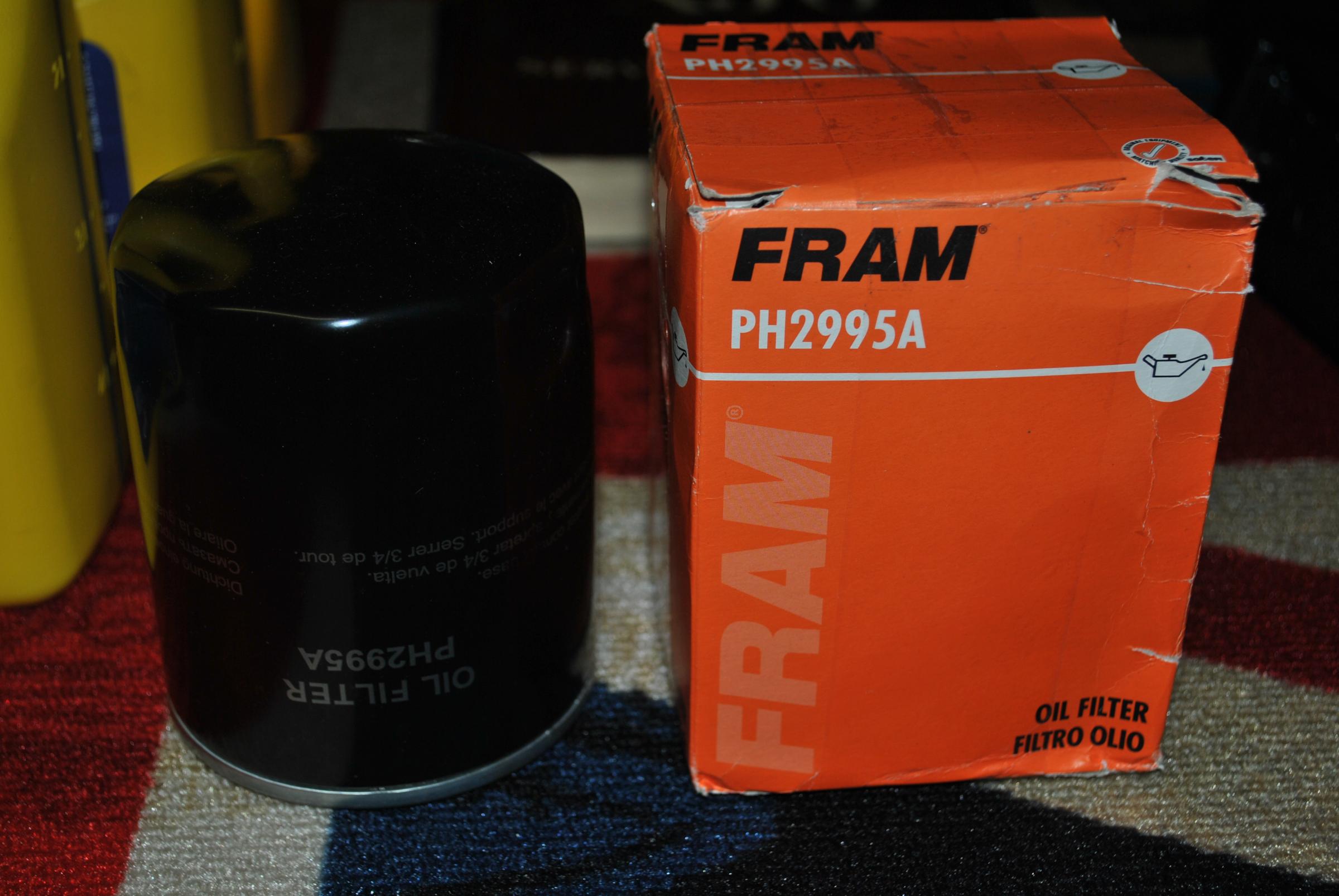

The correct oil filter for the engine.

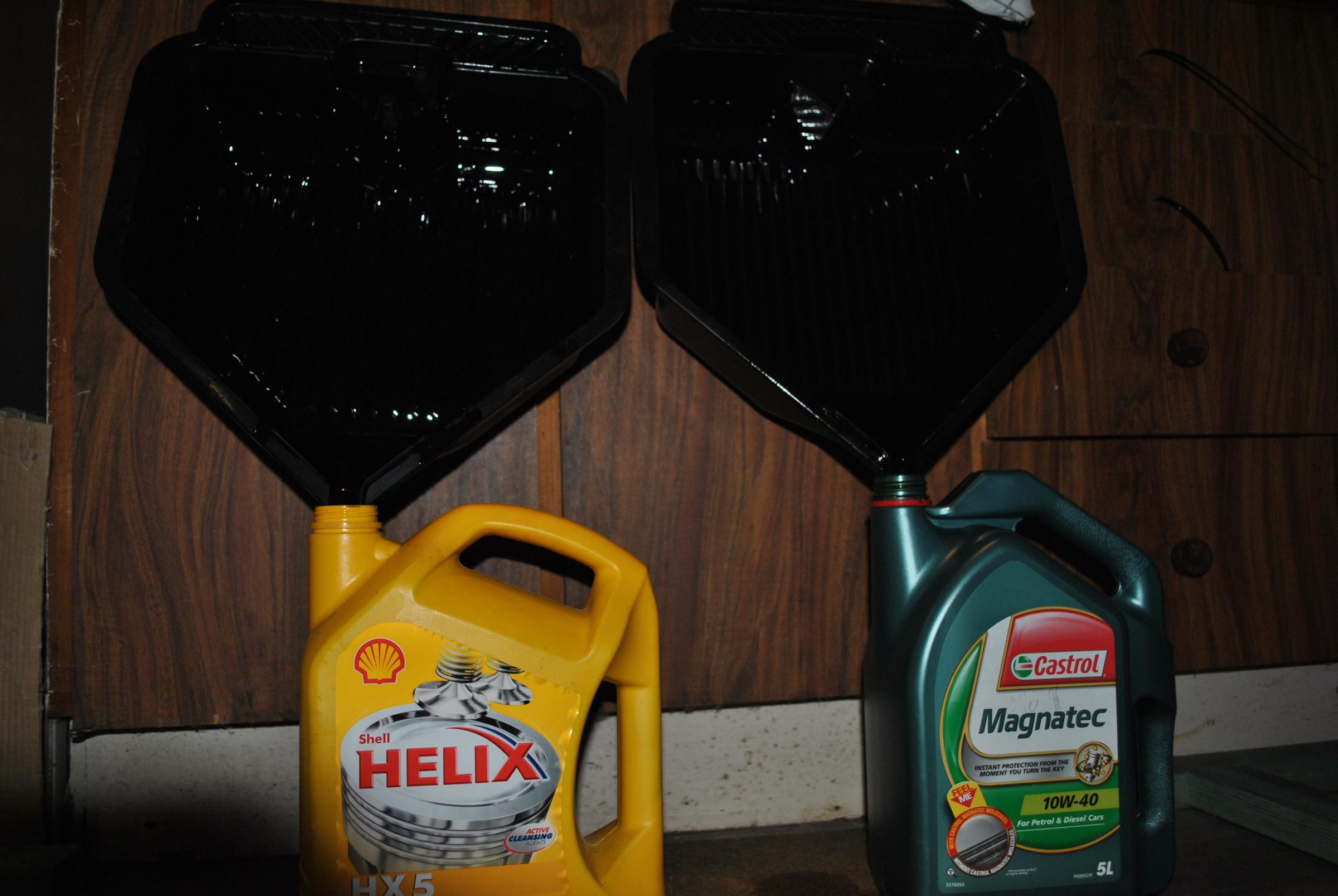

8 litre drain pan(in my case 2 x 5 litre as that is what I have)

Hi Daf, yes mine has an adapter kit fitted so it takes Series II/III or XJS/XJ12 filter. Not sure where you could get the kit but Grant Francis will probably know.
Jagdaim may sell them.
Then your car will take the following filters.
Ryco Z133, $38. Repco or Supercheap Auto (pre order) or $38(free post) on ebay
Jagdaim EBC9658/L $15 + $15.90 Postage
Fram PH2995A $20 + $8.25 postage . Preston Paige Classics(ebay)
Mann W930/13 $32.10 (free post) Micksgarage,Australia. ebay
Coopers Fiamm FT5925 / old Z509A/ Newest part no WZ133 $36.95 (free post)
motoparts_au (ebay)
Baldwin BT634 $19.50 + $7.95 postage. Jag prestige spares (ebay)
Brintech $58.94 + $8.60 postage ,brintech_customs (ebay)
HiFi HO-7801 (is the Jagdaim EBC9658)

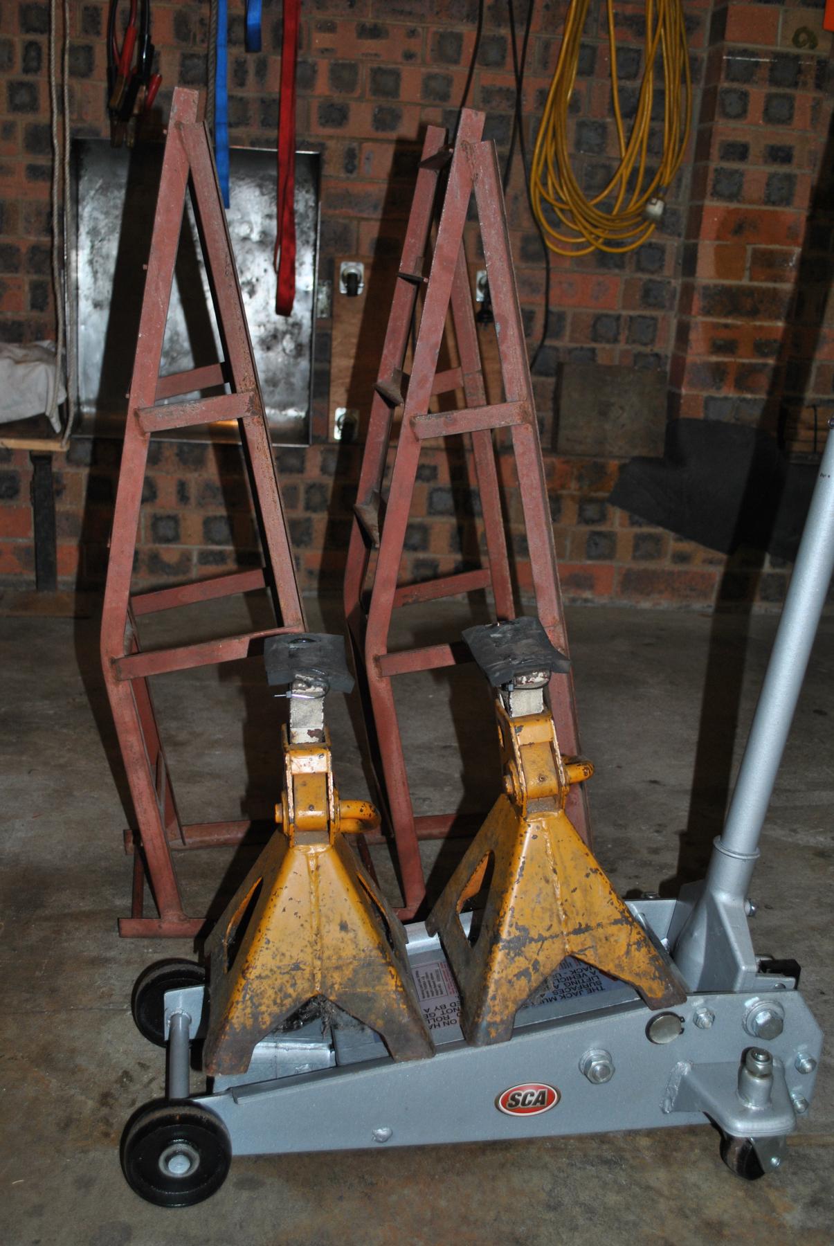

Have your rags handy(not necesary to have them folded),that's just me.

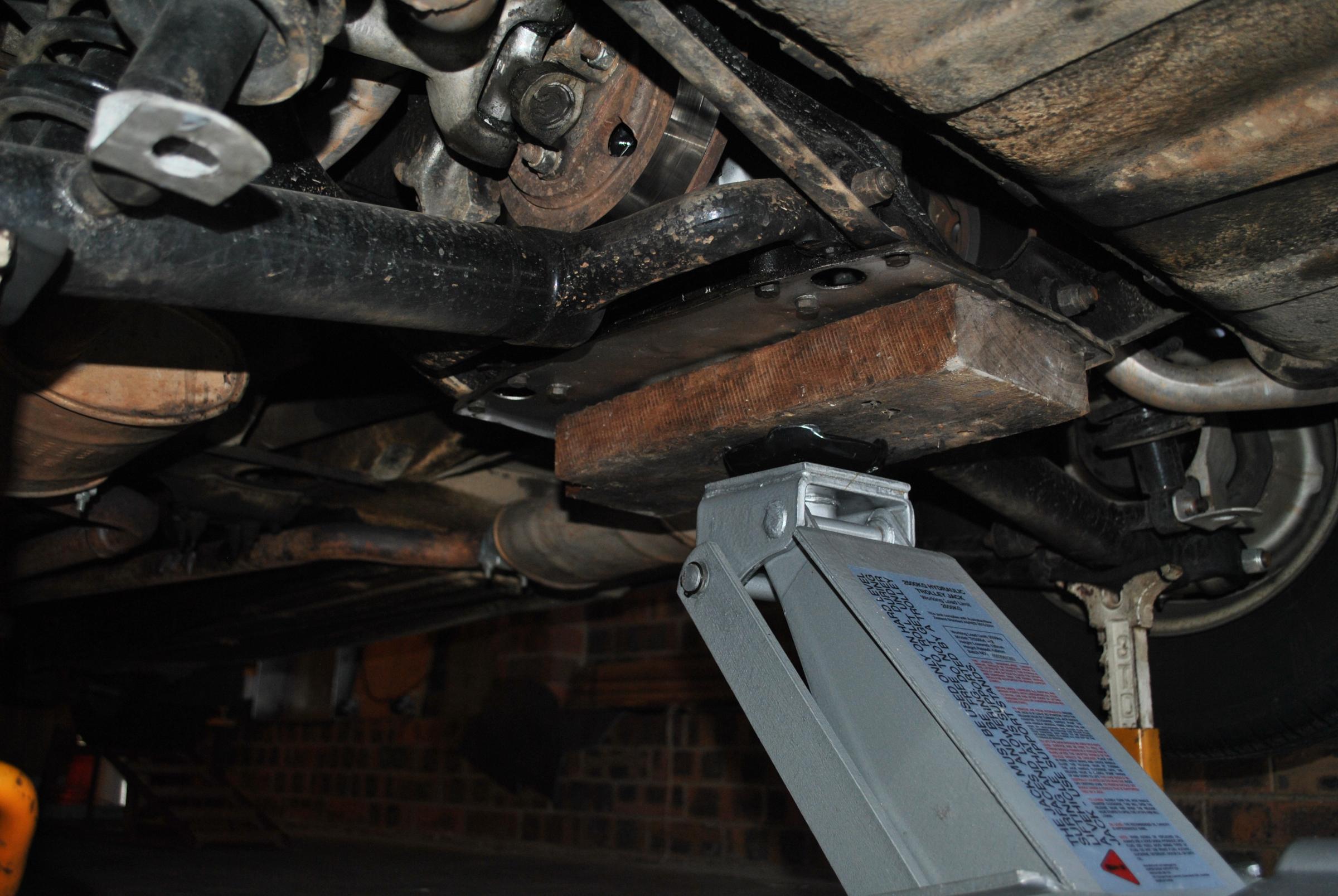

2500 kg jack, a pair of 3000kg axle stands and a pair of ramps.
drive front wheels onto the ramps,and apply hand brake.
Because my jack is too high to fit under the diff once the front of the car is on ramps,I have to jack each side up and place wood blocks under the rear wheels.
Then jack the centre of the car to a level height, I have a hardwood block cut to size to fit the full length of the of the tie plate. Place the axle stands under the wishbones then lower the car into the stands.
XJ6 Oil Change for beginners-dsc_2069.jpgXJ6 Oil Change for beginners-dsc_2070.jpg
Before venturing under the car I grab hold of the rear bumper and give the car a couple of good shoves sideways just to make sure the stands are doing their job.

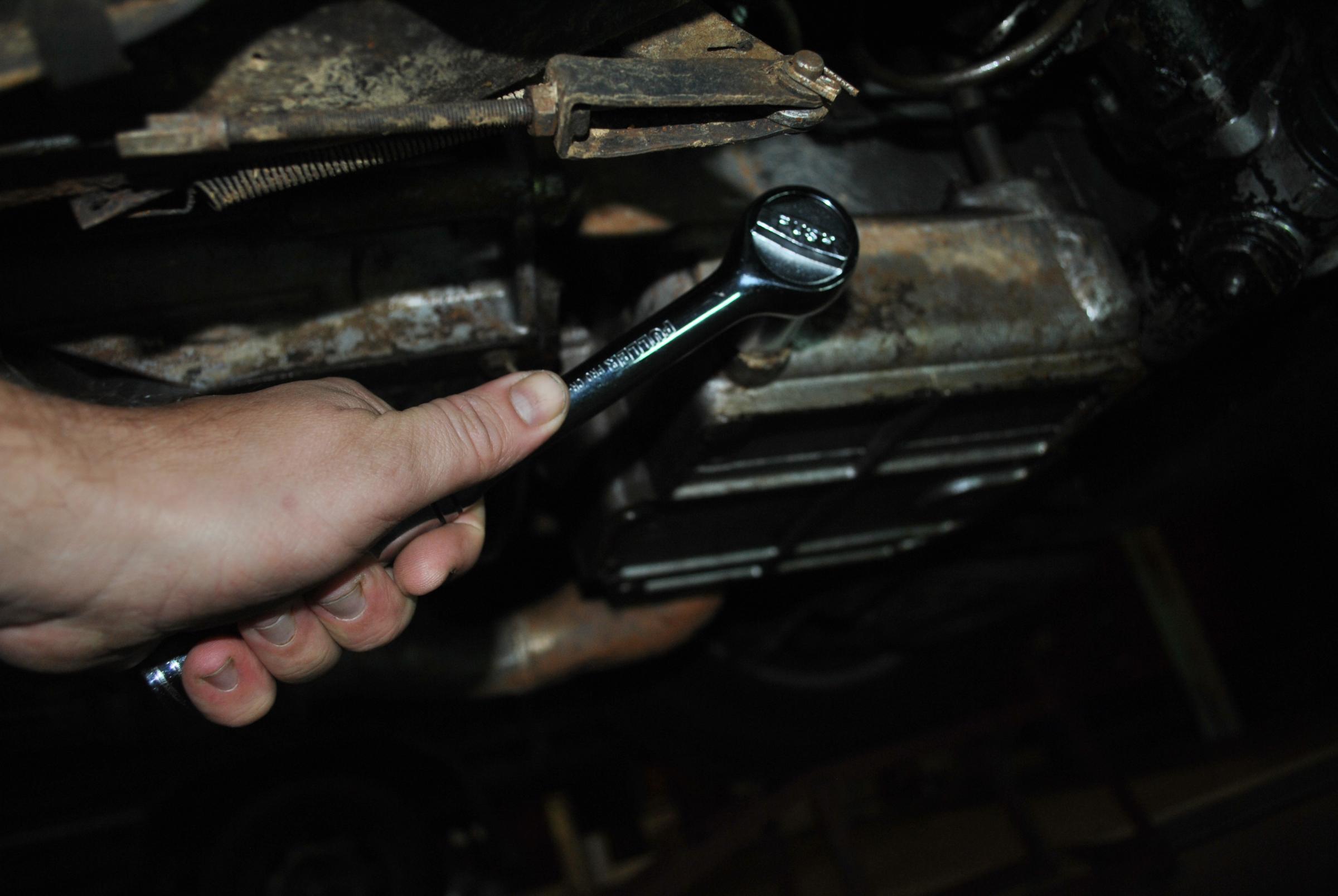

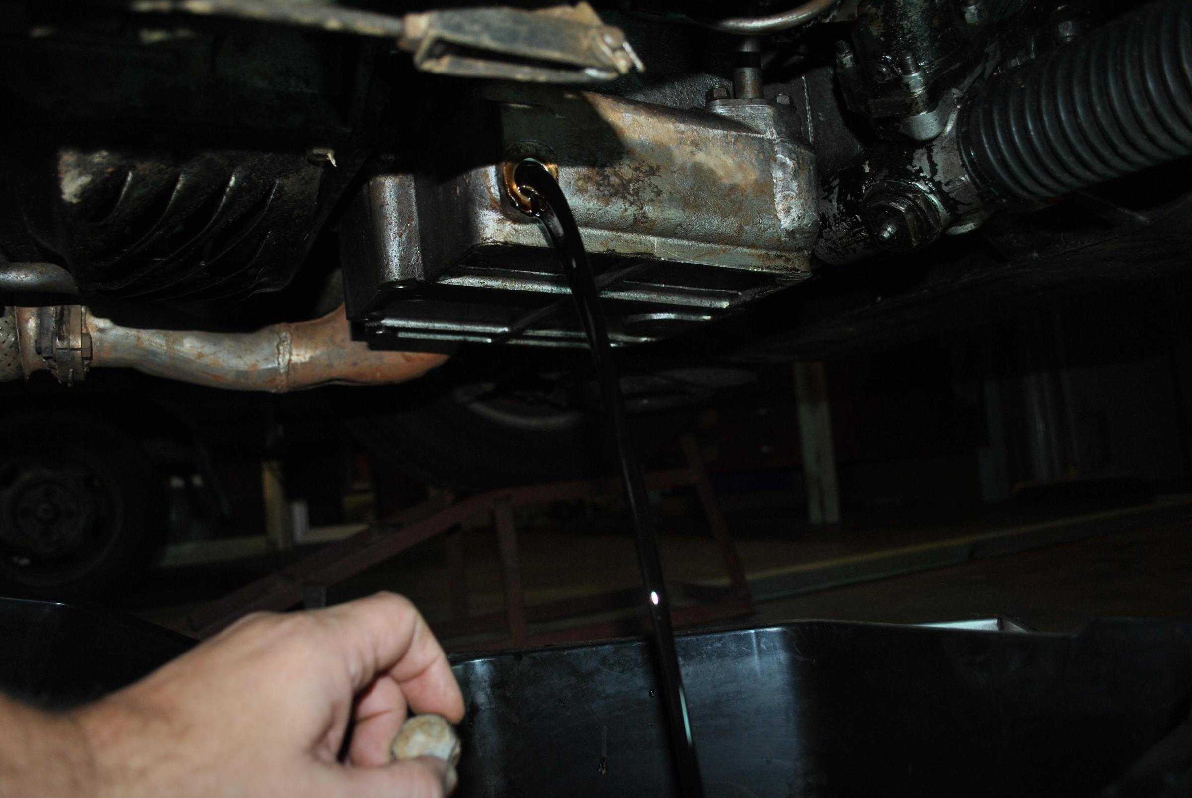

Locate the sump plug at the right rear of the sump, and loosen off with a 7/8 socket or ring spanner.
XJ6 Oil Change for beginners-dsc_2074.jpgXJ6 Oil Change for beginners-dsc_2075.jpgXJ6 Oil Change for beginners-dsc_2076.jpg
Remove sump plug with your fingers , and drain the engine oil into the pan.
Caution: the plug and oil will be hot.

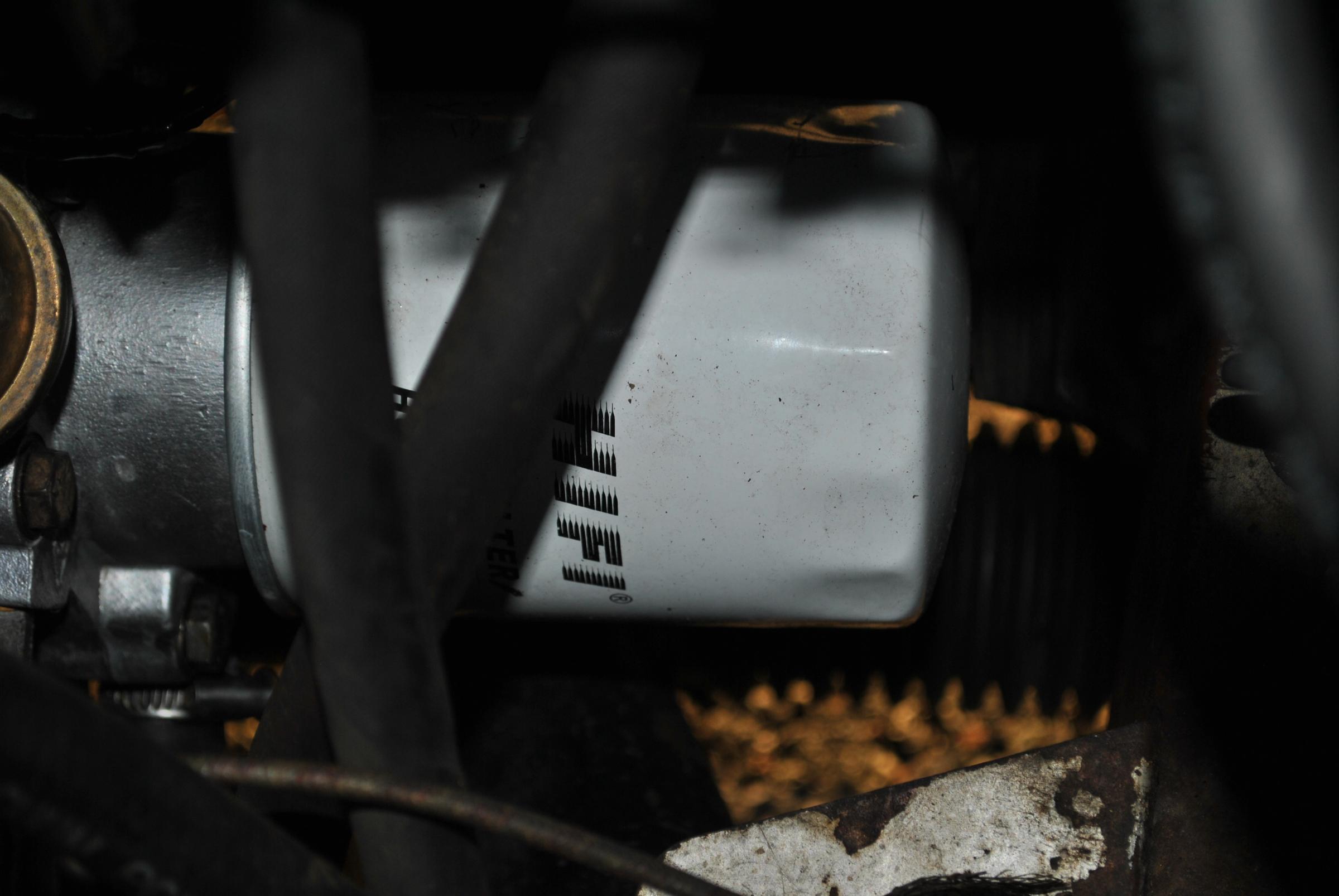

Place some rags under the oil filter before you loosen it to catch any spills when removing the filter. Have a dish ready to put the filter into when you remove it.
XJ6 Oil Change for beginners-dsc_2080.jpgXJ6 Oil Change for beginners-dsc_2084.jpg

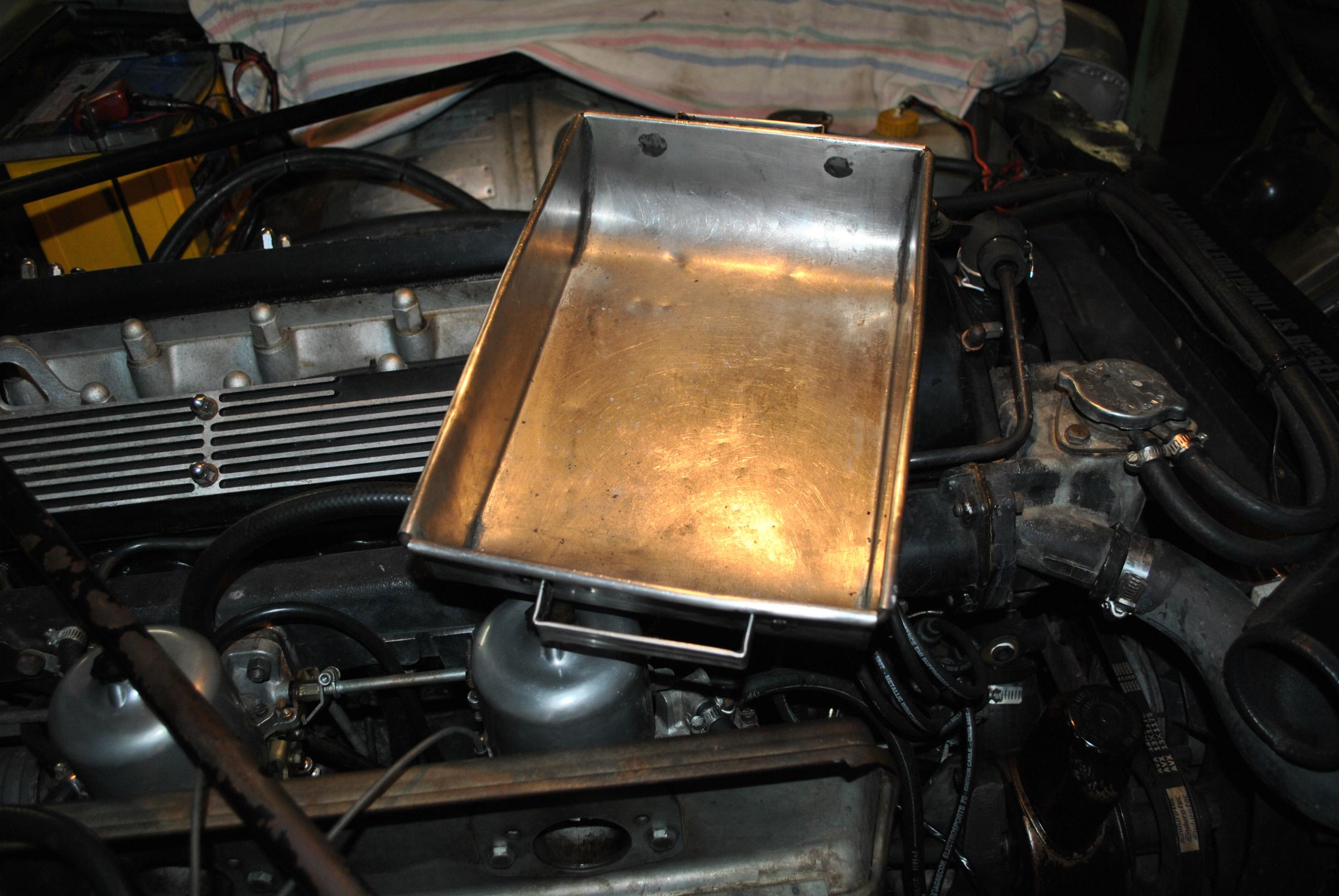

Remove the air filter to allow room to get both hands down below carby's. Use the filter removing tool to loosen the filter.(turnig anti clockwise)
Unscrew the filter with your hands and tilt it downwards to stop the oil running out, then lift it out between the carby's and place in the dish.
Caution: the filter and oil will be hot.

Fit new filter, I do it as tight as I can by hand then just give a light nip up using the filter removing tool. Being carefull not to push too hard risking distorting the filter casing.

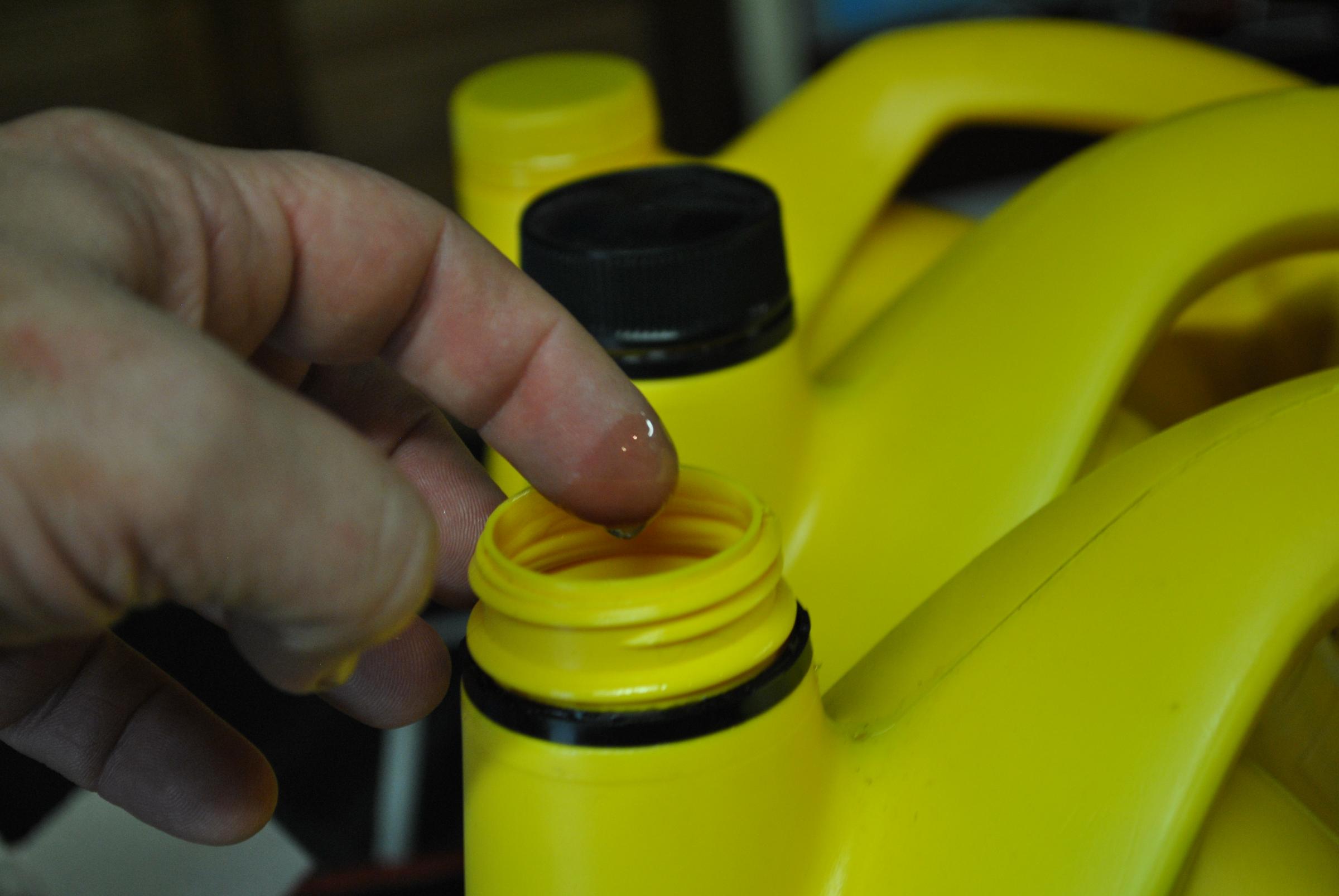

Question:
Do you pre-fill the oil filter? I hear some guys recommend it however some engine bays may prove difficult due to the filters mounted upside down etc.
I think the theory behind it was to have oil in there ready to go on startup. Is this necessary or just overkill?

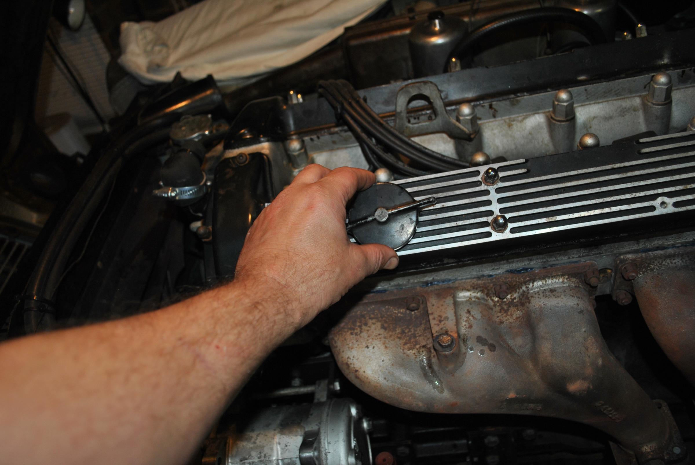

Top up engine with the new oil, the amount you need will be listed in the specs section of your workshop manual.
The 4.2 engine takes 14.5 imperial pints(8.25 litres/17.5 US pints)
I start by adding 75% of the recommended volume (about 6 litres) then replace the filler cap and run the engine for a few minutes then turn it off and let the oil drain back to the sump and check the level on the dipstick.
XJ6 Oil Change for beginners-dsc_2108.jpgXJ6 Oil Change for beginners-dsc_2117.jpgXJ6 Oil Change for beginners-dsc_2110.jpg
Top up as required until the level is right on the dipstick, I add 1 pint at a time(because that is how big my old school oil pourer is). Checking the level each time.
XJ6 Oil Change for beginners-dsc_2105.jpgXJ6 Oil Change for beginners-dsc_2111.jpg
Replace the filler cap again and run the engine for a few more minutes then turn it off and let the oil drain back to the sump for a couple of minutes. Then check the level one last time for peace of mind. Close the bonnet.
Never heard that before, not sure if will make any difference. The oil will be pumped through the engine in a few seconds anyway.

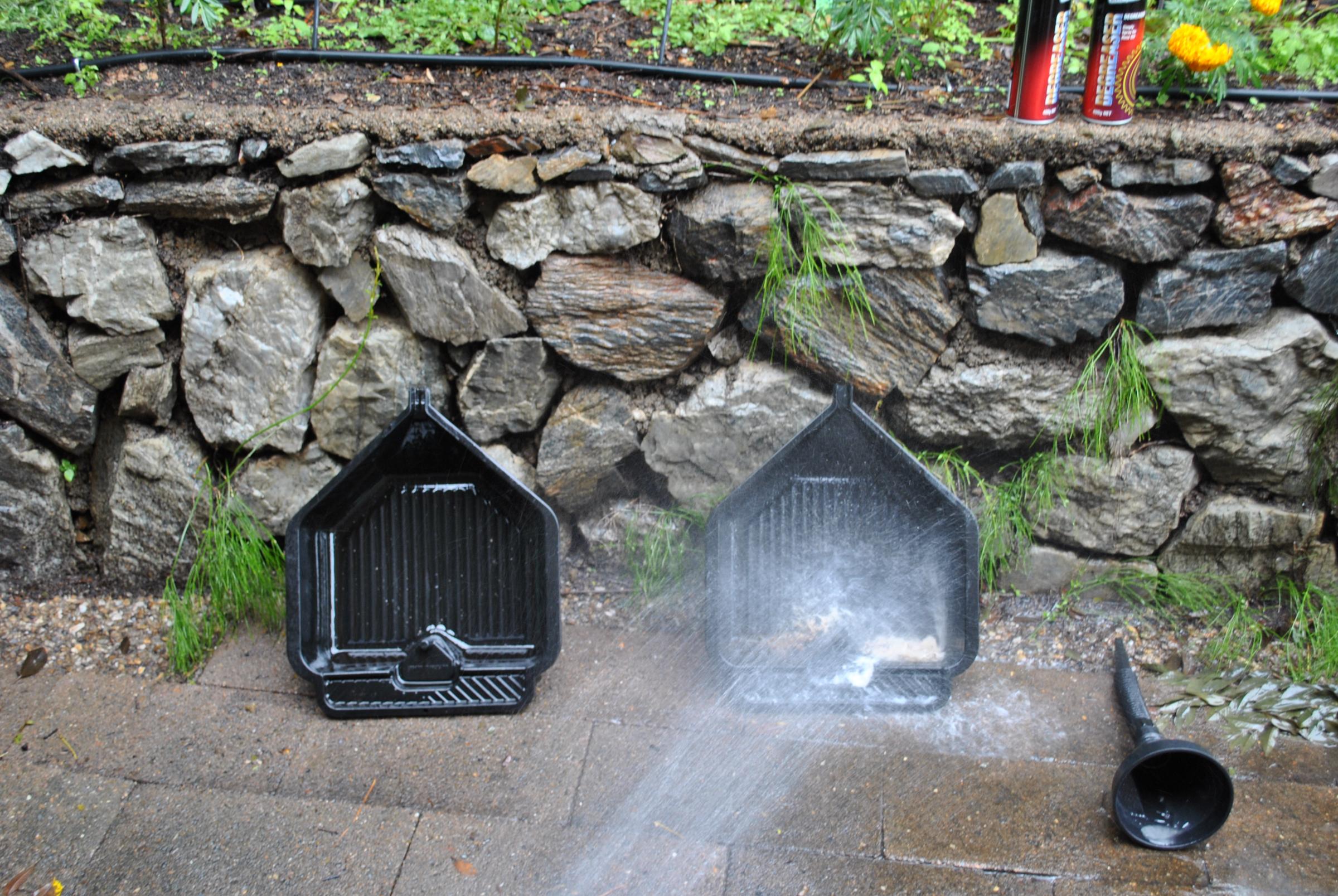

Now it is time to clean up. Degrease the oil spill on the garage floor.
XJ6 Oil Change for beginners-dsc_2139.jpgXJ6 Oil Change for beginners-dsc_2140.jpgXJ6 Oil Change for beginners-dsc_2141.jpgXJ6 Oil Change for beginners-dsc_2145.jpg
Clean up your oil drain pan.

XJ6 Oil Change for beginners-dsc_2146.jpgXJ6 Oil Change for beginners-dsc_2147.jpg
The complete process should take no more than an hour to complete.
