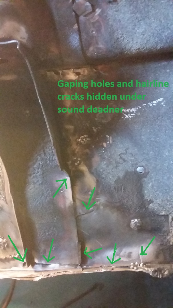

I was preparing the front subframe for painting and i noticed that one engine mount had three hairline cracks in it! I welded these back up but it made me nervous for others who have a 350 in their jags. maybe some washers might help spread the load? That said the engine mounts used in mine were pretty rough, that may have played a role.

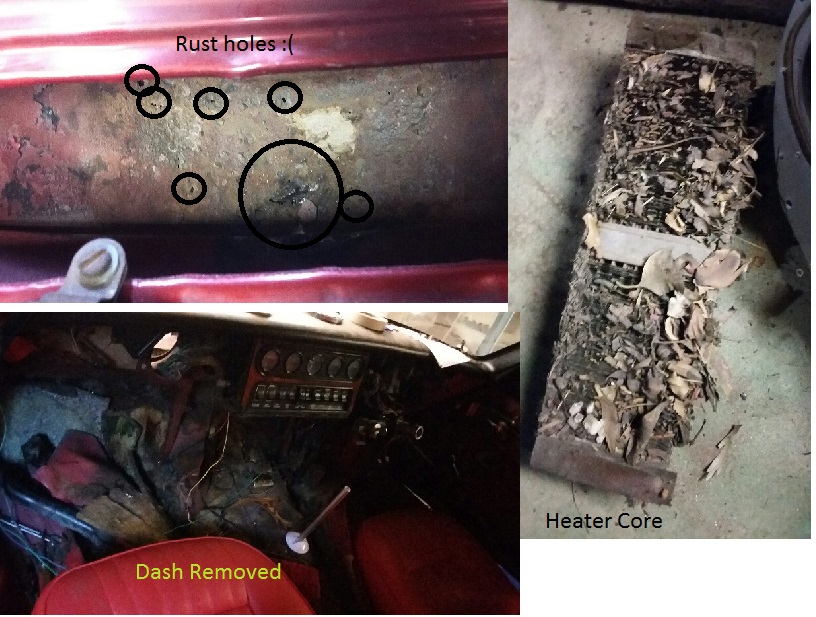

I also found some rust in the area where the spring seats at the top, funnily enough only on one side. None the less i welded the entire seat area and grinded it smooth again with a die grinder, it was a tedious job but after its painted i dont want to have to pull it out again to fix it.

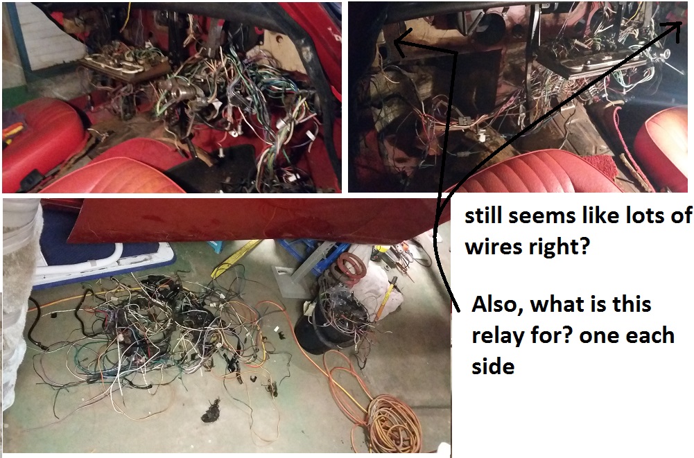

I also tidied up some of the wiring. I'm removing a lot of it to insert and alternate motor and most of it wont be used. Im also changing the guages so really all i need are the wires for the lights, 5 wires, theres an extra one that i think might be for power. although i labelled everything when i removed the 350 chev, many wires werent connect when i got the car and many disappeared into relays which i understand how they work but dont know how to read them to determine their function.
I also removed the dash and the heater core, the air inlet at the centre of the bonnet has rusted out, i need to replace it and i was hoping by removing the dash i could find an easy-ish option to access it. nope. I have to hack out several bits from the engine bay or the dash in order to replace it. I may end up welding up the 20-30 holes ranging in size from 2mm to 15mm in diametre rather than replacing the hole sheet.
the air vents were feral, if youre a germ-o-phobe dont look at them or you'll find yourself pulling your dash apart.

The heater matrix/core is far more buried in a S1 than your later Jaguar... Note the photos... it was the worst job I have done to any car. It fits
where those two holes are in the second photo... you can see the one fan squirrel cage in the RH top of the first photo for reference where
the heater matrix is located... BURIED... the joke is they laid in the heater matrix/core and wrapped the car around in it!
Plus, they are NLA new and I had to have mine welded/pressure tested at a local radiator shop.

I got rid of more wires.
I'm updating the gauges so all of those wires were removed. I also removed the 'rear window' button wires, presumably for a demister i dont have and the tank switch.
There still seems to be a lot there in order to drive some lights and a horn.

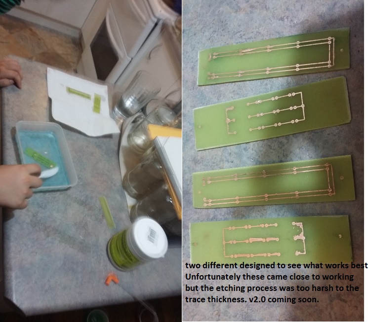

Another new skill i'm learning for kicks is making my own circuit boards. The reverse lights are like a dim candle in a strong wind. I'm having a crack at making some hardcore LEDs that fit within the standard light. no luck yet, but edging closer.
They also sell them dirt cheap in Harbour feight, if nothing else you can wander in & see how they are put together, very simple build & no more mess or dust to breathe.
I have been making my own custom PCB's for decades (I own a recording studio & vintage amp repair is one of the staple services)
The hardest part for sure is drilling the holes, I have a (diy) CNC milling machine that I use for it now, but before that I was going through those tiny carbide drills like crazy. My drill press wasn't amazing at the time, but still scary when they brake. Wear all the protection you can, a 0.8mm drill bit through the cheek smarts something awful.
(Btw. They sell LED bulbs off the shelf that should fit right in, but where is the fun in that)

Neuro, the drilling does seem like a difficult part, i was considering putting my drill bit in my dremel if i didnt have any luck with the regular drill. I sold my drill press, regretting that now :/ I certainly need some form of sandblasting box, i'm looking for a second hand one but for irregular use i'm not sure i want it taking up the space!

like rustNeuro, the drilling does seem like a difficult part, i was considering putting my drill bit in my dremel if i didnt have any luck with the regular drill. I sold my drill press, regretting that now :/ I certainly need some form of sandblasting box, i'm looking for a second hand one but for irregular use i'm not sure i want it taking up the space!
