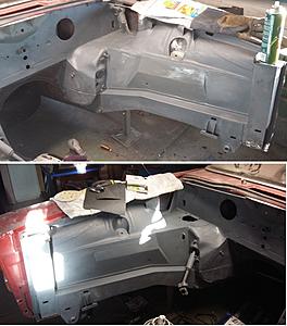

Some minor progress, I was not happy with the front cross member having some previous accident damage, It was not really visible inside the engine bay but the wheel well, minor but I want this car to be great so I made a new one cross member. Its out of thicker steel and welded attached in more places so will provide more structural support than original.
The engine bay is also completely repaired and waiting paint.

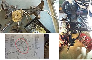

I dropped off the front suspension for new powder coating, its all shiney and black and beautiful! Its almost a shame to put it back in the car. Now I’m part way through replacing all the rubber bushings with polyurethane and new ball joints and bearings. The brake discs are below spec so ive ordered some sporty slotted discs which will look fantastic and stop better too. Funnily while putting the front end back together I misplaced a bump stop, I spent an hour looking for it and had resigned myself to cleaning up to try and find it when I thought I would just buy a new one, but ouch, $60! Saves cleaning though, then lo and behold, after getting off the phone I walked back into the garage, moved the other brake disc and what should appear, the missing bump stop! Thanks Doug from JagDaim for cancelling that, man did I feel like a fool, good thing only we know . Now, save for the bump stops which are just fine, everything on the front suspension has been repainted, replaced and is brand new! I put every nut and bolt and bracket in its own labelled bag and putting it back together has been a breeze as a result. The observant among you will see the wheel hub is back to front, minor mistake but I was reading the manual!

I've ordered some new discs for the front and thanks to some help from Doug at Jagdaim i've going to be finishing rebuilding the suspension this week hopefully!
