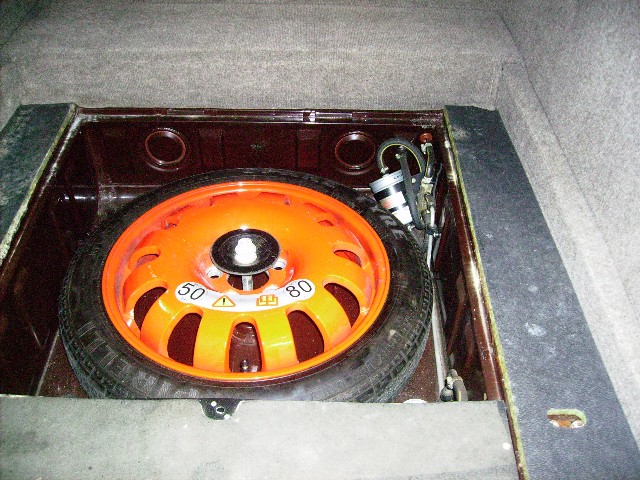

Well I have had a close look and can't find a decent filter anywhere under the engine bay or elsewhere.
The car was fully reconstructed by Caulfield Jaguar in Melbourne 12 years and looks to me like they removed the bracket for the large/standard filter at the front R side of the spare wheel well. See pic for visual on what is there instead.
I plan to get a bracket and fit it back to original with a new filter.
Sincere thanks to all for your great assistance!

here's a pic showing where mine is in my 1984
