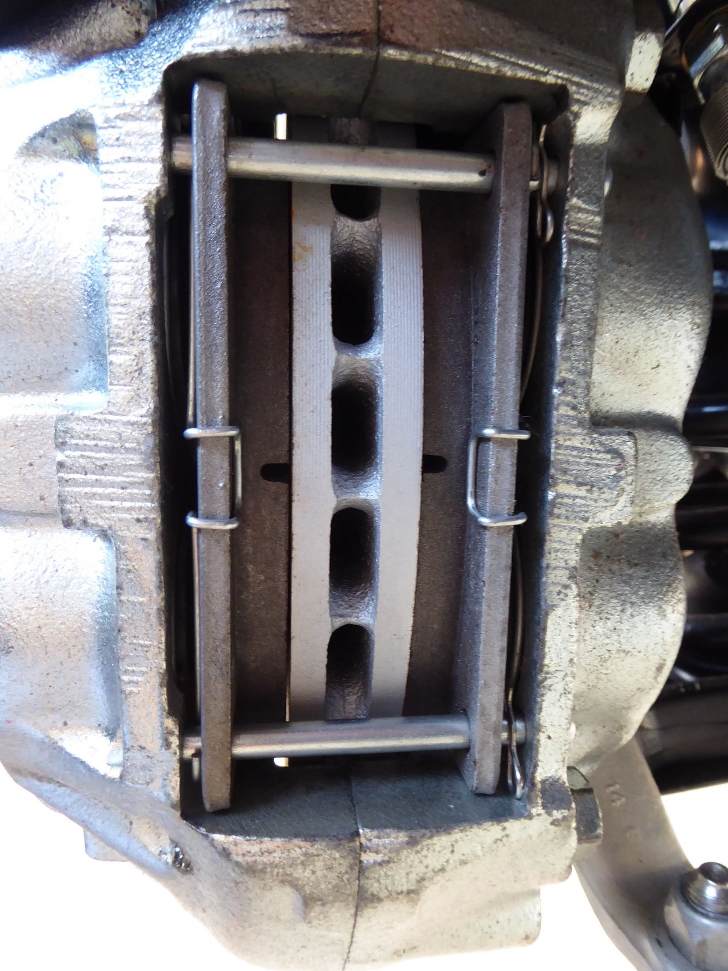

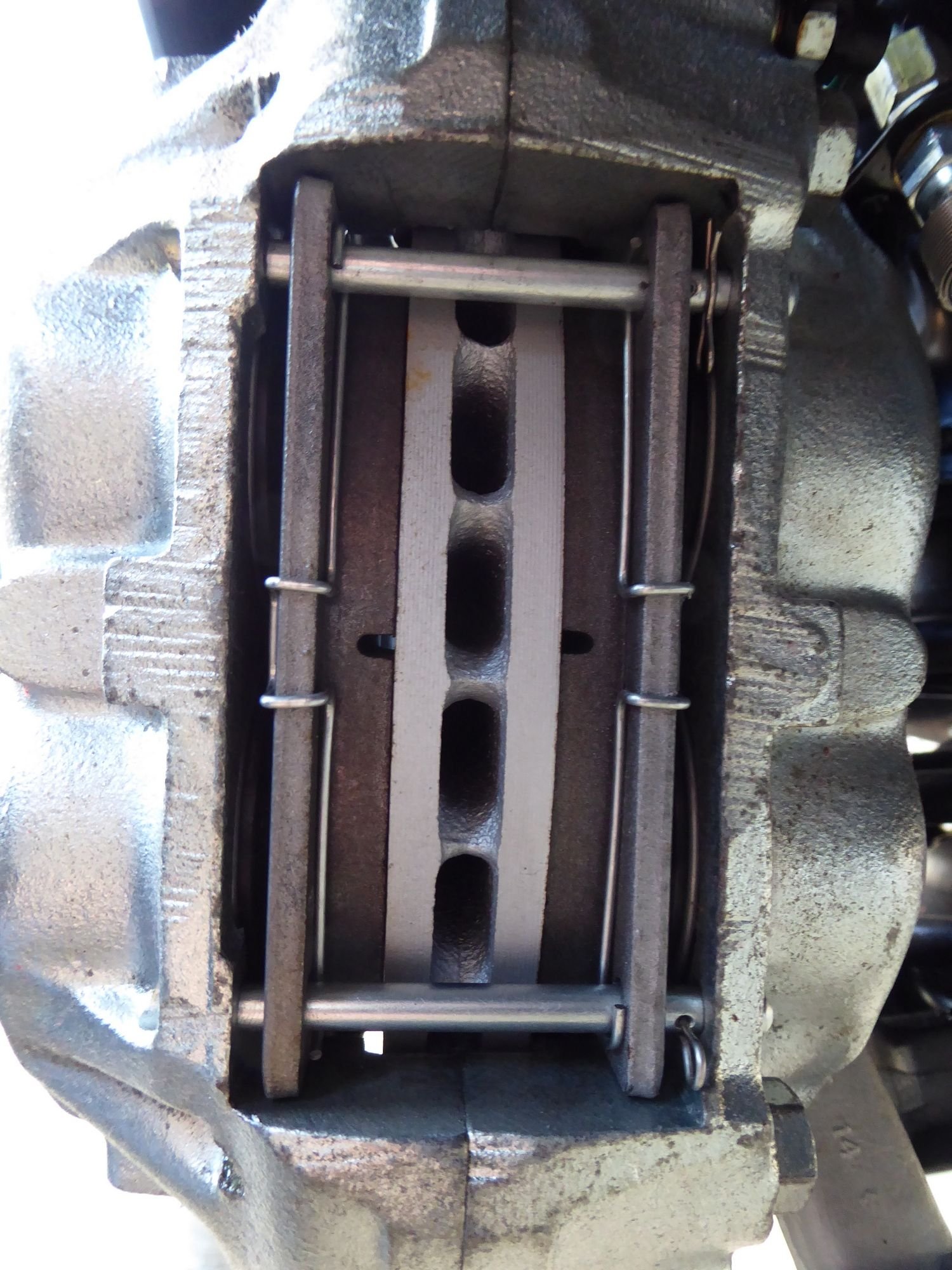

I came up with a question for everyone while installing my new front brake pad hardware. Are the spring clips ( anti rattle ? ) that are held by the pad pins supposed to go on the inside or outside of the pad ? I'm pretty sure they go on the inside but the parts & ROM manuals don't really show it clearly. Probably does not matter but here are pictures showing them both ways.
Springs to outside
Springs to inside

They should go on the inside, here's a picture of mine with the springs in original position.
Dave
