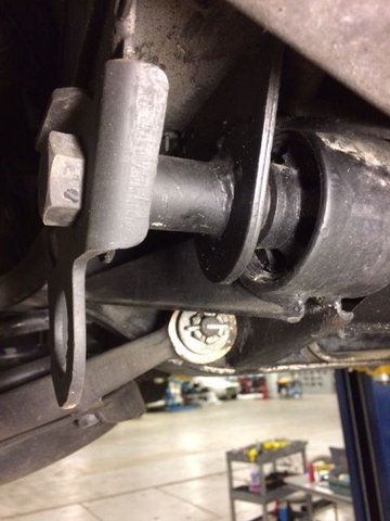

The six-shooter bushings are #10 in the illustration below. A giant bolt runs thru 'em.
A spacer (#13) establishes a gap between the subframe and the tie-down plate (#15). The bolt goes thru the spacer as you can see.
Put your jackstand under the spacer. The jaw of the jackstand (mine, at least) allows the spacer to drop into place nicely and is securely captured between the subframe and the tie-down plate.

Just to add some visuals.....
First pic shows the biggie bolt and sleeve betwixt the tie-down bracket and the six-shoot bushing. Second pic shows the same parts engaged with the jaw of the jackstand

Just a word of caution, Doug's jackstand position is great, as the chassis, not the actual subframe 6 shot extension is taking the weight. If you place the stand under the actual subframe extension itself, it will very likely bend.
