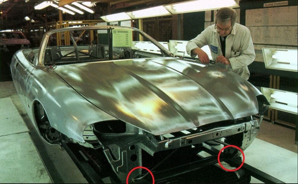

Absolutely do not jack the front Aluminium sub-frame as this will put tension on the Vee-mounts and potentially de-bond their Rubber-to-Metal construction. Vee-mounts are designed for compression to support engine load, so you will be damaging the Vee-mounts and trying to lift the engine.
The Manual suggests front jacking under the cross-beam beneath the Radiator (shown below and ref yellow circle location). However, as the car ages and corrodes, this cross-beam becomes weaker and risky.
When you look at the vehicle construction, the strongest body areas are the box sections at each end of the cross-beam (see red circles). When I jack my car, I use a wooden plank to bridge across the red circles and reinforce the cross beam (same as recommended by Jon89 and sklimii). I will admit that I have also modified my plank with clearance to protect the small rubber strip.
