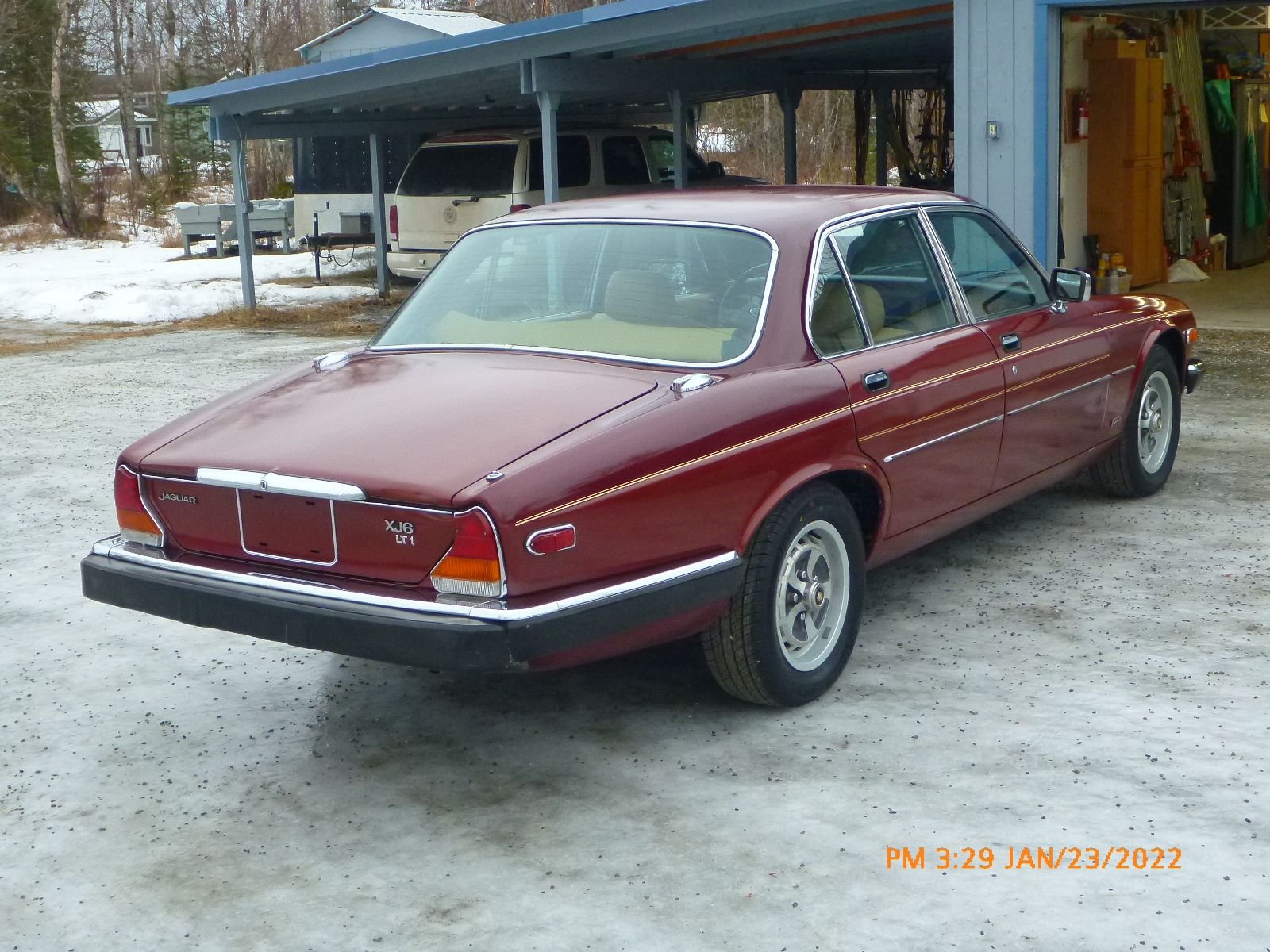

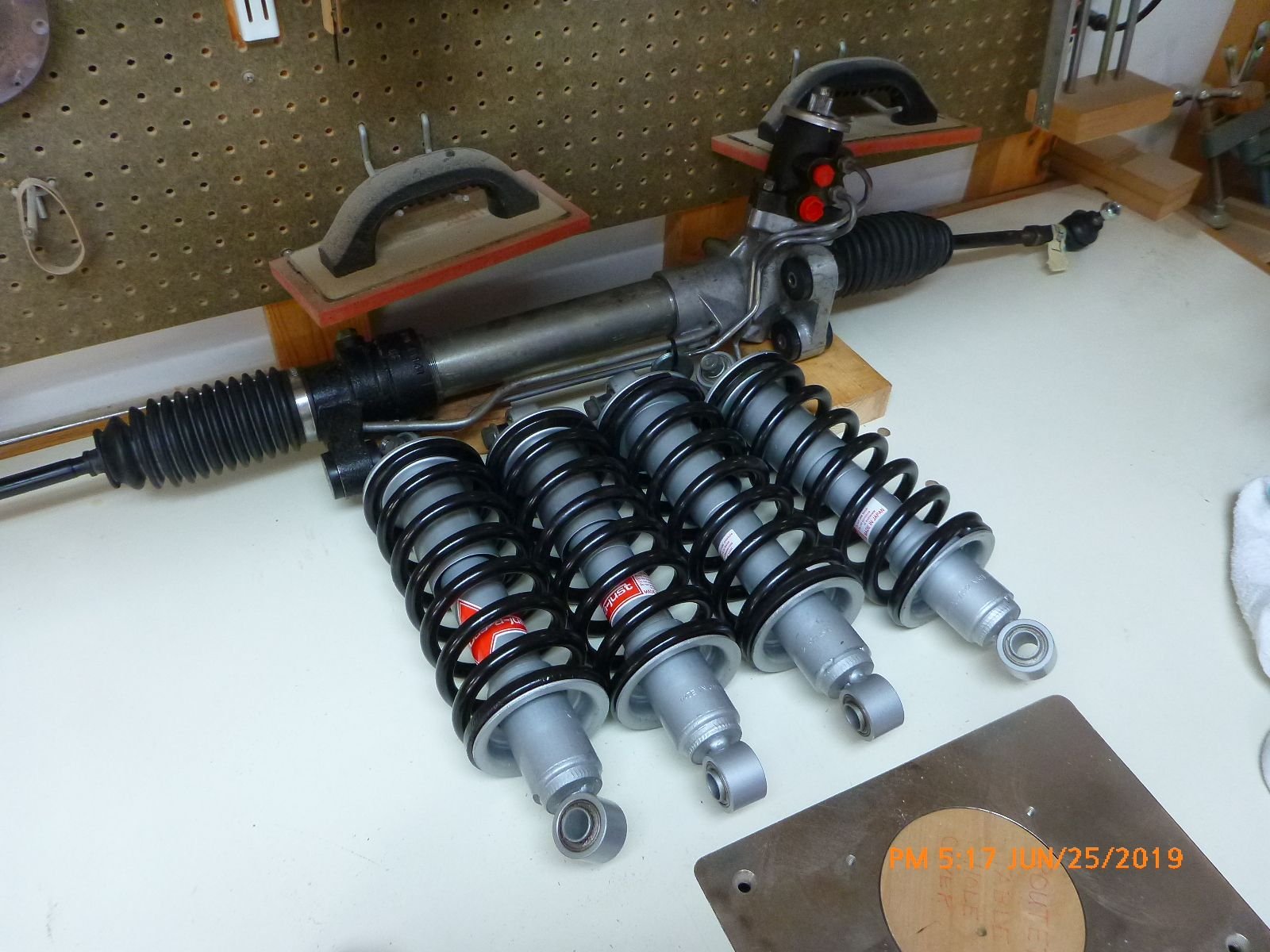

Devo,
Here's a picture of my KYB shocks, the spring collar looks to be in same position. There weren't optional positions on mine.
Dave

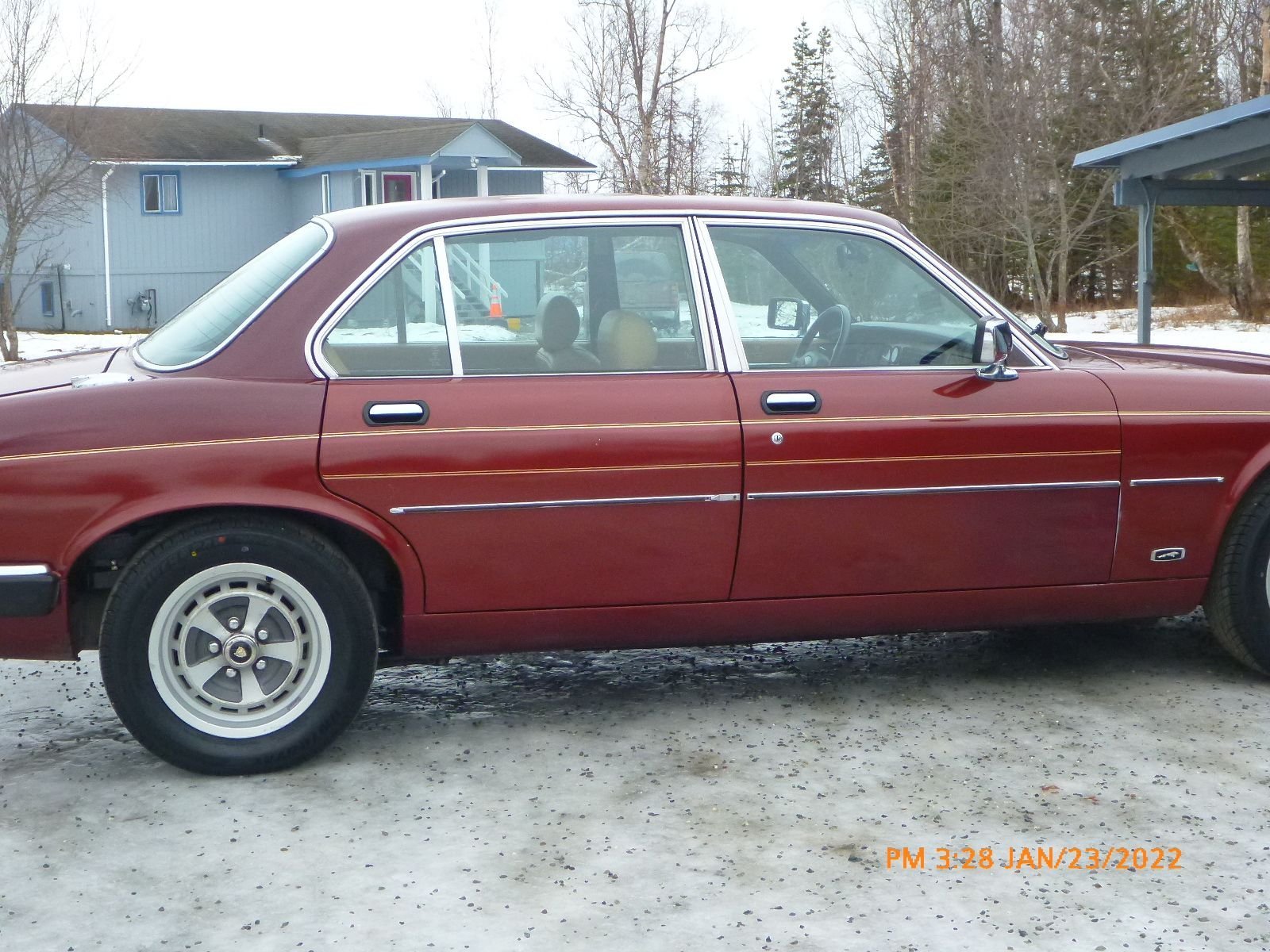

Here's a pic of mine with KYB'S all around, it sits about right for me as I want to keep it stock looking. Greg is right about different manufacturers could get the fixing point on their shocks slightly different than Jaguar. Another possibility might be the influence of the gas pressure in the shock. If you've ever installed gas shocks, you remember how hard it was to compress them enough to fit. I'm going to guess the gas pressure is pushing 20# or more, and there are 4 of them in the rear, 80# of lift might affect the ride height a little.
Dave

It looks like you have the incorrect lower shock spring perches. Try cleaning them and see if they are silver or black. They KYB ones appear and are painted clean silver exactly like the shock. Yours appear old and full of crud as if they've been reused from the older shock that has a different design.
BTW... The Aston Marton DB7 Vantage v12 used the Jag IRS and came with Bilstein shocks that did have 3 grooves so you could move the snap-ring that held the lower spring perch into three different positions. This feature never appeared on a Jaguar AFAIK.
