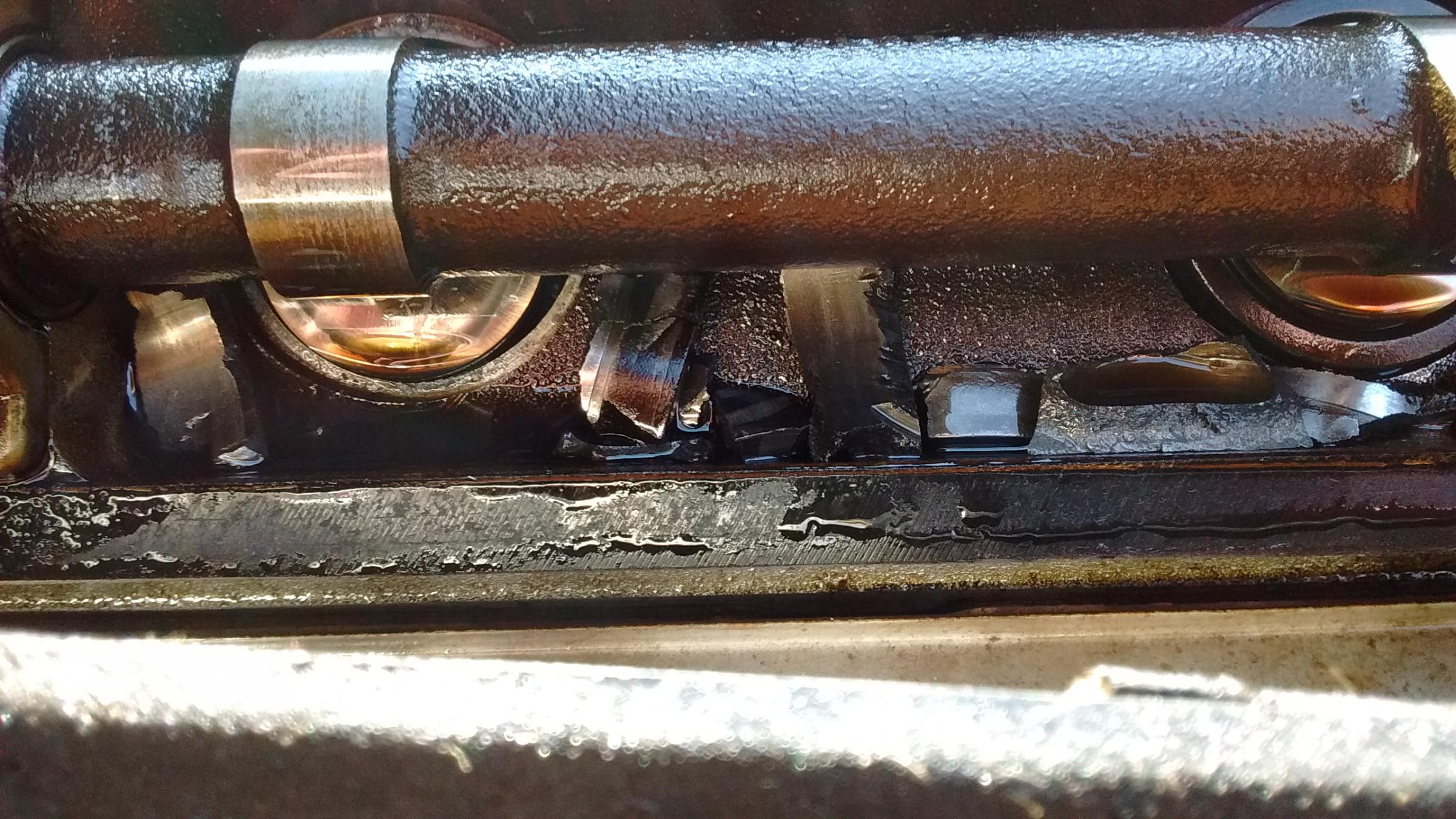

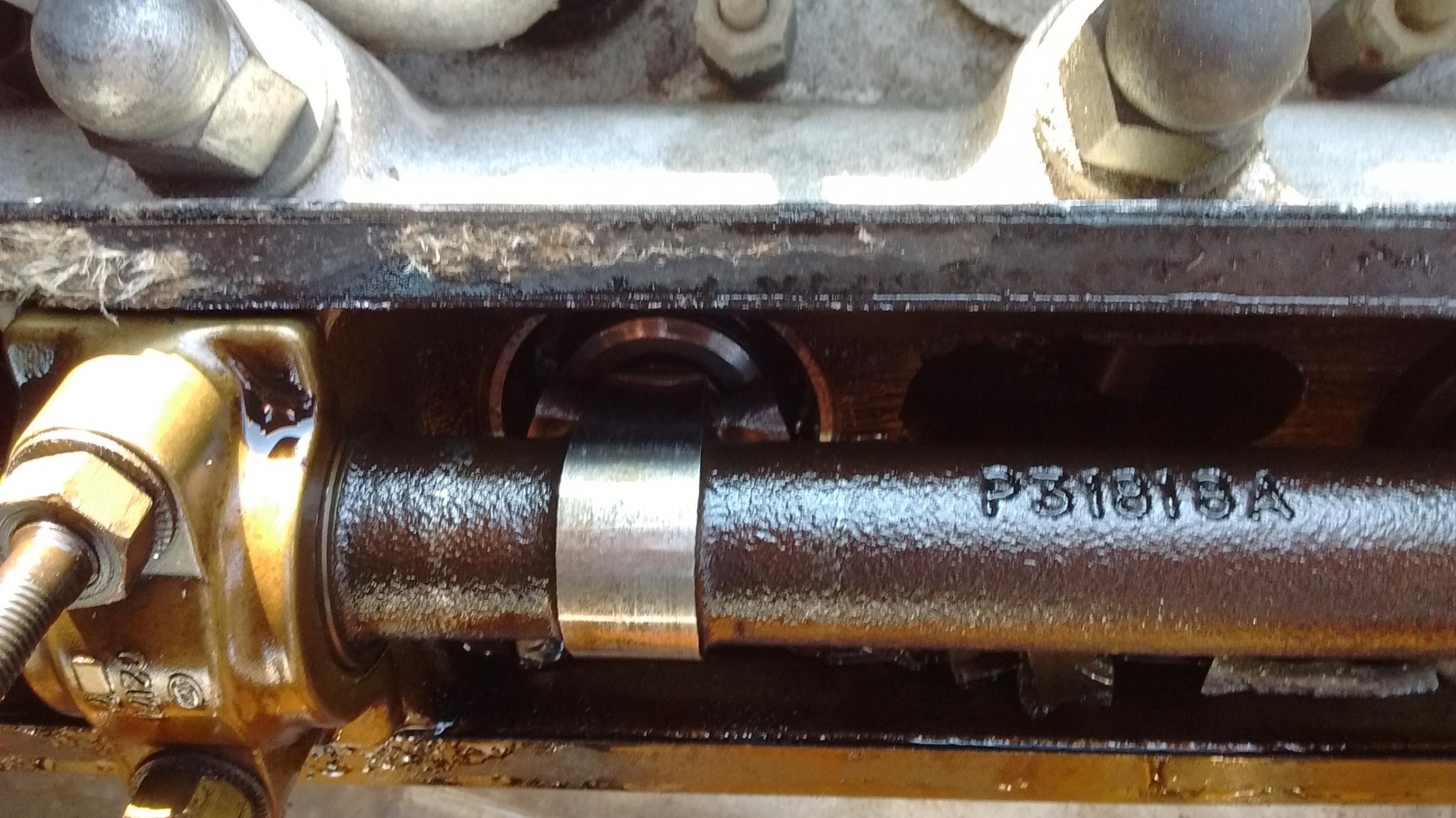

Well, opened it up today. it was definitely the tappet, cam follower which ever name is used as I have found it under both. seems to have exploded into tiny pieces, Been calling all the parts houses, but as I figured no one has it so ordering it from my trusted shop tomorrow and then begin the long and enjoyable job of getting the valve and clearing any and all debris from the the head.

ouch! vacuum the area before removing anything, you don't want any metal particles going inside.
hopefully you can make the repair without removing the head. Don't know if that will be possible.
