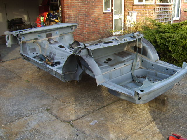

I don't think, however, that the 308 has a chassis as such. The body shell IS the chassis, rolling on a front and rear subframe.
I would be very surprised if there is a detachable chassis. Look at the pic below. I think that is the chassis:

"I don't think, however, that the 308 has a chassis as such. The body shell IS the chassis, rolling on a front and rear subframe."
Yes you are correct, its a monocoque construction meaning no separate chassis as such so i would imagine if you hack away the floor/ chassis rails etc without proper bracing the top half would just fall apart. That pic is i believe an x350 not 308 but it does demonstrate the monocoque construction perfectly.

Here the pics of a separated x308 chassis, shortend it will go unter a XJC.
