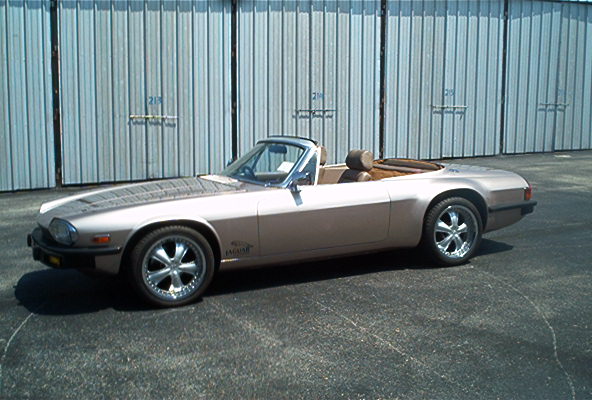

HI,35,
this car is for sale ,and very rare, one of a kind.
Attached Thumbnails 00 82 XJS V12 Candidate 50k Miles-jag-rodstr-016.jpg   00 82 XJS V12 Candidate 50k Miles-jag-rodstr-006.jpg
