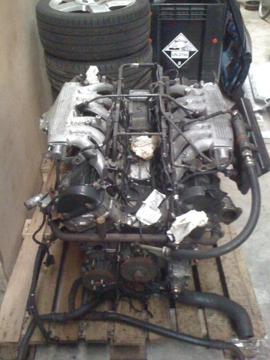

Dear All,
I have to start some where. This is my replacement V12 5.3L HE out of a xj12. don 75.000 Miles. All electronics need to be swopped with my old engine.
I'm thinking of replacing all sensors and coolant thermostats. keep you updated.

Old Jan 13, 2011 | 05:11 PM
rocketlift's Avatar
Posts: 36
From: Herts, England.
Looks like a great project you got there Frederik. I can't wait to see how you get on!
