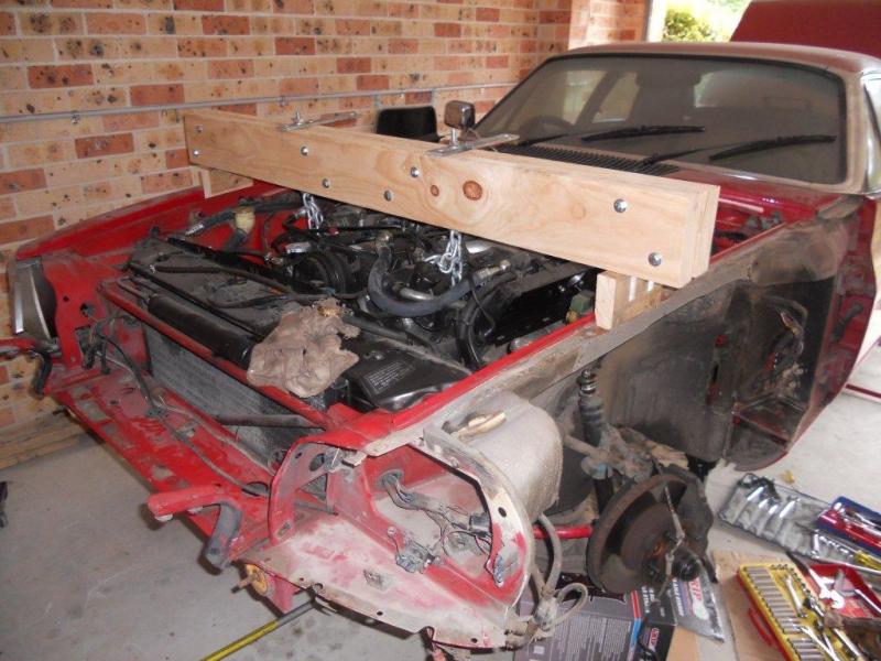

To remove the box, I suggest this general procedure: first support the engine across the V by the rear lifting eyes using chains, threaded rod to tighten them and a beam across the engine resting in the wing (fender) gutters.Greg
Like this
Attached Thumbnails *pagin warjon and ronbros* transmission RR.-dscn0404.jpg
