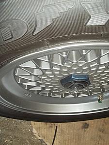

I FITTED 7" front and 8" rears lattice some time back they are RW MACHO
better quality that the fondmetal versions imo both have 22 written after the size markings
Attached Thumbnails -100_7968.jpg   -100_7969.jpg   -100_7970.jpg   -100_7971.jpg   -100_7972.jpg
Where did you get them from? Did you have to buy two sets? If so have you a set left over lol
I bought them in the 90s from an ad in jaguar world, just a full set of 4, I have a space saver as a spare but that will only be suitable for the front as its slightly bigger diam. than the rears.
