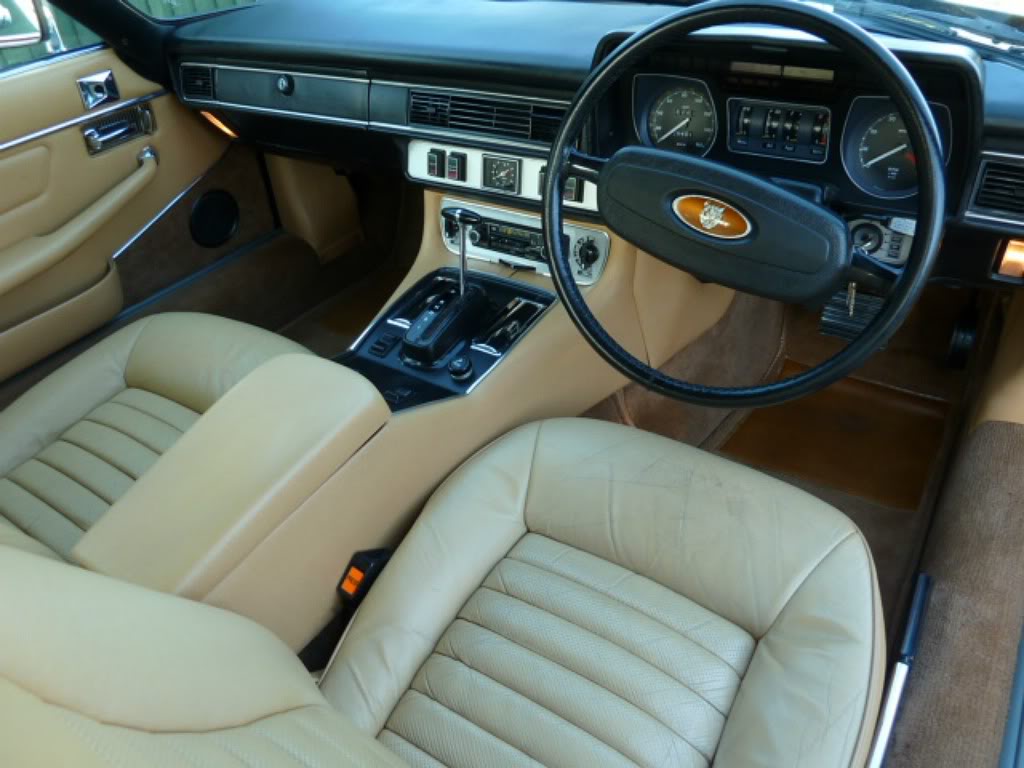

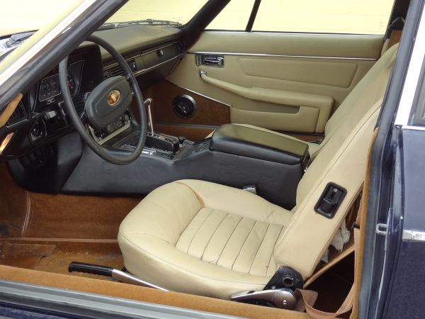

Is $1900 a decent price for this 1976 XJS? Please forgive how new I am to the world of Jaguars, but after years of admiring every XJS we'd see, my wife is finally cool with me getting one. I would really appreciate any advice concerning this Jag. The guy selling it says it's on consignment and doesn't know anything more about other than the few times he's driven it, he said it felt good.. (not worth much) He sent me all these pictures so I thought maybe some of you veterans could help me out. I know it's an automatic, and I'm hearing about this sluggish Borg Warner box.. Can anyone offer any advice? Here are the pics he sent me..

If it runs good and there is no rust you are probably ok. Just be aware that you need do read "The Book" and do all the maintenance that has been skipped. Most likely the maintenance is not up to date nor have some common ailments been dealt with. Buy it and immediately do the most important items. Then slowly work through the rest.

It looks very nice indeed. Problem is, as everyone else has said, RUST. As well as any obvious rust (eg under front windscreen on the valance between the screen and the bonnet, ie hood), you have to look at the car carefully, in these places at least, and probe very hard with a screwdriver:
Under front carpets, and the back carpets
All round the rear wheelarches
Between front wheel arches and doors
Both ends of the sills
At the rear underneath, level with the front of the rear wheelarch, where the arm coming forwards from the rear axle joins the bodywork - all round this area on the horiziontal and vertical surfaces
Under the boot (trunk) carpet and right at the edge of the boot outboard of the exhaust tunnels
Under the radiator there is a structural member across the car that is notorious for disappearing.
Top of the join between the front wings and the engine bay (bonnet up)
Around the outside of the rear screen
If all this is OK, then you need to know what has been maintained, if anything. If nothing much, this is what you will have to do, as a minimum, to get the car as a reliable and good driver:
Change all shocks
Change all rubber bushes, ball joints, and rubber blocks throughout the suspension and steering of the car, front and back
Clean up as many loom connections and earths as you can find
Probably update the ignition spark box as the OPUS system on the car is bound to be going home (REOPUS is the most popular over here)
Change all oils and filters
Renew tyres
Fix aircon, maybe
Clean up radiator fins and remove debris between the radiator stacks
Check and renew brake calipers and brake pads as required.
The good news is that XJS parts are not expensive and are easily available. Over this side, XJS parts are less expensive than parts for modern mass-produced cars like Fords. If you do all these jobs yourself, the parts costs of all this will be much less than you paid for the car, and at the end you will have a very nice vehicle. If you do not do the jobs yourself, it will be very very much more expensive, and 90% chance of never being properly either.
Just my opinion, hope it helps
Greg

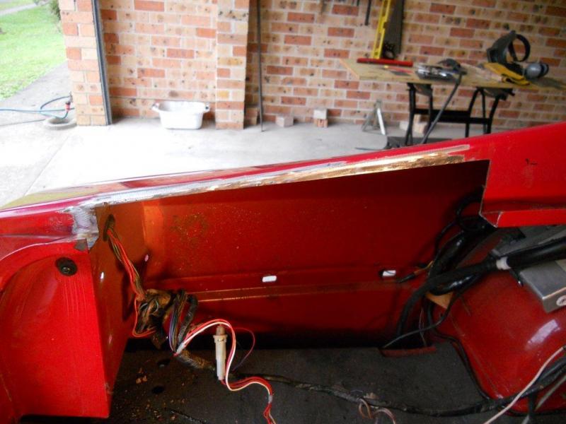

RUST RUST RUST
I bought a RUST free car, as you can see from the pics the rust was hidden until I started pulling things off.
Be very critical with your viewing and poke at every part with a pointer.

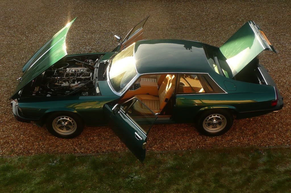

Nice to see that it's previous owners have refrained from making styling 'improvements' to the car.
It sits on it's original ( and charmingly 70's) 15" GKN 'Kent' alloy wheels. It has also kept it's original back ( and hopefully front ) rubber bumpers . The interior also hasn't been messed with. No retro wood inside which is exactly as Jaguar intended.
Apparently the cars biggest potential market ( North America ) insisted that their customers would be put off by the lack of shiny wood in a Jaguar - so in 1981 Jaguar capitulated to boost flagging sales and many early Pre HE cars have been er -- 'updated'
You are likely to encounter rust issues with most XJS's so they will nearly all need careful examination.
The 1976 car is what's known as a PRE HE ( pre 1981 HE engine ) and are an aquired taste. I was very tempted by this one which sold quite quickly late last year at around the £ 8000 mark.
