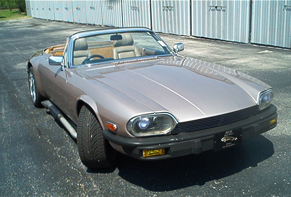

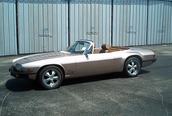

some pix of my XJS roadster, modded V12 ,hi-comp pistons, Crane race cams, heads flowed and ported, intake manifolds EXTRUDE honed aka larger, port matched, chambers Swain coated ,SS oversize valves.
standalone EMS, oversize injectors,custom fuel rails, and lines Aeroquip, 6mm oversize TBs, duall K&N air filts.
plus some look pretty bling stuff on engine.
exhaust manifolds Extruded, coated and matched, 2 1/4 down pipes, all flowing into glass pacs, 5" outlet on drivers side,RHD. 6 is nice BUT the sound of 12 cyl. is awesome, YUP! you can hear it.LOL
700R4 transmission 4spd with 4th overdrive, built with upgraded parts, 10" convertor HD, Aluminum drivshaft one piece, diff. ratio 3.73, hi bias LSD.
brakes upgrade, aluminum calipers, SS lines,drilled and champherd rotors, HAWK pads, new shocks all around,KONI.
slightly lowered,(not enough tho).
new wood dash, Motolita str. wheel, RECARO leather seats, redo full interior.
body reinforcments, and a cross bulked behind seat.
Wheels ENKI 18-9 front ,, 18-10 rear, had to widen the rear body,flares.
tires 275-35-18 frt., rear 300-35-18.
YES it was a coupe, but it aint no more, get out the sawsall and get at it.
custom fuel cell and system, pump, FPR, & filter SX.
Well i must have been ahead of the curve, this all took place in 1994-1996.

well, i do have a 2hr, video of the complete restoration and modifications, that goes with the car when its sold!
compression ratio 10-1 factory pistons, bought new as a kit,from overstock, balanced to original 9-1 pistons. Euro spec.
Camshafts Crane regrind to 300* duration , .395 lift at valve, (a little to radical for my tastes), a lot of work to put stock back in,if you are familier with doing Jag cyl. heads,PROPERLY!!
thet idle like a top fuel dragster, clackity,clackity, clackity.
but they run out 6500-7000rpm easy, torque peak up around 4500rpm, thats just to high for a street car. IMO.
for lightening any factory car, you start at the begining, you completely strip the car down to a bare unit body structure, a bare platform and shell, nothing left in vehicle.
no engine or transmission, no front subframes or rear cages, put them aside for future tho.
no doors ,trunk lid , hood , all glass, no interior at all, all dash ,a/c,heater,ducts ,yeah just everything, including wireing, and all the dreaded LUCAS stuff.
then you start the cleaning of all tar , body fillers, anything thaat is not body metal.
i sandblasted my entire car body spending time in RUST suspect areas.
today they media blast things.
after blasting,then the real rust shows up, it was scary, but like anything i do,i do my best.
then you cut open any rust joints, like seam welds, drill em out,cut em out, just get all oxidation out, use good metal and weld evrything back together, open any closed box sections and clean and inspect.
i then sprayed the entire body inside and out with a rust proofing EPOXY paint.
do all necissary body work, a lot of time spent on this process, take your time and do it correctly, and multible coats of epoxy primer.
i added my reinforcments at this time, a sheet metal bulked behind seat ,welded half way up the door posts, then using 1" sq. tubing reinforced the area where the rear seat was.
finally a good Base coat/Clear coat paint system, paint is a custom Kolor but called
PINK CHAMPAGNE SILVER.
then came the lightening process, strip all subframes and cages, blast them clean and cut all the places you can Plasma cut holes(without weakening the piece).
my trans is 4spd but 30lbs lighter than 3spd 400. a lite weight 10" convertor another 15lbs. cut holes in flexplate rebalance,( engine response is encredible).
removed all Lucas stuff from engine,starter, alternator, P/S pump, A/C pump, i happened across a P/S pump from a Viper, weighed it,only 3.5 lbs, compared to Jag pump at 15lbs.
all those pieces were much lighter, my starter is from a Ford 4cyl. but cranks that 12 no problem.
Brakes , stock rotors frt&rer cross drilled, if you want to save some serious wt, just wegh the front castiron calipers 14lbs, i used Wildwood aluminum 4piston, with Hawk pads, weighs only 4lbs each, and that unsprung weight.
fuel tank replace with light weight plastic 20gal. cell, all fuel lines aluminum,full length.
cut the roof off, weghed 60lbs, quarter glass 5lbs each.
A/c condenser and hoses 20lbs.
bumpers, removed the impact struts(they heavy), used simple exhaust tubing welded in place of. all 4 saved 20lbs.
exhaust system, id guess saved 70lbs, i use a side exhaust. no cats.
still got the heater in there tho.
seat are lighter also,around 7-10lbs each, no rear seats,just carpet.
FYI it still has the UK glove box sticker saying it is a 2 passenger vehicle, certified.
it was converted from a coupe to XJSC, in England, 1979-1980, i did the Roadster conversion.
also of interest, a real roadster has no top, only a snapon torneau cover,with zipper,COOL.
a car with a folding top is said to be a convertible, or soft top.
iv often thought about a removible CARSON top, padded in and out,COOL again!
but thats a project for another day.
wheels ENKEI about same wt. as originals.
OK i most likly forgot some thing,may remember later, i'll post if i do!
THX for your interest, YES runs great, faster than stock,
RON
