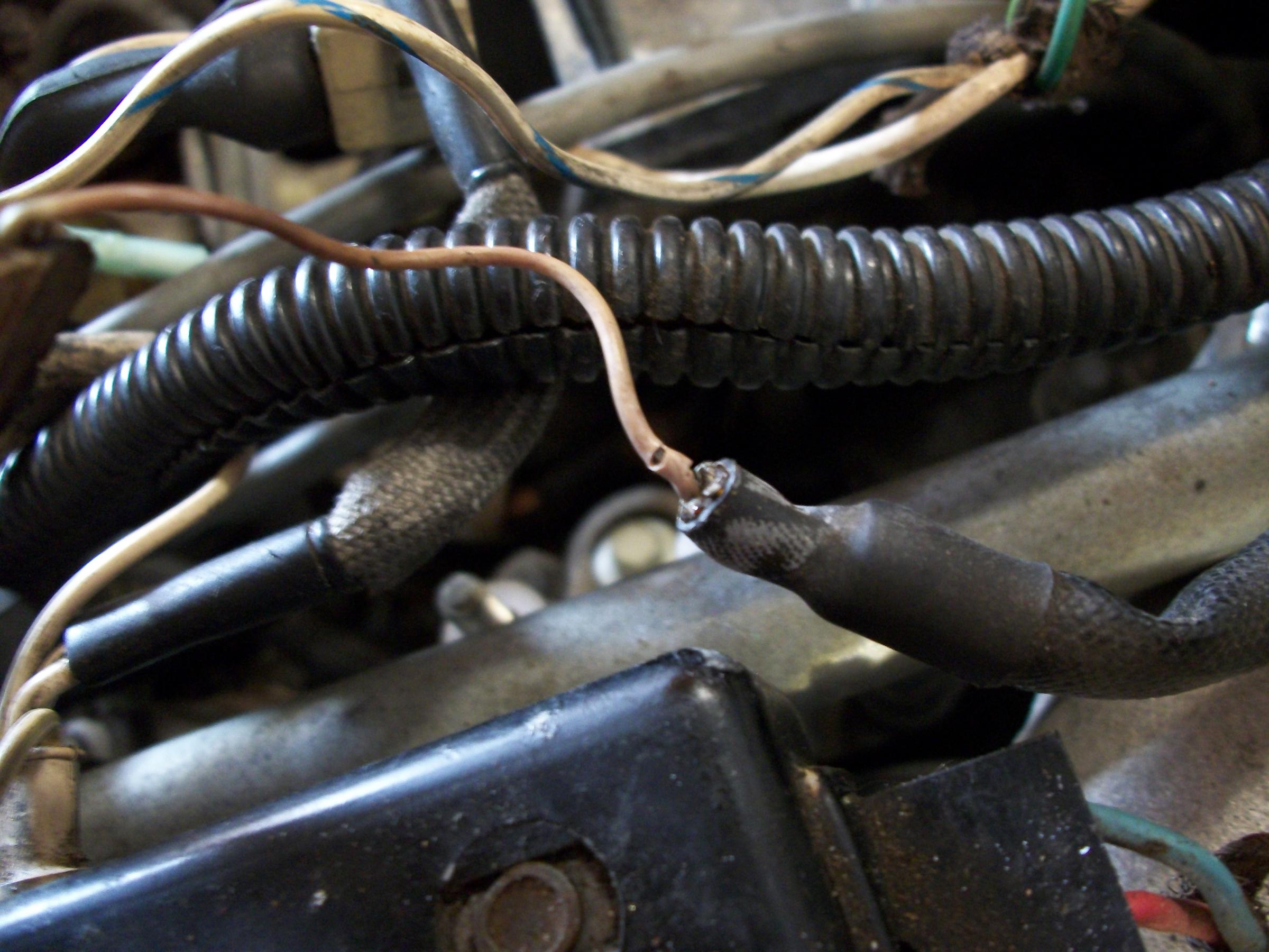

I am going to try a post a photo, wish me luck. I was reading this post, and saw Greg's response about the ignition amplifier wire colors. Got me thinking because I changed mine, and have what I would have sworn was a plug wire arcing around that area. I looked this afternoon and found this (see picture). How do I properly fix it. Thanks to Greg for mentioning wire colors and shielding. Not sure about the photo, not a computer guy.

yes picture came through.Now is this the wire going to tach wire on amp,or wire(coax) from ecu?I hooked my coax wire to the female bullet wire rh side of 4 wire group looking above from drv side.wht with slate tracer.when i turn key on i have 12.6 v to that wire.the far lft wire (male bullet)also white with slate tracer i hooked to tach.with key on it has aprox 6v.with key on i have 12v going to both sides of coil.im hopen thats right.i can only post pics to my garage for some reason.ill post a pic there.there are a few wire connectors loose under hood ill post some pics on my garage.and hopefully someone might,reconize where they go.i know both of my micro switches at throttle are not hooke up.

I have not checked any voltages at this point. I pulled the "V" apart Sunday morning, and was getting ready for plugs, wires, cap and rotor. This find was by accident and-- with your guys help, for sure. It is the far right wire. It comes out of the amplifier with a grey stripe, and goes into shielded heavy coax looking wire, kinda beige colored before it gets to the coax area. The far left has a grey stripe and is hooked up to the white with blue streaking going to the tach. Other two coil wires are easy. Can I heat shrink just that area, or is it more involved. The last guy wrapped it with what looked like white medical tape.
Thanks
