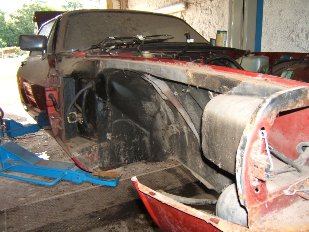

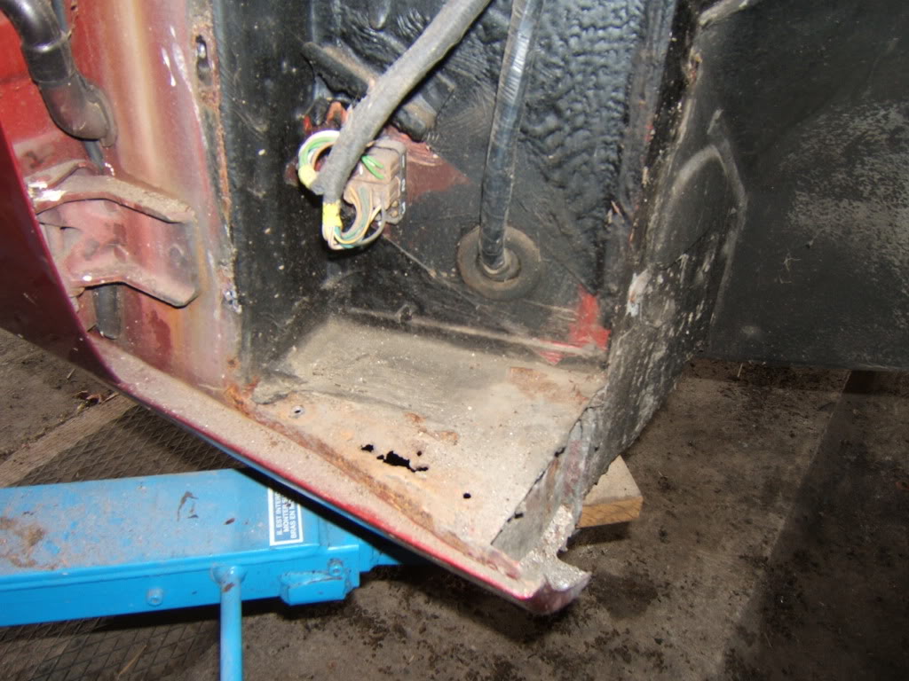

Here are a couple of pics of the wheelwell that Grant and I are talking about. There are wires from the two bulkhead plugs, and there is a solid unplugged bundle of wire which is the unbroken connection to the ECU that goes all the way through the car to the ECU plug. (pics taken before I welded the sill I hasten to add!).
The problem you have can be in any of the three bundles, but my best bet is the solid bundle, but I suggest you carefully unwrap all of them and redo the wires in them to where-ever they go. Big-ish job, but worth it, and not costing much. Start with the ECU bundle, I suggest, and try the car after that is done, first.

JG, you said a couple of post up:
"Ok, It is odd,that car was running ok,untill I started taping up wires,between the inj loom and power resiter.After that,car wouldnt start.I'm going to start un taping all that loom today,and see what happens."
I think this says it all. Renew the ECU loom as suggested by splicing into it from the wheelwell forwards. You have a problem and there is not, repeat not the one-step solution you would love to find. Some wire, some shrink stuff, some care, a couple of days, and this part of the problem is eliminated. Keep taking the medicine !

So is there a bulkhead loom connector you mentioned somewhere?
Is it behind that fender well?

Originally Posted by jagernut
Yes,you are right about the loom.I need to rebuild it.
The bulkhead loom connectors are in the first pic I posted, quite clear to see. You will have to remove the inner wheel arch to the rear of the front wheel to access them - easy to do. Then you leave a decent bit coming out of the connectors and can splice new wires to the each (following the method I suggest below; but I am not loommaking expert, so others may have much better views on how to do it. .
The ECU loom (also in the pic but shown going through the huge bulkhead grommet) has NO connectors at all for the entire length of the car. So to repair the engine bay part of it, I suggest you undo a bit of the covering in the part behind the wheelarch inner you have removed to get access, carefully unwrap it into the engine bay to where the connectors are, and ONE WIRE AT A TIME splice in and replace all the engine bay portion.
You might start at the wires coming from the Resistor pack and the ones you moved while taping up, looking at the starter relay etc, and work back to the wheelwell, as these seem to be the iffy-est. But really no substitute for doing them all !
