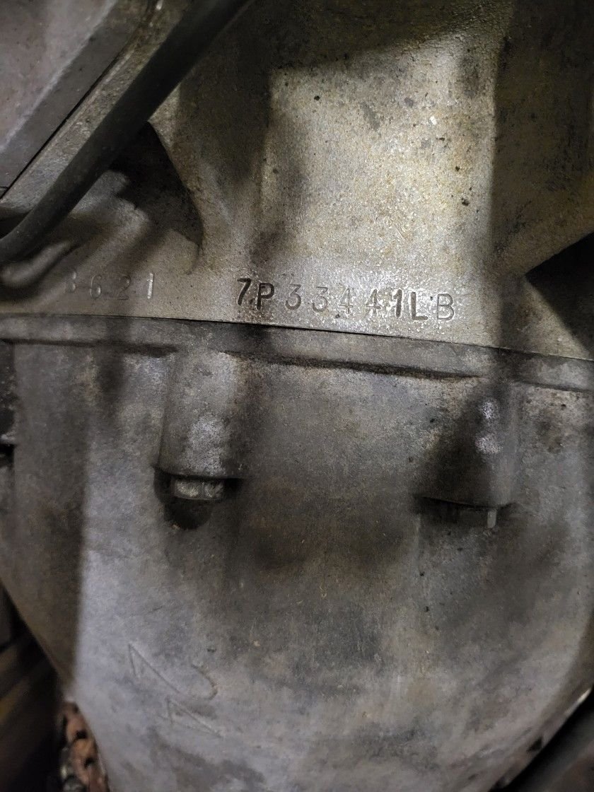

Thanks Paul.
The second engine I have has the numbers I quoted. Is it possible to work out what the engine is?
I include here a photo of its engine numbers.

Thanks Paul.

I think that's a low compression engine out of an early Series 3 XJ12 saloon.

Can anybody decode the number, there must be records of engine numbers somewhere although I did try Sean Straws decoder without success?
