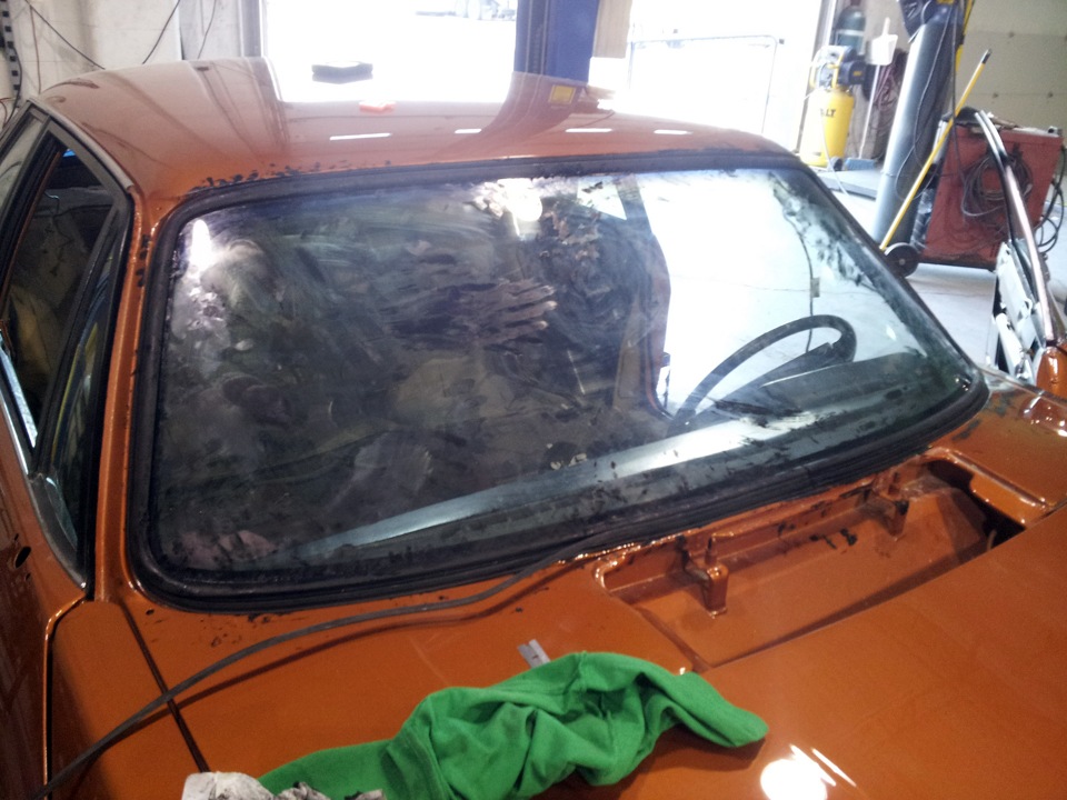

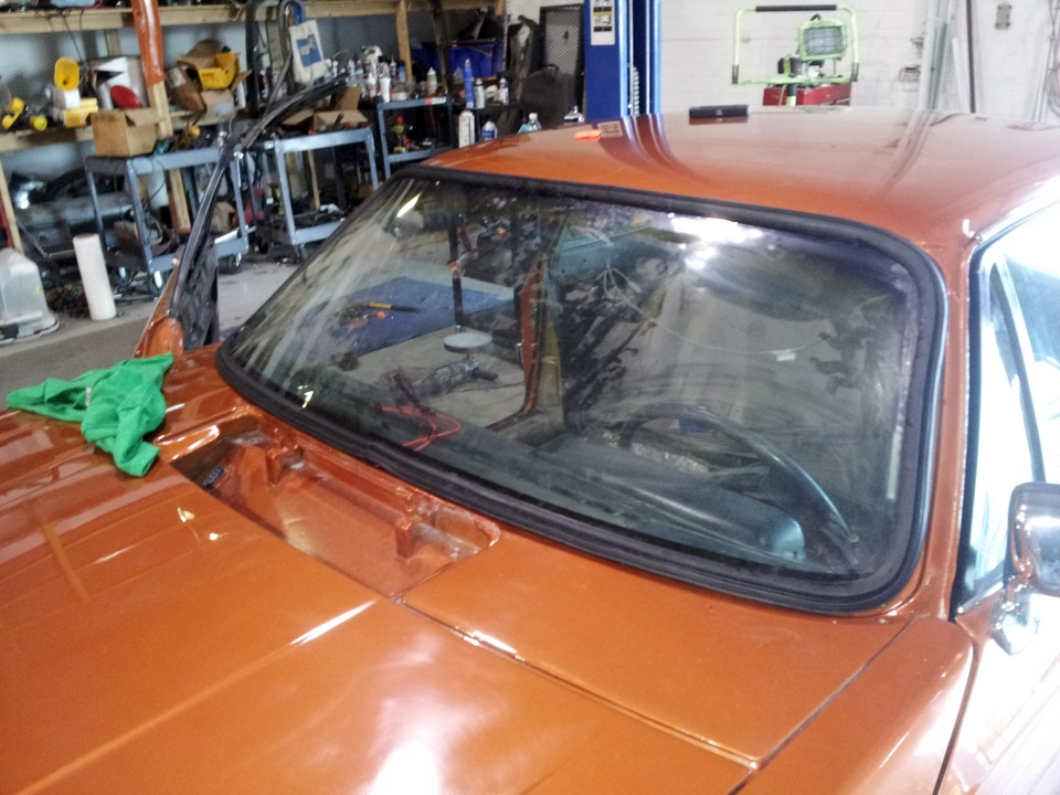

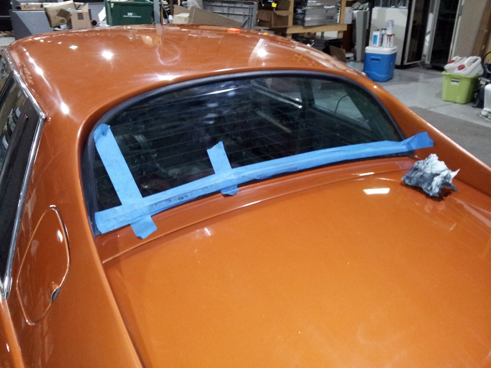

I just did both front and the back and while rear glass was walk in the park, front raped me properly.
Lock strip can usually be reused, rear does not need any lock.
I also used 3M windshield glue, which mare my life a lot harder. I also has black hands for nearly a week. Without gluing these rubbers in, there will be leaks.
Process is standard, rope (thick electric wire in my case), being pulled all around seal to sit the rubber.
Front rubber is always too large, to it need to be cut in the dead bottom center and then sealed together with some black glue.
Some pics...
