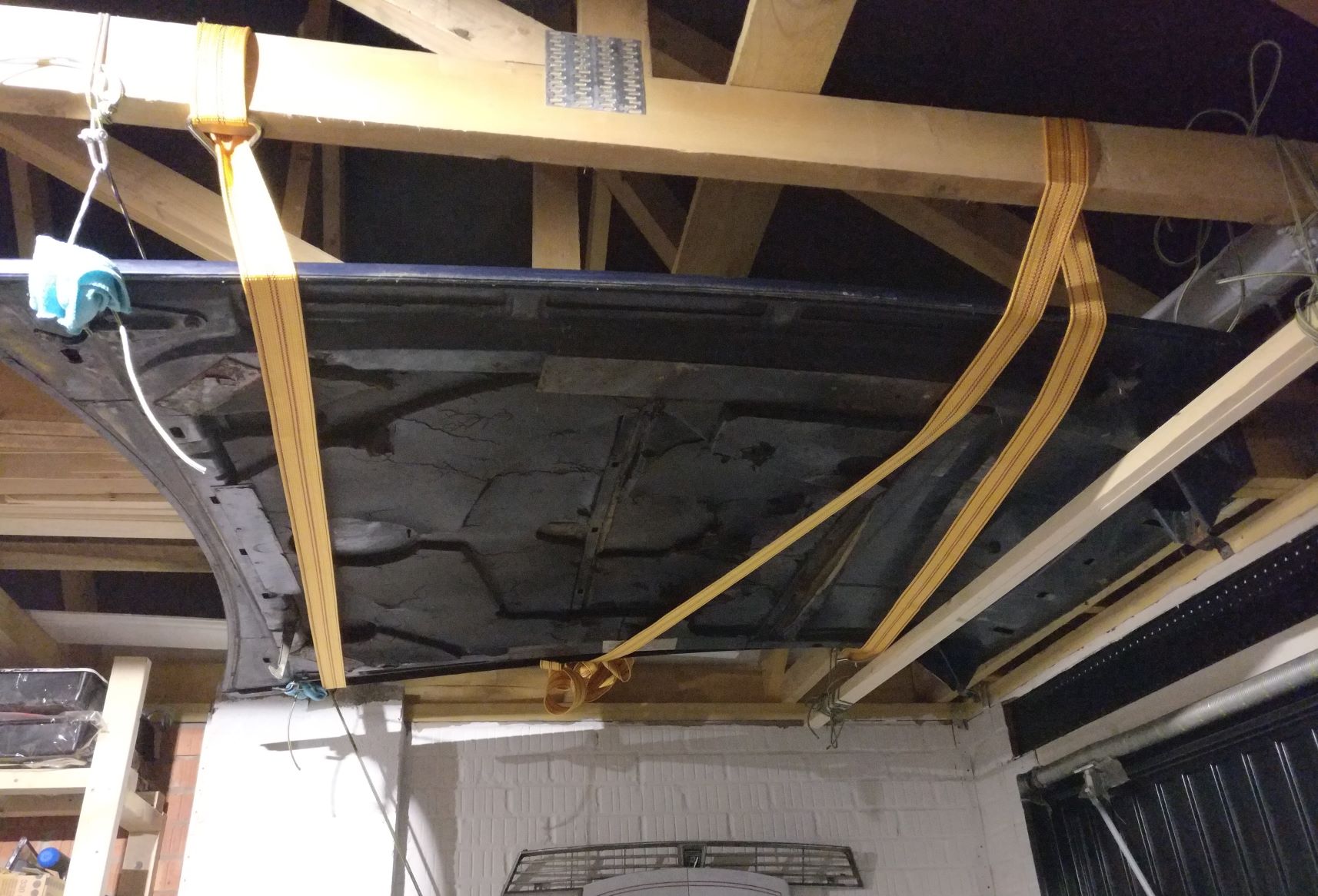

The bonnet is out of the way (see photo - lessons learned, don't use rope that stretches or one side will be lower than the other & use pulleys rather than d rings, but the bonnet is now out the way and secure).

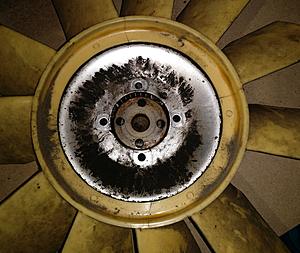

I'm in two minds about the fan - long term plan is to switch to electric, but at the moment I don't know that the car / engine is good. I might see if I have space to do what I need to with the stock fan in place, if not, remove it and make a decision on switching to electric fans before I put the car on the road?

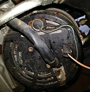

So the radiator is now out everything came out as described (useful to know what Im looking for so thank you for the description).
The threaded ATF connections were a pain because there seemed to be no space and I was worried about breaking the connections on the radiator, but they came off in the end with a crows foot extension bar contraption. I did struggle to get the bottom hose attachment on the radiator up past the small fan shroud and ended up undoing the shroud at the bottom as well to move it further back.
The coolant looked terrible, sludge / muck and all, but hopefully it flushes ok. A bit of a wake up in the few weeks since I started on the car, everything has been in good shape but just dirty. But I suppose water and rubber were always going to suffer most from the long layup. Good news is all the metal around the radiator / engine bay looks good.
Water hoses are ordered, so while I wait for these, I need to get on with cleaning everything up. So, todays list of questions (thank you and sorry, getting further out of my comfort zone each day!):

Not much progress this week as work is busy and the garage is cold.
I've tried to take the fan out tonight - the belt is loosened and the four nuts are undone all the way to the back of the fan, but I'm not getting any movement on the fan away from the pulley. Am I missing anything, or is it just metal to metal contact which has stuck together? I thought about getting a hammer, which is usually a good time to stop for the night - I've left it soaking in penetrating oil and will see what it is like tomorrow.
Thanks,
Richard

So, there has been some mission creep!
The plan was to do plugs, check the engine turns by hand, address fuel and start the car, coming back to everything else once the car can be moved in and out of the garage. Then a water hose was leaking, so it made sense to do hoses and belts now.
So far:
> Belts and hoses are out and new ones ordered.
> The fan wouldn't separate from the pulley so I took the pulley out with the fan attached and separated them on the bench. I think the fan is cracked (see photo - before I get rid of it, those are cracks at 12, 3 and 6 aren't they?). Rather than buying a new fan and belt to be changed later, I think I'm going to do the electric fan now - need to think about how to trigger it (with the small fan, or choose one of the other options?).
> Front half of engine bay cleaned and rad support beam rust treated, need to paint this so the radiator can go back in once flushed.
> The engine turns by hand! Huge relief.
A couple of questions I was hoping for some help with:
1. Is this alternator connected properly? I've read a post from Doug where he said the exciter and load dump go to the same terminal, and a second load dump goes to ground. There's an old inspection report in the history file which said it wasn't charging, so I thought I'd ask.
2. Does anyone know the part number for the small vacuum pipe coming off the chrome pipe just above the left thermostat - it seems to fall between the diagrams I can find on JCP?
Many thanks,
Richard
