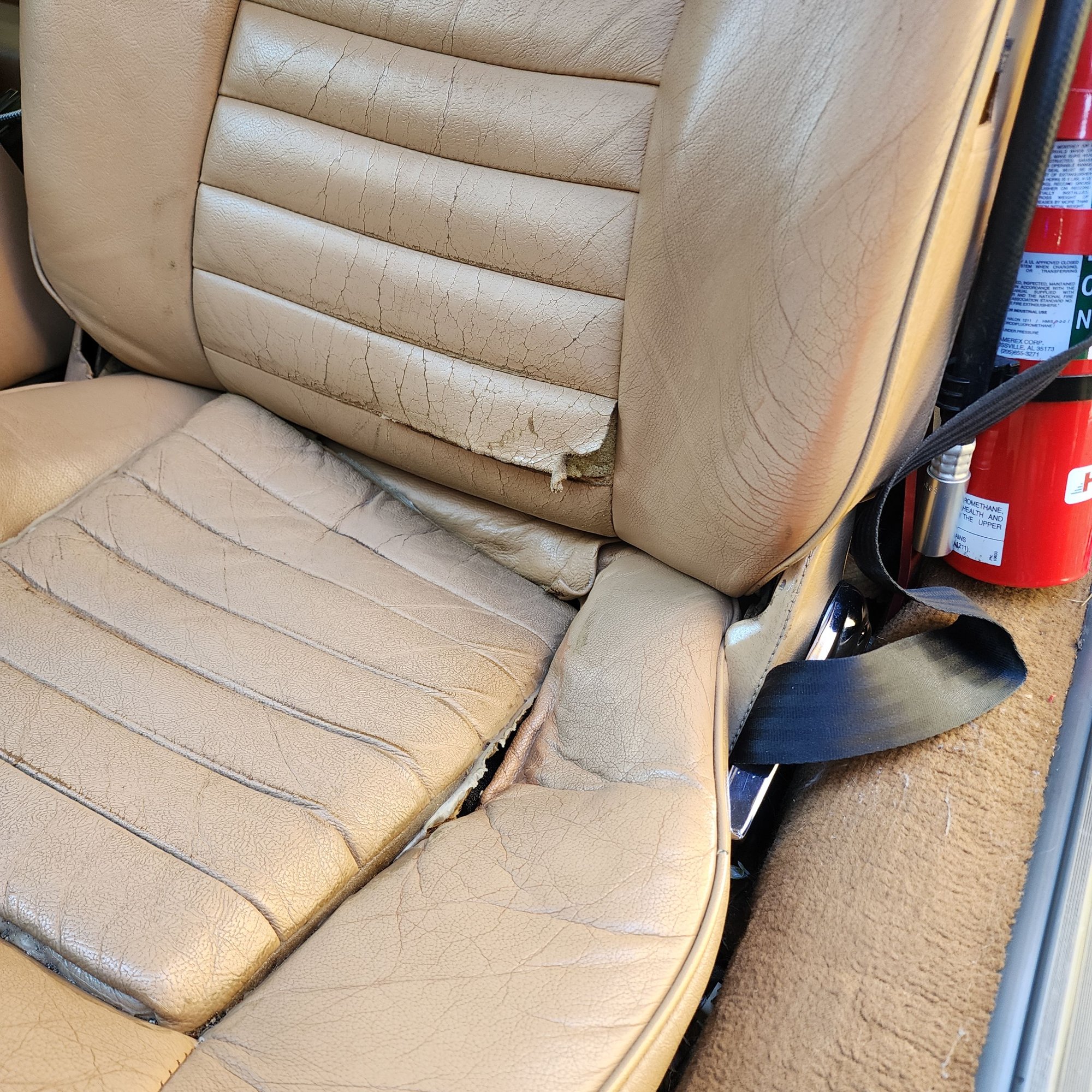

My preference would be to replace the entire left front seat assembly, but I can't find one.
However, I see some 1988 seats, but they appear to have a seat belt that is attached to the seat frame, not to the vehicle frame. I could likely work around this, but I wonder if there may be other differences.
Thanks,
John
1987 XJ-S V12
70,000 miles

Looking carefully at the photo posted by the OP, I think that the belt is bolted to the sill. Even if not, I would be amazed if he does not find a seat belt attachment point under the carpet on the sill. The belt runs under the recline-adjuster handle up from the sill.
I think that the seat is not the later "Recaro" style one with the narrower type of seat and runners.
