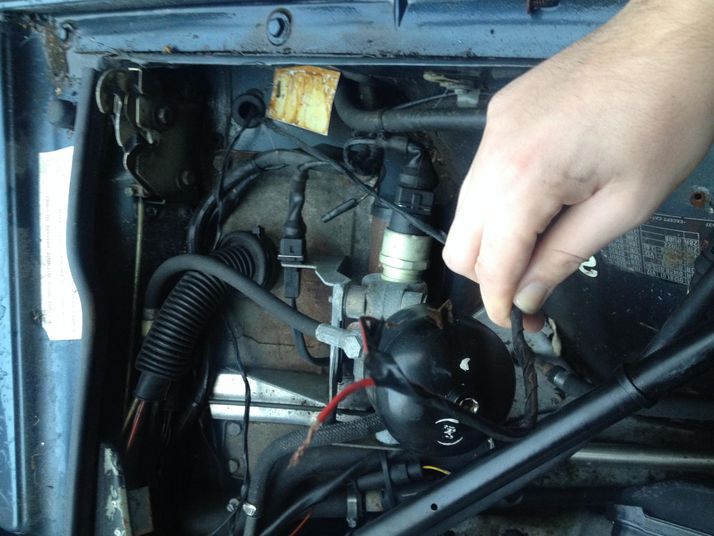

Dave2254's Avatar
Posts: 82
From: Bournemouth
Hi again and thanks for all your help.
I have found some wires that have been cut (see pic) i wired the horn to them but still nothing so wether its the relay or mabye the actual horn its self? Any ideas thanks again
Old Oct 20, 2014 | 11:56 AM
sidescrollin's Avatar
Joined: Jul 2010
Posts: 2,459
Likes: 695
From: Key West, FL
thats probably it....wtf is with the previous asshat that owned your car? I am so tired of hearing about how terrible the electrical systems are in british cars, but people do this stuff to them.
On that same fender, there is a fuse panel and a set of relays attached to it. The horn relay is the second from the front.
Is the relay in place? Is there anything wired to it?

Old Oct 23, 2014 | 04:00 PM
Dave2254's Avatar
Posts: 82
From: Bournemouth
Hi thanks for the reply :-) just to confirm the bolt in the attached pic is wat i need to adjust?
Old Oct 23, 2014 | 09:42 PM
Joined: Jul 2010
Posts: 2,459
Likes: 695
From: Key West, FL
yes.
