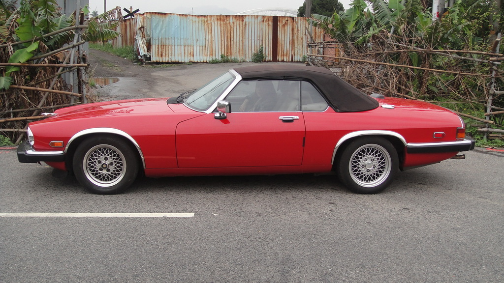

So, after a long search, a lot of soul scratching, and the help of some very helpful forum members, we finally decided on a 1989 V12 Convertible.
Looking good from some distance, getting a bit worse if you get closer, quite a mess here and there once you get too close (but that is for later).
The V12 was initially holding me back.
Not for its reputation, but as the 5.3 liter cost 2.000 USD in road tax every year, excluding any other costs such as forced insurance …
However, found out that the license can be suspended for a year each time, eliminating most of these costs, pretty helpful for the renovation period.
So, for those who did not read my other thread, here some pictures “from a distance”…

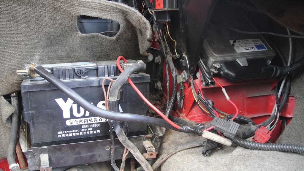

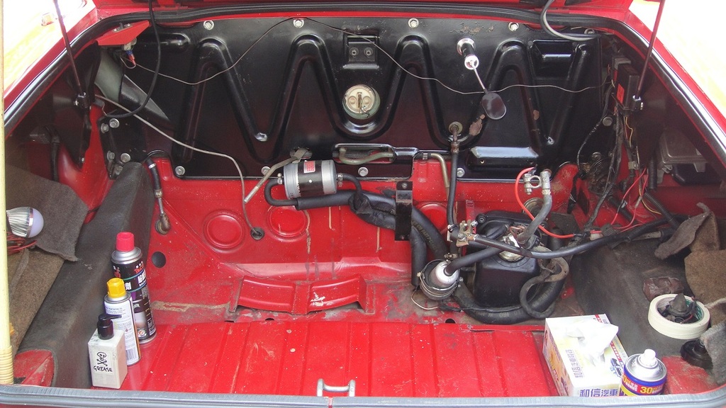

First cleaned out the trunk, so the next action there can be the filter and the catch tank.
It also gives an idea that this car involves more than just a wash.
The carpets are all loose, dirty, and smelly, and there are additional wires everywhere (including power all the way to the front), and I need to figure out what they tried to circumvent before I rip out all.
I will re-carpet the trunk in a later stage, and keep the old ones to be used as templates.

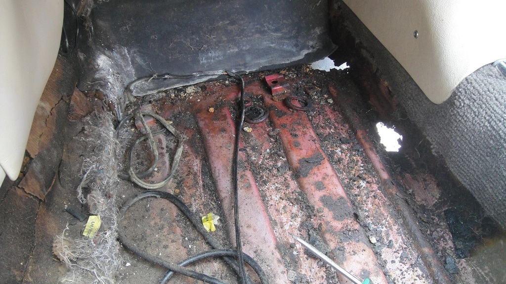

Also tackled the foot wells, and removed some of the carpets.
The driver side seems to be water-caused only, and is basically dry already, waiting for further action.
The passenger side however is covered in an oily, smelly mess.
This is surely not just rainwater, and I remember reading about a leaking condenser (?).
Well, the interior will come out at a later stage, but I will need to work on further damage control for the steel work.
Still, I don’t think the damage to the body is too severe.
