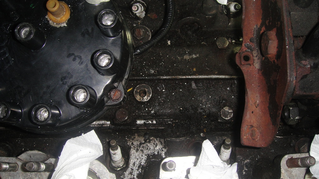

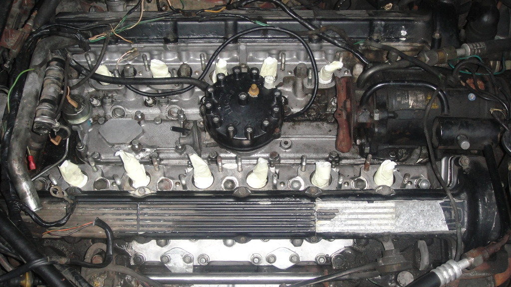

While you guys are having fun discussing classic radios, air compressors, air tools, and what the more (I have serious problems catching up on some threads), my life is limited to a dark basement without windows ...
I guess I have spent some 20 hours by now, cleaning centimeter after centimeter, and finally some results start to show.
Hoping that with an other couple of days of this forced labor, I will get to the make-or-break moment of removing the spark plugs and …

Looking good mate! Just wait until you try to clean the underside

That Eric, is a really really good job. For me, cleaning the V was the worst job by far on my rebuild, and I had the engine out of the car! I can only guess how grim your task has been. Respect from us all. Now, chuck away that stoneage compressor and treat yourself to a nice new Sanden! Makes subsequent plug changes a decent bit easier (not actually easy, mind, but easier).

After seeing that, I am not happy with my V area! That is a must do before I fit my sparkling parts again As said, Eric, I'm competing now!
