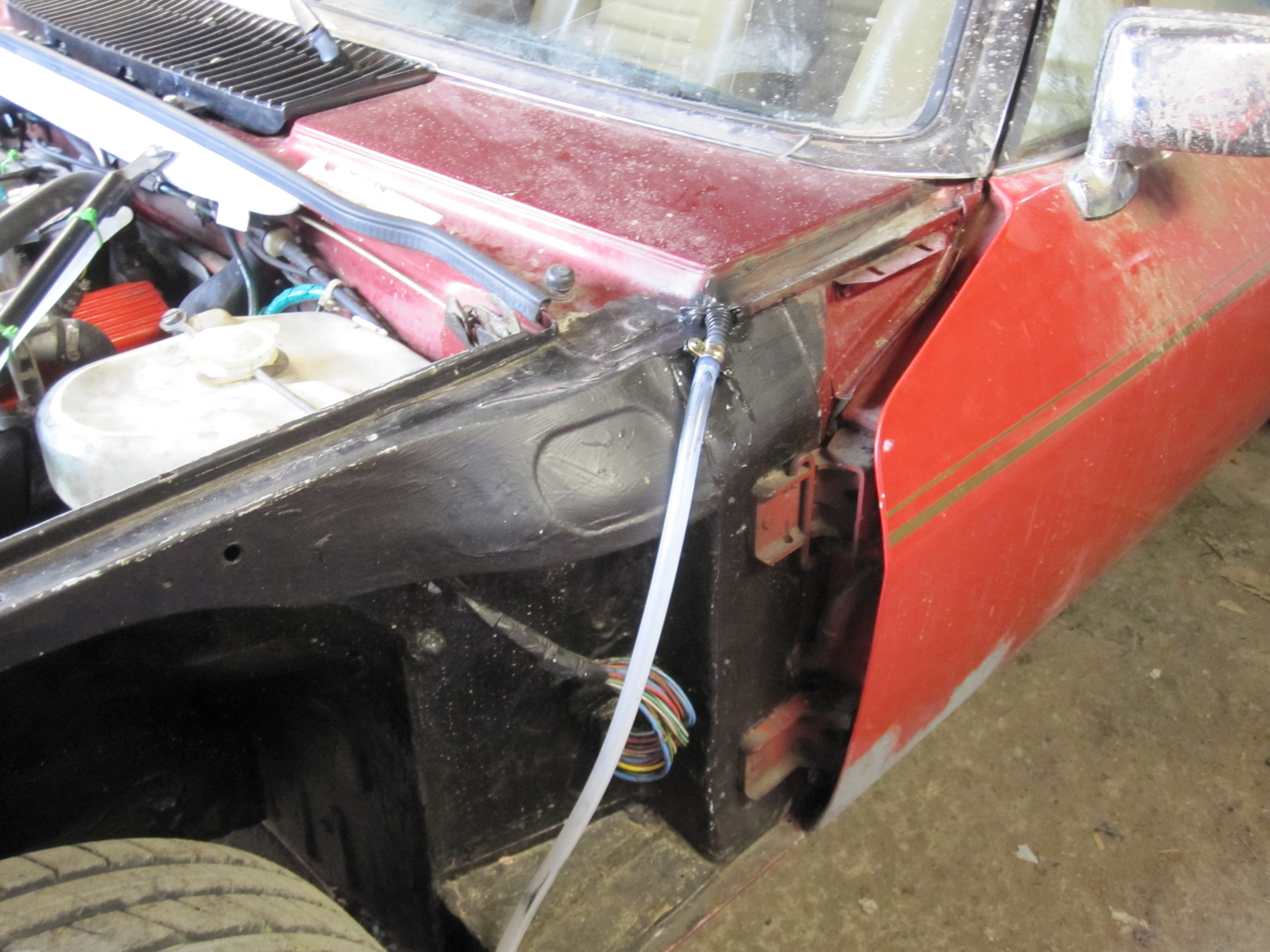

removing the wings is a very good idea if you really want to get to grips with any hidden rust, or to verify that there is not any. The wings are bolt on, BUT they are braised at the front to the lower quarter panel that runs round under the bumper to the lower grille. So if you want to remove them entirely it is more difficult. If you are very careful you can unbolt the wing tops, the hidden bolts just in front of the top door hinges, and the bolts behind the wheelarch (rearmost one) baffle, and the bolts around the bottom of the headlight nacelle, and then ease the wing away to see what's what round the scuttle and as importantly, the sill at the front.
FWIW, I have found that blocking the rooftop/A pillar drain hole at the top with gunk is the best way to protect the A pillar and the scuttle. I have never been soaked entering or leaving the car in 14 years after doing this. Then you can rust protect under the A pillar brightwork, and the scuttle under the wing, and under all the wingtop bolts etc etc. I attach a pic of the GiF scuttle drain system I rigged up, which I think is very important to keep this area dry, as water pools up here and has nowhere to go.
More work for you, if it's any comfort, it does eventually all get done!
