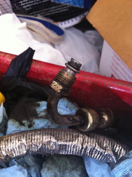

Well that is the part I ordered so that's not the issue. attached is the old hose. If we are talking about the same thing, I don't see what's "removable" about that threaded fitting other than that it slides around. Is there another piece in there? the new hose goes into the hole, its just the new fitting that wont go in to even catch the threads. I visually compared the two and the new one looks to be slightly bigger just eyeballing it. I don't have a caliper measurement tool thingie.
What I meant was the fitting attached to the pump, that the hose screws into, may have somehow come off with the hose....but I see that's not the case.
At this point it simply sounds like the hose is wrong/incorrectly assembled/has the wrong size fitting.
